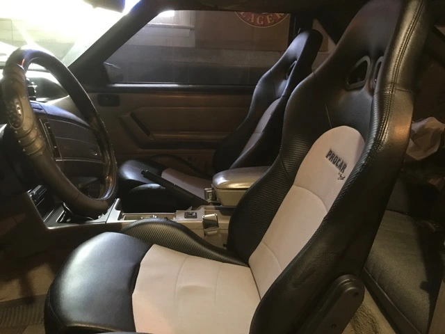

anyone seen the Procar by Scat sportsman seats? really considering them.

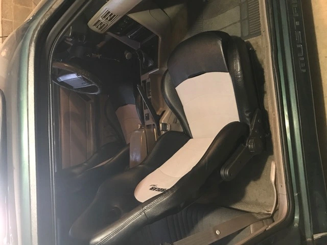

I used a Procar Scat seat for a year. Did not care for it. The comfort was not great,but that was not the main problem. It just never felt ''right'' Tried moving the seat up/down and side to side,never felt natural.
Did a search and found the passenger seat could be swapped to the drivers side. Did that and for the first time in a long time the car felt normal. This will work until i find a set of newer factory seats.
I'm using them. They are very stiff. There is no lumbar, and very little cushion. I'm quite confident that they'll be ass killers on any trip over 100 miles. Additionally, you will need to be able to fabricate mounts to get them to fit your car.
How hard was adapting them to your car?
Got any pics of them in the car?

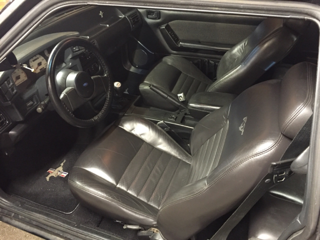

To be honest, I'm not even crazy about Recaro. Friend of mine has a Focus ST and I hate them. I had a 97 GT for about a year and absolutely loved the seats in that thing, though. Comfy! If I ever find some nice black ones down here, they'll definitely go in my foxbody.
I know you said you're getting cheaper seats for the time being, but for what it's worth (when/if you decide to spend more),I love my corbeau lg1's. I have an oddly sensitive lower back and most seats get uncomfortable quickly for me. The stock seats for example, I couldn't stand to be in for more than 30 minutes. The longest trip I've had with the lg1's was 125 miles and my back felt great, very supportive for me.

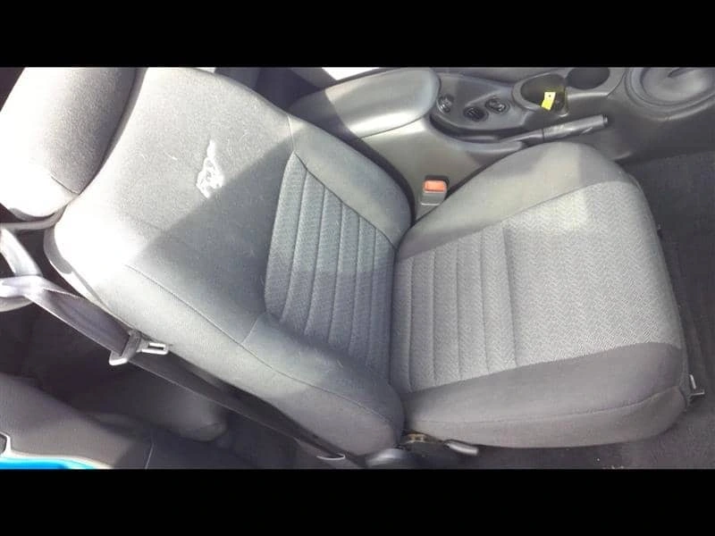

Hello, I have these 2000 mustang seats coming for my 91 fox. I know they will fit, the questions are…. Do I use the fox brackets or the ‘00 brackets ? And if I don’t use the lumbar plug, I’ll be missing out on what exactly with these ‘00 seats ?
You can use either track. They will both bolt into the fox chassis vehicle. Most of the 99-04 driver's seats have a 6-way power track, so if you don't connect power you will lose that adjustability. You can bolt the fox track to the drives seat, but will just need some washers to use as spacers due to the bottom of the seat not being flat
