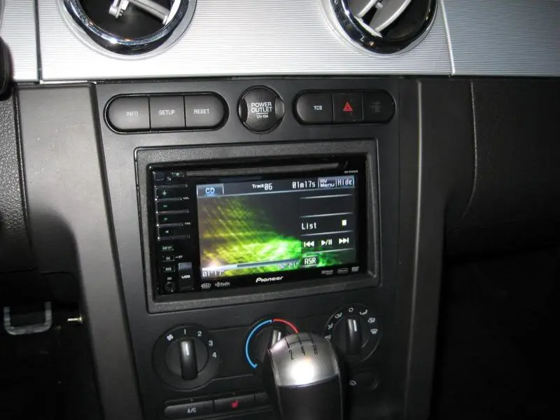

I thought that the factory stereo was actually pretty decent. But it just wasn't enough for me, nor did it have the right features.
So I ended up getting a Pioneer 3100 CD/DVD deck from Amazon for $285. Pretty good price, but unfortunately, it only has 2 sets of pre-outs. Oh well. I went to a local stereo store and got some pricing on replacing the speakers with Kicker 5'x7''s and 8"s for the doors and a 4-channel amp to run them, and a 12" Fosgate sub with box and 2-channel amp.

Pioneer Deck

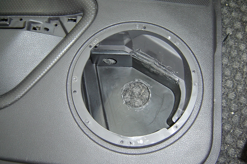

I installed 8" woofers in the door and we had to mod the door panels so they'd fit. We cut the lip off where the two panels join at the top and used a heat gun to make it a little more round and cut off the factory speaker mount. Then they fit with no problem.

Do you have any more pics of your door mod? Also, what kind of 8" did you put in the doors?

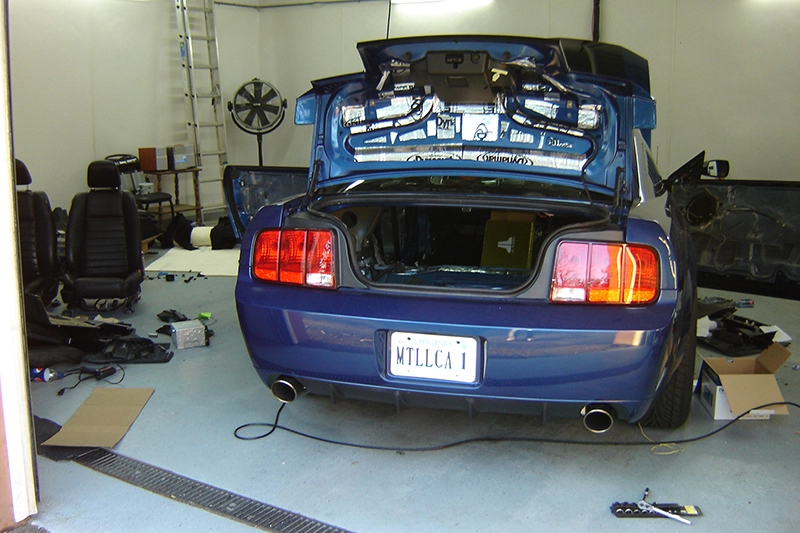

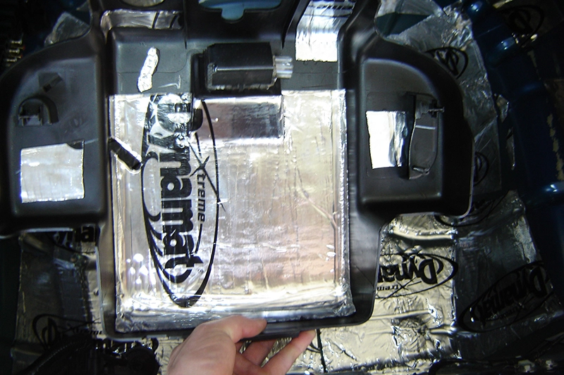

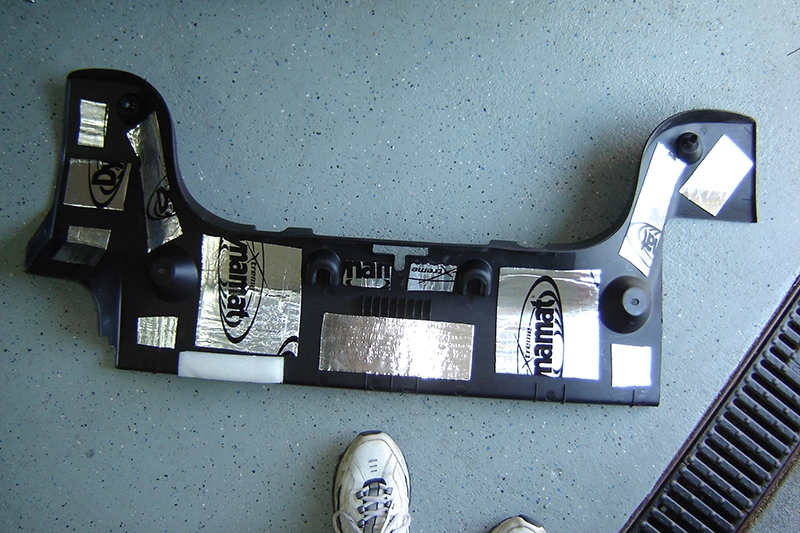

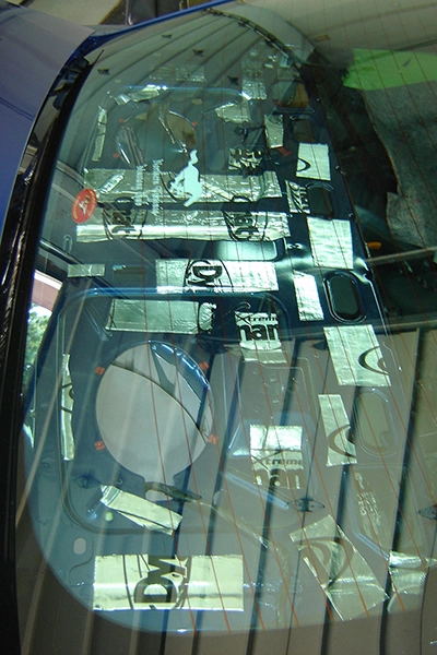

I think you are definetly going to want to dynamat the hell out of your car with the new system. The weak point in the current system is the cabin vibrations more than anything else. I dynamatted my car, without a stereo upgrade, and the sound improvement was amazing.
I used 3 3/4 boxes of Dynamat in mine and it made a huge difference! The stock system and no Dynamat could rattle a little bit and was somewhat loud outside the car with the windows up. After Dynamat and adding a lot more power and better equipment, almost nothing rattles and with the windows up, almost all of the sound is kept inside the car:nice: I got a little carried away with the trunk lid and haven't come up with anything to help cover it up yet...
I didn't take any pics of the inside of the trunk I Dynamatted, but it was fairly well covered from where the back seats are all up in the 1/4 panels, spare tire well, back wall between the tail lights and under the package tray in spots as well.
