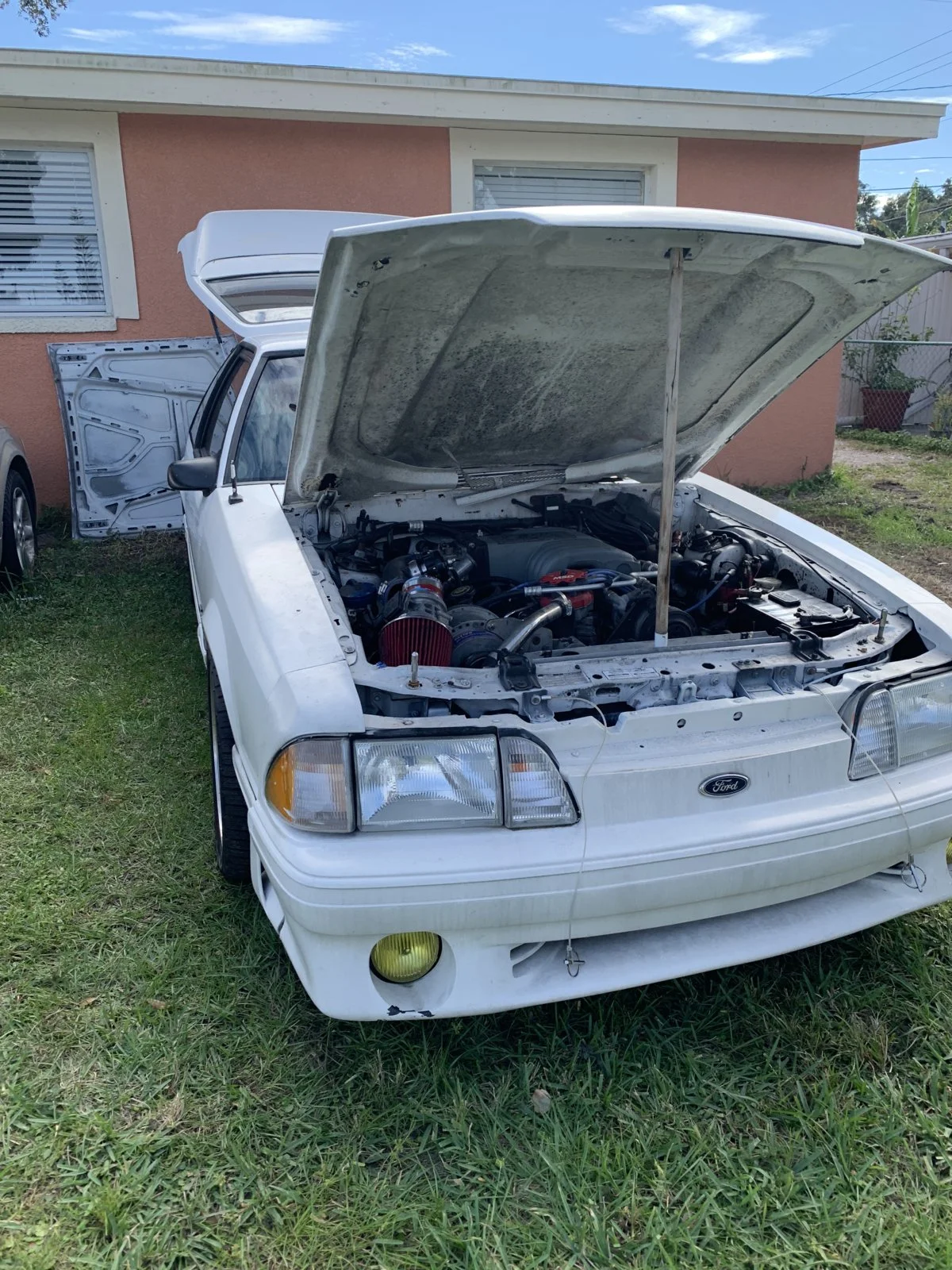

I got a 93 5.0 mustang gt supercharged recently built, forge pistons. Cams from explorer.aerosmith fuel pump, stock injectors. It’s overheating on idle Any ideal of what it may be? Sometimes starts right up with a bit of throttle and sometimes you have to crank for a while and open throttle up some more.. anyone out there think they might know or had similar problem. I have msd distributor with new tif. I think it might need a tune, what you guys think any advice
