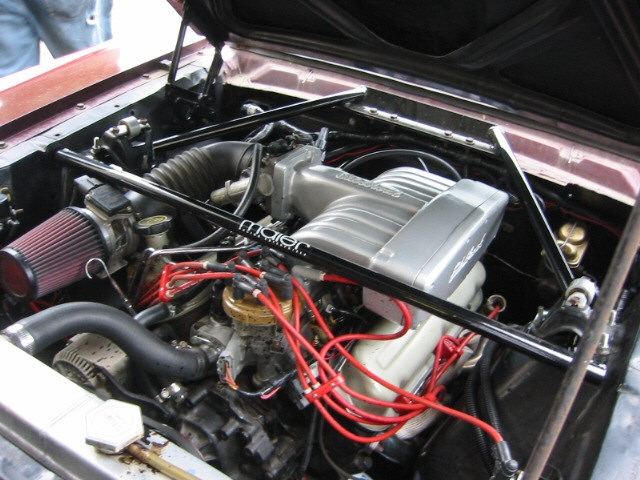

maer racing has an export brace/monte carlo bar to fit the efi intakes. the '96 explorer engine is basically a '93 cobra engine with a different cam. I would use it.
Are you talking about this one? Its pretty cool, but doesn't look as good as the old school type. Also, its almost 250 bucks. I got my one peice export brace and monte carlo bar for about 60 bucks.
http://www.mustangdepot.com/OnLineCatalog/Suspension/mr-exbrc.htm
