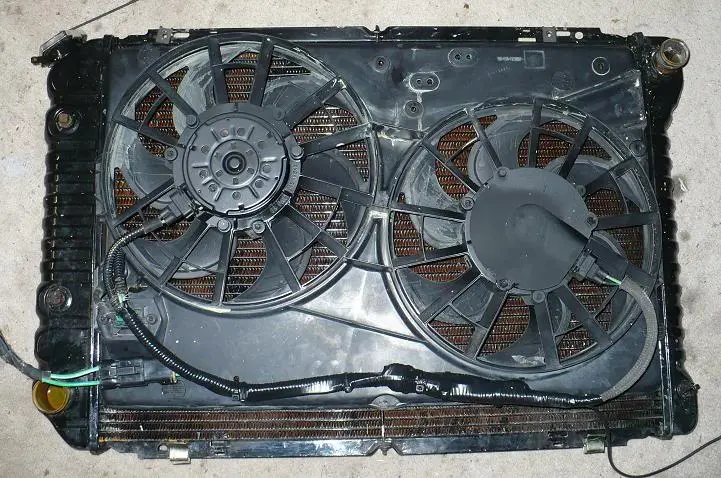

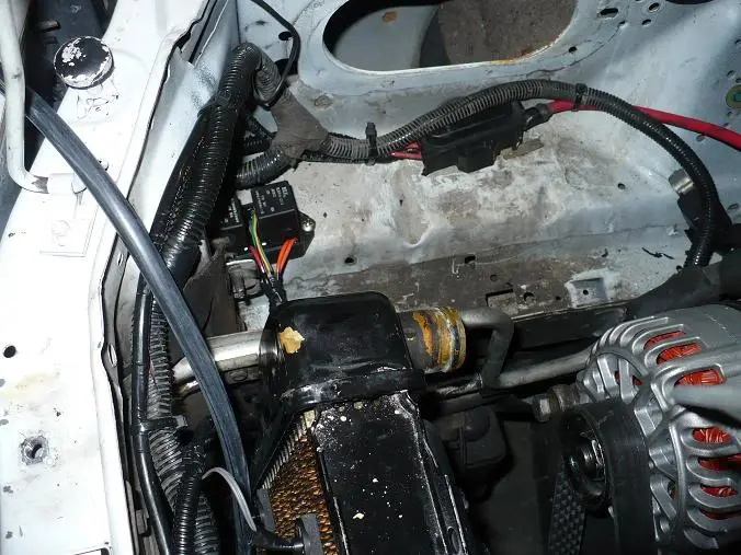

I mounted mine with 2 Hayden part # 210 strap kits. i used some existing holes and drilled a few new ones. I also took vacuum hose and split it down the middle and ran it along the outer edge of the fan so it wouldn't gouge the radiator. I cut off all of the unnecessary wires and rerouted the harness to the bottom of the fans instead of the top where it was from the factory. I wires it up to a Hayden part # 3654 fan controller. It's capable of using both speeds. If you didn't know both fans are 2 speed. I left both fans wired together so they both came on at once. Hope this helps.

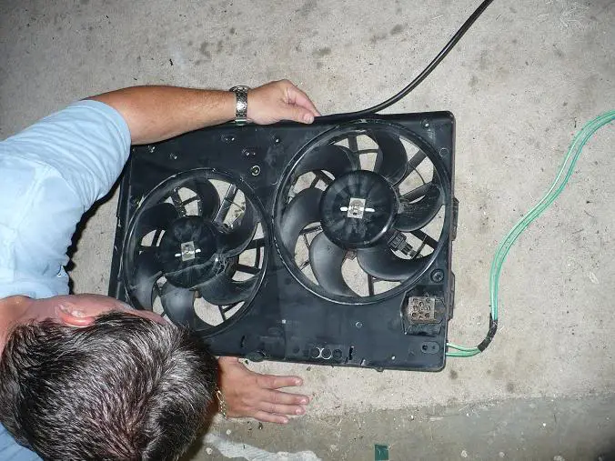

My buddy putting on the vacuum hose
Vacuum hose installed
Fan mounted

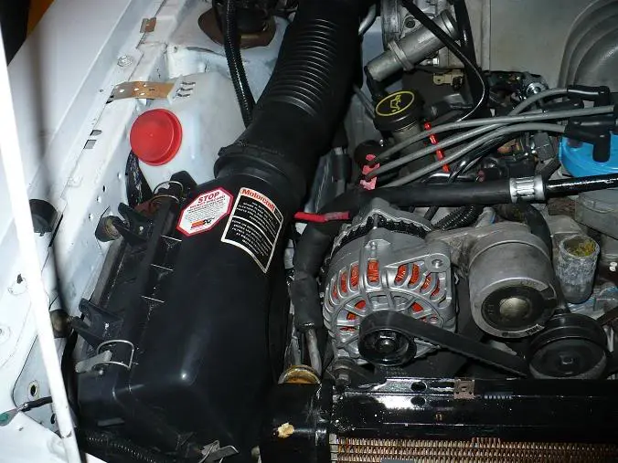

Controller mounted
