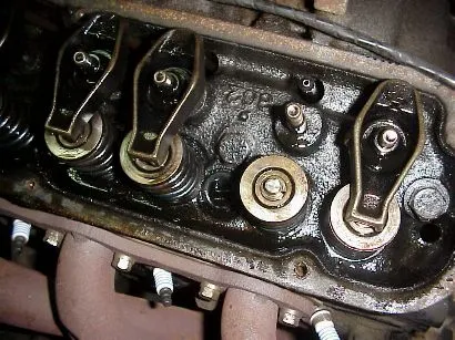

Looking at above picture, Intake is valve on right, exhaust on left?

Thats the slight valve over lap txstang84.

yes, you are correct about valve placement, exh on the left, intake on the right...
