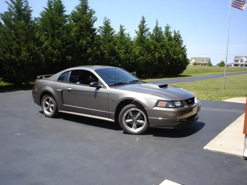

How can I tell if my car has an aftermarket camshaft? Aside from obviously tearing the engine apart?
-the whole story-
I bought an 02 GT and the dealer had no idea what he was selling, told me it was stock but i knew otherwise. So far i have discovered (with help from videos and things here )full magnaflow exhaust & x-pipe, unknown brand short throw shifter and 3.73 gears. I am wondering what else this car has done to it, possibly cam or ecu upgrades but my knownledge of cars runs out at this point.
Thanks in advance - Dave

If it is an 02 then you have TWO cams.
You can pull the passenger side valve cover and may be able to tell. Otherwise you could check for a chip in the PCM and find out who made it. Take it to a tuner and they may be able to get a ballpark figure of what is in it.

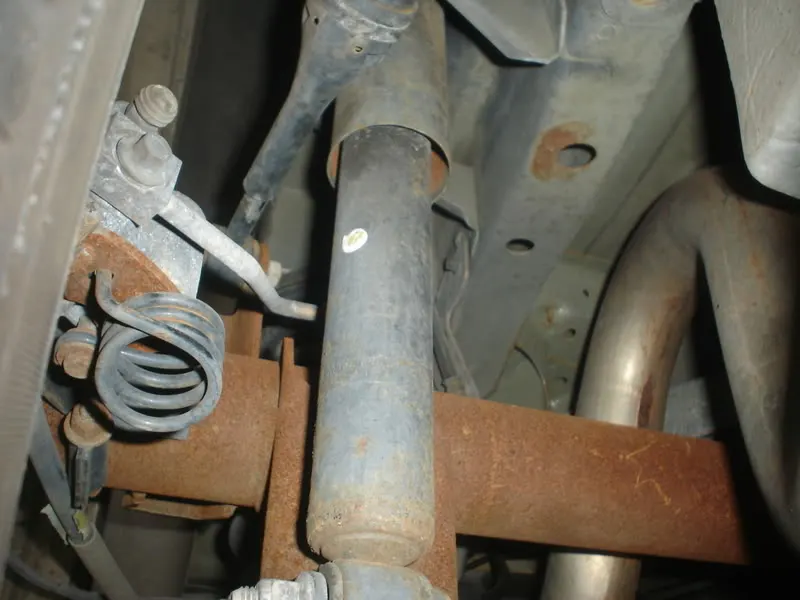

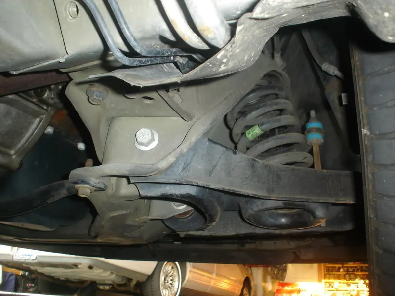

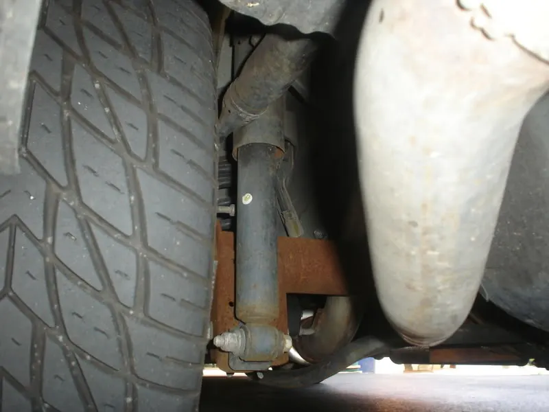

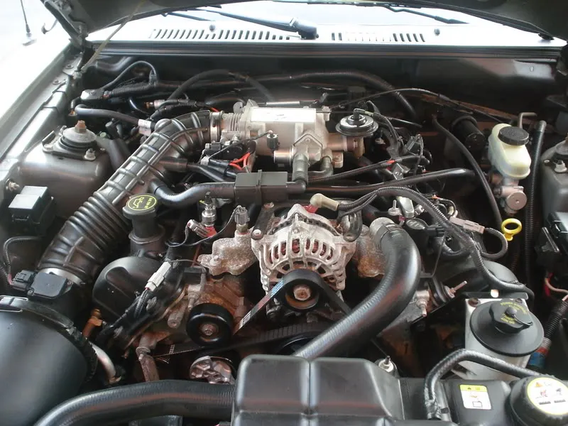

Post pictures of the engine and the suspension...

Check for evidence that the cam covers have been removed...ie - new gaskets, clean, etc...(otherwise, like mine, there's a decent amount of built up crud that quickly tells ya it's never been apart.)

Everything but the belt is stock as far as I can see in the pics.
Your number one priority should be new dampers.

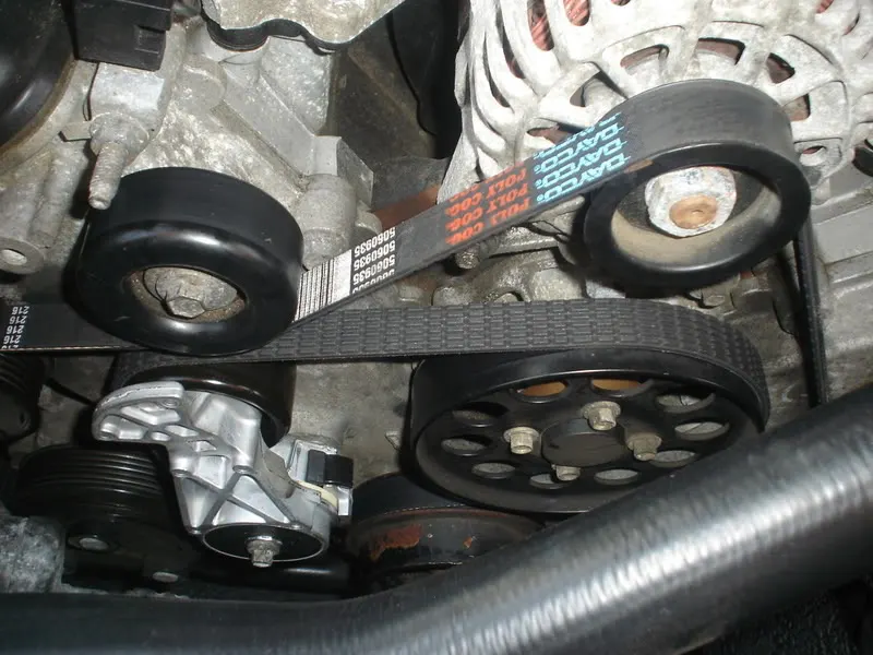

I doubt it has cams, my car sounds lopey but it has stock cams. Post a vid of it at idle and i bet we could tell you. It kinda looks to me like you have an after market automatic belt tensioner too, the stock ones tend to squeak after awhile of aluminum on steel vibrations/rubbing

That is a stock belt tensioner.
IMHO that car is mostly stock, no way would it have cams...
Someone would have to be pretty retarded to do cams before they even did intake, dampers, or catback.

yeah stock suspension for sure, the tensioner and belt are as well, just new.
it does have catback i just neglected to post that picture, everything else looks stock. I don't think it has aftermarket cams but possibly a tune. It has 3.90's. Thanks for the help

Mach grill/lip
