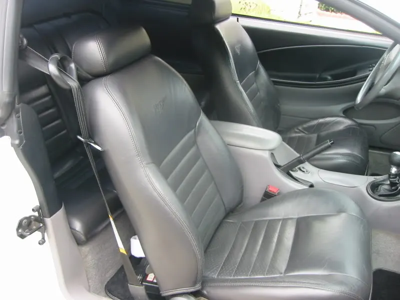

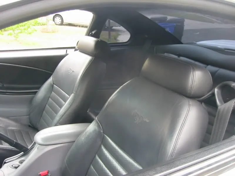

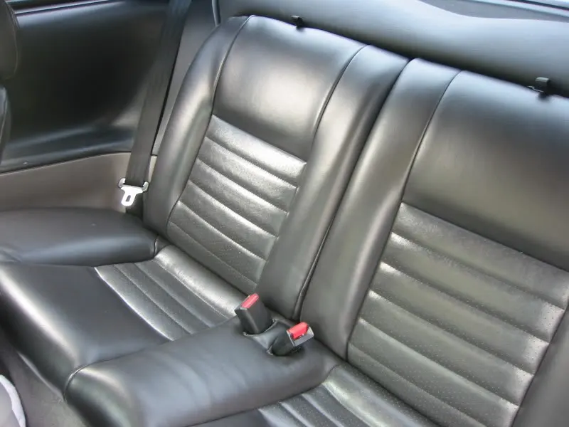

I picked up these babies last weekend and installed them. Leather feels nice. I love that they were a direct bolt in. They are from an 02 GT and the color isnt that far off which makes me happy too. Plus, the drivers has full 6 way power and lumbar!
How comfortable are they compared to your old seats?
I put in '99+ seats, and I hate to say it, but my stock seats seemed more comfortable. Too bad they were cracked to hell and looked like garbage. The new seats do look better; gotta love having the pony on them. :nice:
They are different feeling more firm than my old cloth seats, but then again they have less than half the ass time. I dont quite sink into these like i did my worn out cloth seats. I like being able to use the power seat again.
I never did like the stock seats, but that probably becasue mine were torn to **** and there was a big metal piece sticking out on the left. But I love my summit seats, they are soft on the bottom, and firm on the back. I would have loved some '04 Cobra seats though. :)
I just think the newer seats have less padding or something.
Even the cloth seats in my '01 V6 felt more cushiony than the leather seats in my sister's '01 V6. I don't know. :shrug:
On the topic of leather seats, is there a way to keep the side bolstering on the left of the drivers seat from cracking so quickly from getting in and out of the car?
I always try lean forward when sliding in so I don't put presure on it, but I don't always remember.:bang:
That is already a little worn down on these seats that i bought. I guess ill just try to keep them conditioned and soft as much as i can.
Also for anyone in the future reading this the wireing was pretty easy. The stock seat connector has two wires one positive and one negative the. The new 99+ seats have a four wire connector two negative and two positive. I went to Radio Shack and bought a new two pin connector set. Cut the old stock power wires off and pinned them into one side of the new connector. Then on the 02 seats i wires the two positive together and the two negative together. Then put them into their corresponding pins on the new radio shack connector. Plugged it in and it worked perfectly. :nice:
