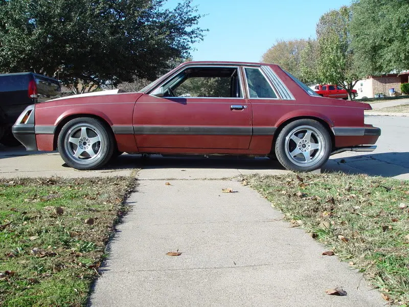

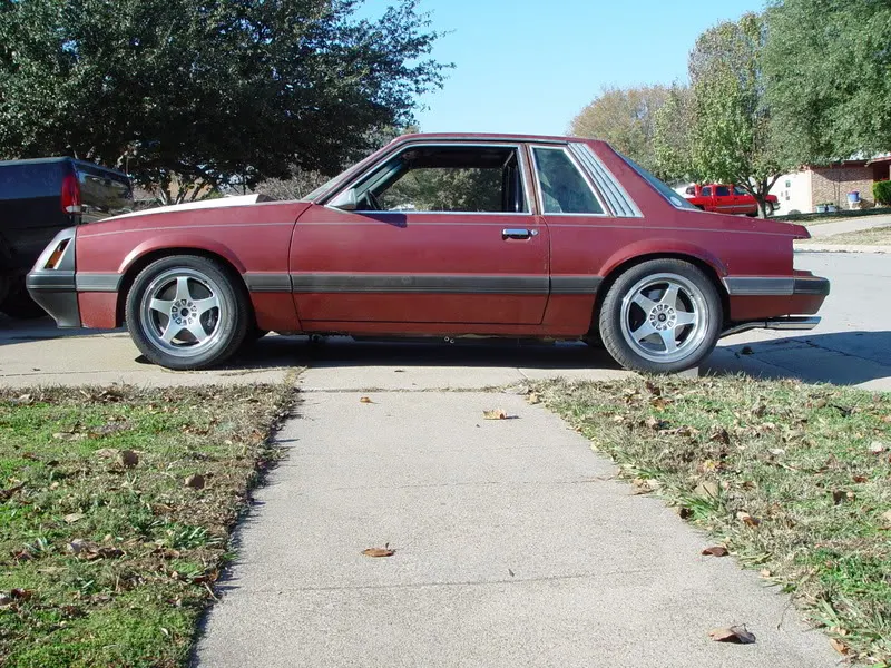

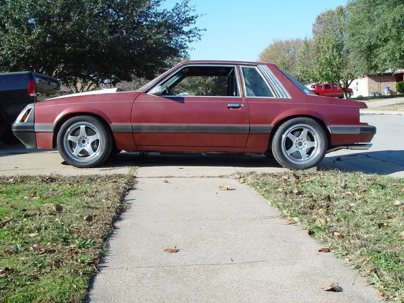

I put an '03 IRS in my '86 coupe because it was a 4 banger and I needed to ditch the 7.5, and I got a good deal on it. It didn't have brakes on it & I had some Wilwoods that were given to me, so I decided to put them to good use. I made brackets at work, I had to relocate the caliper to the front because it was too big to fit in the stock location. The swap wasn't difficult, I did it in my garage by myself in an afternoon. Obviously my car isn't running yet, so I can't say as to how it rides. For exhaust I have the stocker w/SLP loudmouths welded in. I polished the last few inches for that "LX" look, but I'm not too fond of the flared tips. I may cut them off and find some junk LX tails I can cut up and weld the ends on, then grind the welds down and polish it back out.
Here are some pics:
Sicarius428
Here are some pics:
im lovin the car! and the rims! if you dont mind me asking how much did the IRS set you back?
