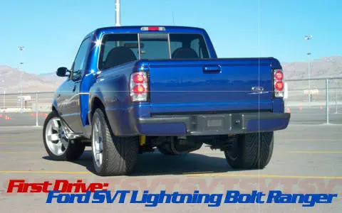

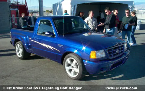

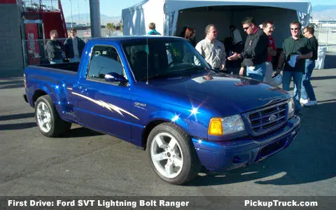

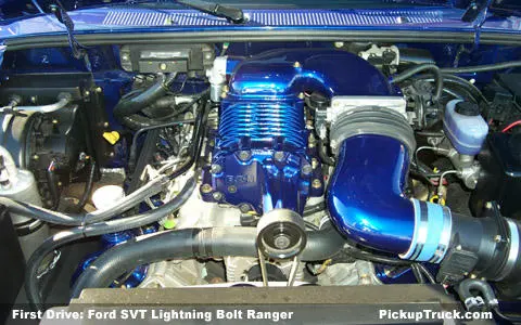

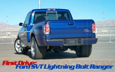

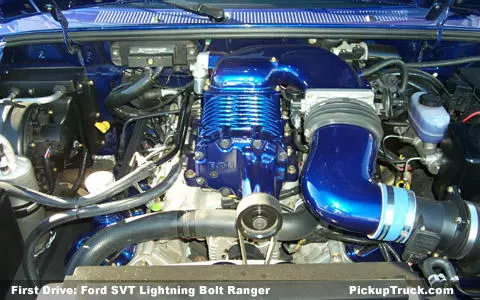

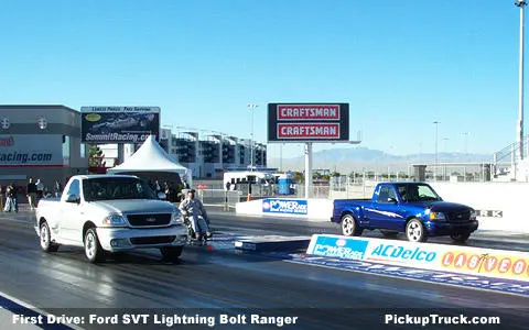

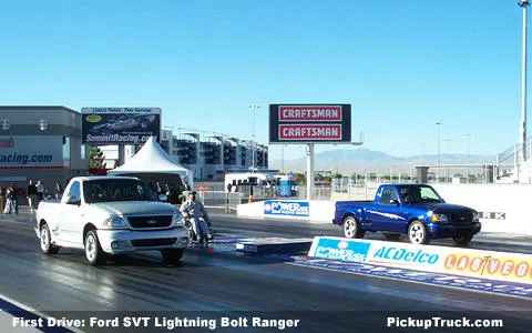

Screw the 302 drop. Build yourself an SVT Concept Clone.....:hail2:
The Ranger’s engine and transmission were replaced with the same 5.4-liter supercharged engine and automatic transmission used in the SVT Lightning, even though the compact Lightning Bolt weighs in at 1200 pounds less than its big brother. Custom 2-foot headers, a K&N air filter and the relocation of the supercharger’s air inlet to accommodate the Ranger’s unique air entry position were the only material changes to the stock powerplant. The exhaust system was modified with stainless steel and Borla Super Pro mufflers resulting in a power boost from 380hp and 450lb-ft to an estimated 400hp and 460lb-ft. Handling all of this power also meant replacing the Ranger’s stock driveshaft with a shortened 3-foot aluminum version from the Lightning.
All you need to do now is find yourself a wrecked Lightning. :D
