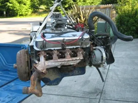

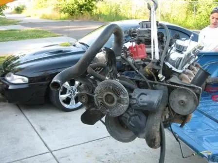

so i picked up a 351w with roughly 150k the owner said. also he said it came out of an 85 bronco and still ran perfect but he blew the tranny with it. now can anyone tell me anything about this engine, what kind of heads, cam, crank stroke, ANYTHING. ive been going through plenty of 351 swap threads and im getting this engine dipped and inspected in a month or so. so any help?
4got, heres a couple of pics

Ha same year as the one I used in my 1st swap good luck...the heads suck and the thermactor bump is bigger than the one in the E7 mustang head the main crank web area is weaker than a 69-70 block otherwise the block is ok swap in a modified 351 cleveland crank and 302 pistons you will basically have a 392
