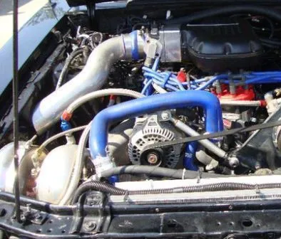

have any pics of the turbo?
Thanks for the correction. It's an 84mm turbine. It's an HP kit with a 3.5" downpipe into dual 3" pipes with the Dynomax Ultraflow race magnums straight through pipes out back.
I think that the problem can't be on that side. It seems like it has to be on the intake side, and I'm beginning to suspect that the filter supplied by HP is way too restrictive.
Here's the pic you asked for:

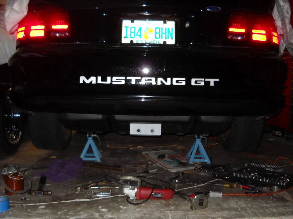

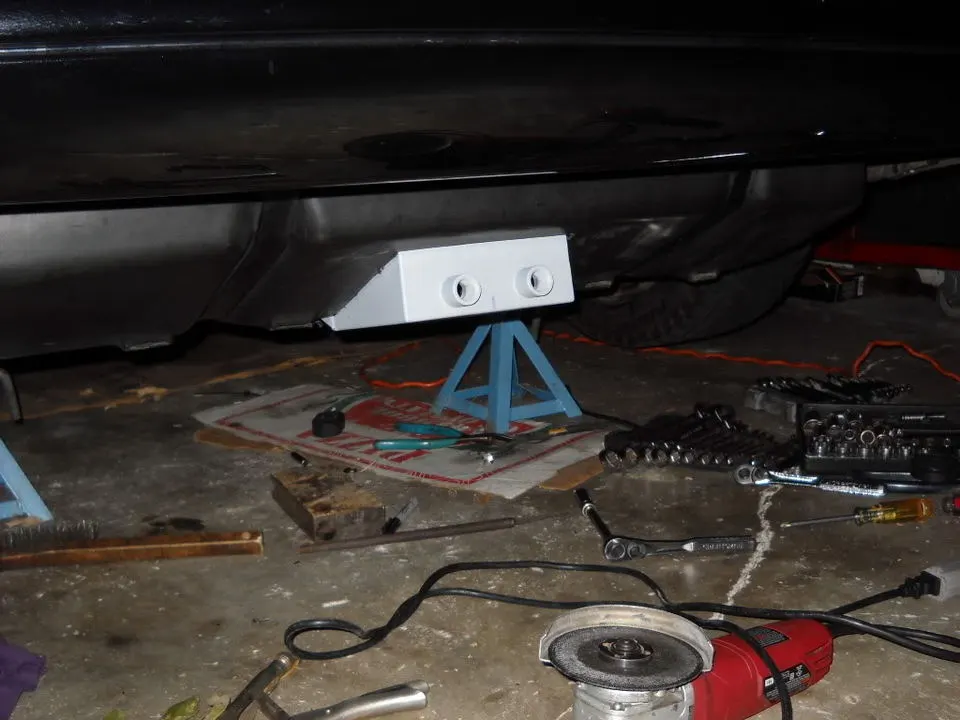

UPDATE! :D
well got the tank almost done today, got all the stock junk out, sump welded on, cover cut!

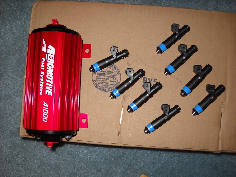

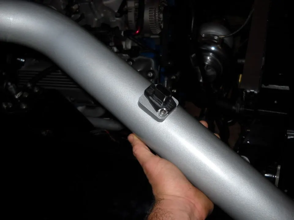

VMP HPX mass air! 05+ slot style
Aeromotive A1000, and seimens deka 80lb injectors

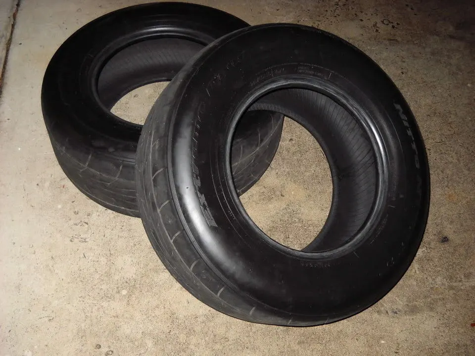

and if you noticed the small street tires on the car, dont worry! i sold my 15x8 rims with the worn out goodyear DR's, and im going with a 15x10 5.5 inch back space, racestars! the new direct drilled ones just came out so im waiting for them to get here! no more unilug! and i picked up there 275/60/15 nitto's from a buddy for $100 bucks! only a few passes on them, and btw ive never been a fan on nitto's but i couldn't pass them up for 100 bucks
