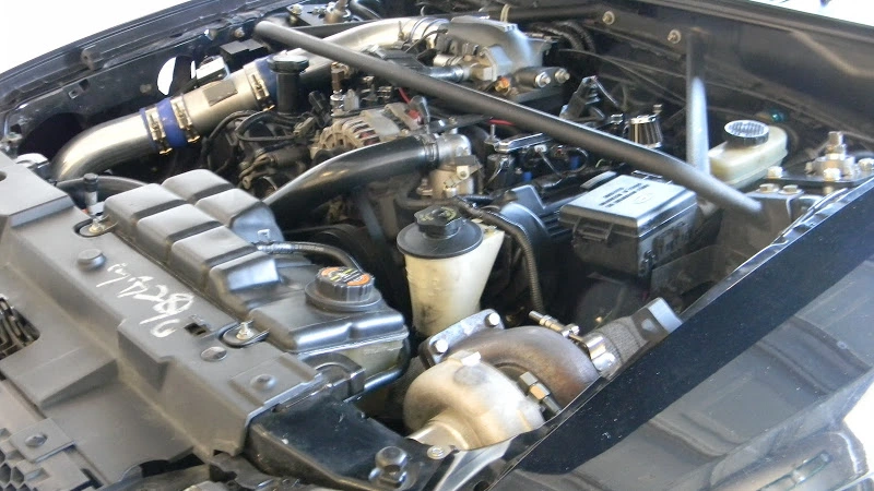

Got my FF on3performance turbo kit!
Maybe you can get a pre-filter kinda thing thats very high flow, just to keep the worst of it out?I dont drive many miles either, but I wouldnt want all the crap on my air filter going through that nice motor of yours.
usually it just goes right onto the turbo, but i dont think think in going to run one. if you run a filter on a turbo it has to be a BIG one, or it puts stress on the turbo fins, i dont drive enough it worry about it​
Where did you hear about the stress? Curious thats all, since all the turbos I have dealt with, even huge ones (2.8inch inducer @65psi boost :)), all had filters.
ive always heard that and have been told that. what size filters were those car's running? if you do run a filter on turbo its best to run a BIG one, like a good size K&N, but most turbo setups dont have much room to work with, so people end up running those small pancake filters, and being so small they dont have alot of volume in the filter it self causing stress on the turbo
Had a friend put a screen over his turbo on a GSR integra, the screen got weakened and then broke and got sucked up and destroyed his fully built engine. Might only be a Teg, but he put a ton of $ into it to be able to hit 375fwhp.
I know ON3 were able to position a larger filter on the 2v setup, whats preventing this on the 4v?
I drove 88 miles a day, 5 days a week for over a year with no filter and no issues. BTW the intercooler and turbo would stop any big items and rocks getting to the engine. I would not run one if you dont have too.
the 2v and 4v have different upper radiator hoses, the 4v runs closer to the inlet of the turbo

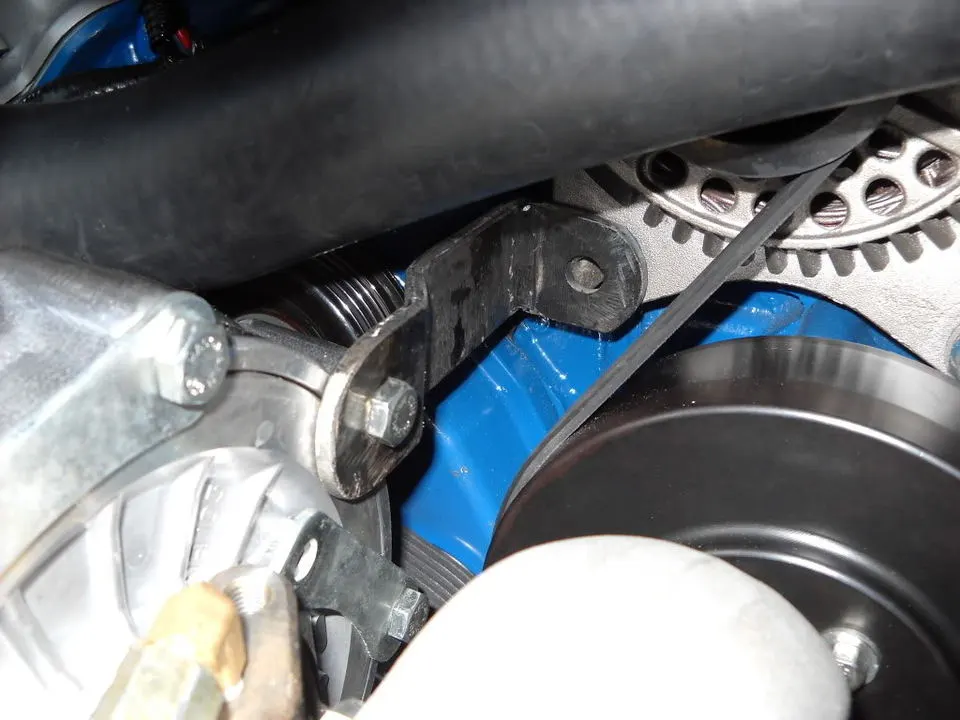

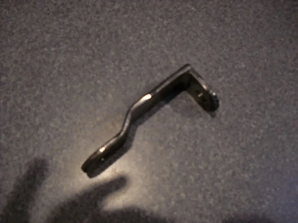

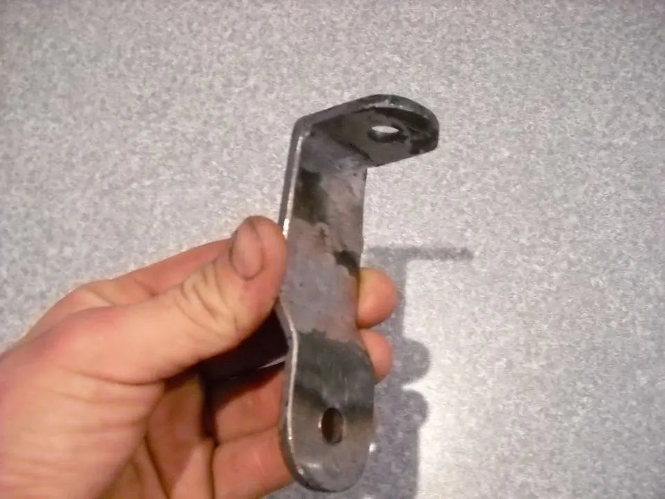

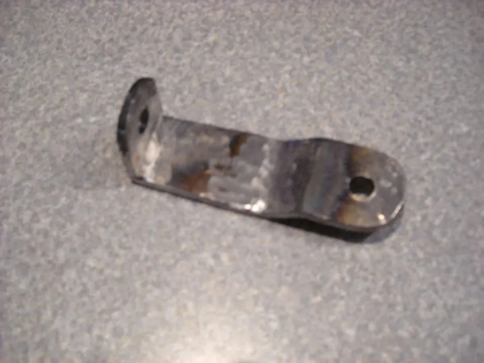

every things pretty much done, just been doing so small stuff, for some reason i never received the "turbo support bracket" when i got my kit. but i saw pictures of it that people had posted and it look cheap and flimsy. so i made my own!
made it out of 3/16 steel plate, all i have to do is clean it up a bit and paint it, that B$%^H is strong too:nice:
