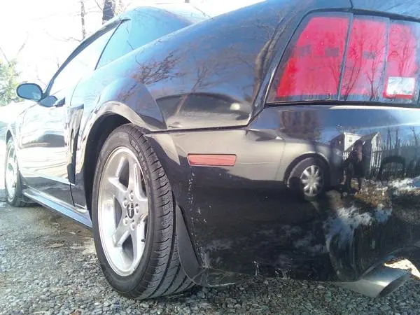

Installed the springs this morning and it went great! Car drives a little stiffer on bumps but i expected that due to stock struts and shocks. Looks and handles great! I went to get it alligned and they said it is too low!!!!! I mean it is low but not that low so i need to find a place to allign it. Will have pics up tommorow.

You can try asking them to loosen the lower strut bolts to see if there is enough adjustment there... They might look at you like your crazy, but insist on it. It may work; there is a surprising amount of slop in there.
Otherwise, get some maximum motorsports caster camber plates.

So did you do it yourself?
sorry here they are

I have them and my car is really low. Lower than the expected numbers. Most shops cannot align my car but here locally we have a "Brakes Plus" that can do it for the normal price. Call around. One place wanted to charge me extra to do it.
