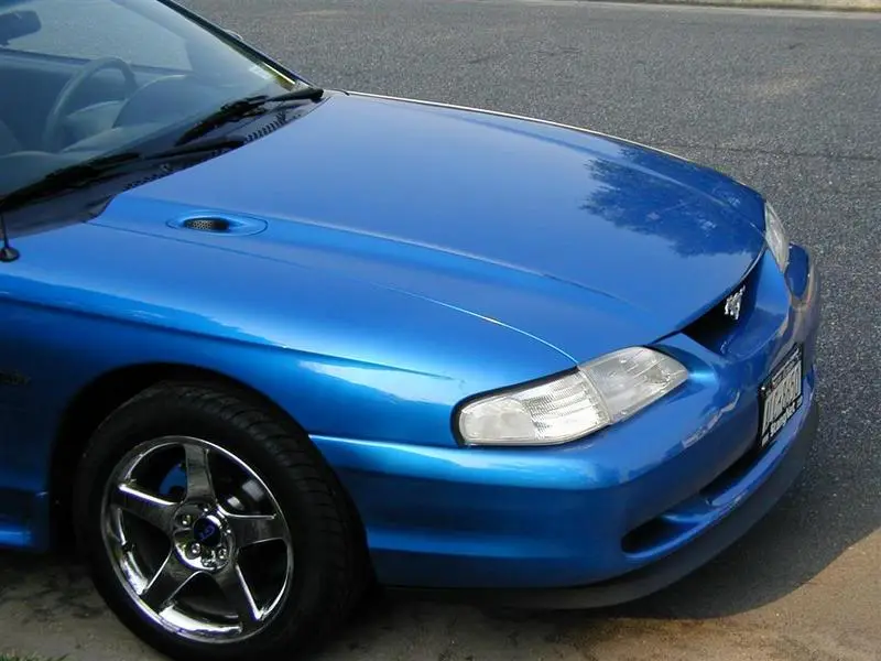

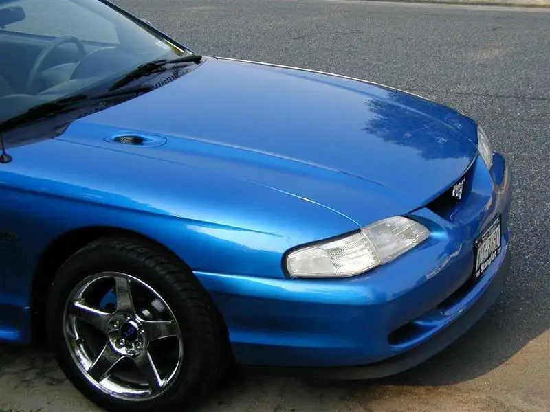

Well of course it's not Tim2002GT's, but this will give you an idea on what it looks like on an SN 95 and installed a not flush to the front bumper.... And please share the pics when your done.
