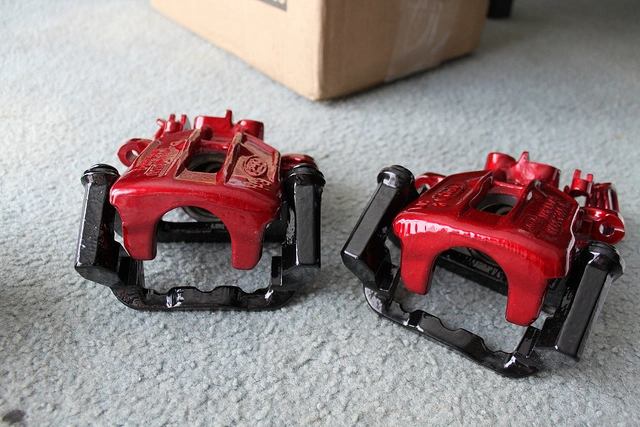

Got my powdercoated calipers back..

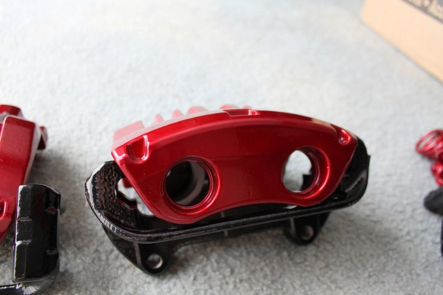

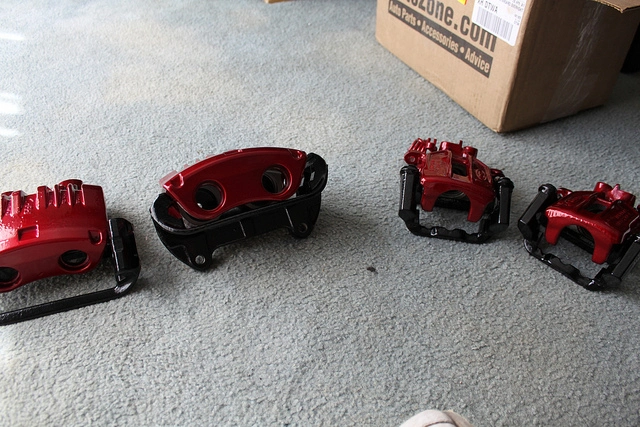

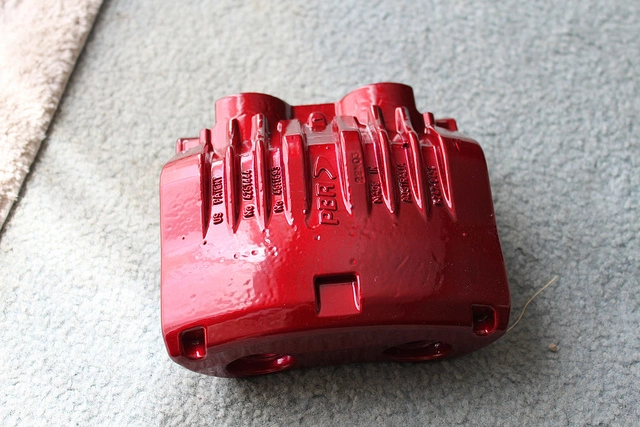

They're so pretty! lol
Everything is going on Friday.

Damn those look awesome!

Those look great!! Where did you get them done and how much was it?
I
ItsStock02
Aug 18, 2008
492
Westland, MI
Jun 1, 2011
  • Jun 1, 2011
Got them done by someone on a local forum and it was $120

C&S powdercoating. They have a website, but there's not much on it.

is that the original red that comes on the pony calibers? because yours looks a tad bit darker on my computer screen. That would actually look sweet if its the shade thats coming up on my screen.

Yea, that's how it looks on my computer as well. It looks kinda like candy-apple red. And they look freakin great!

They are candy red.

How does the powder coating hold up to the heat the brakes will experience?
They really look great.
normal (not specifically high temp powder) holds to 500 degrees no problem. they also make several high temp powders ranging from 1000 to 1500 degrees. Most powdercoaters cure the powdercoat at 400 degrees so brakes are no problem at all for powder.

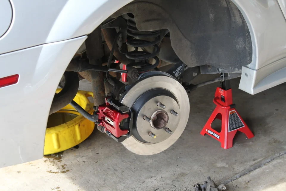

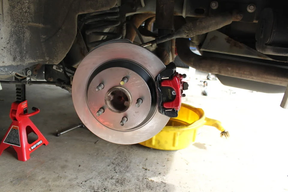

Ive been wrenching all day. Had to stop for a City Council meeting.
The rest will be finished tomorrow.

Did you have to remove the pistons from the calipers before they were coated?

I removed the pistons before having them done and on the rear ones I left all the parking brake stuff.
