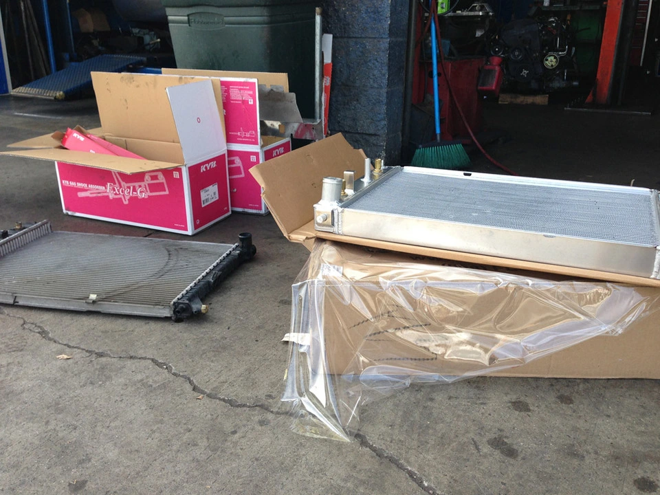

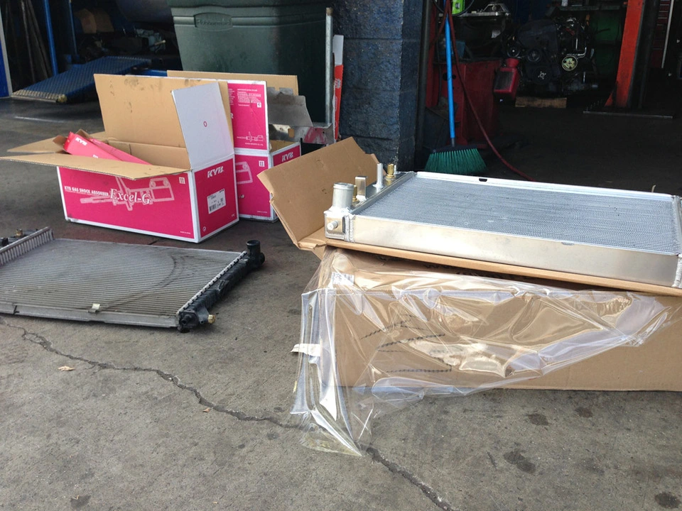

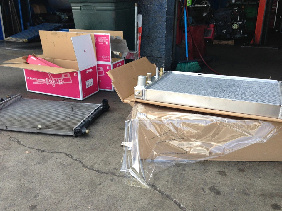

Sure I will post some now (at least of the radiator) :)

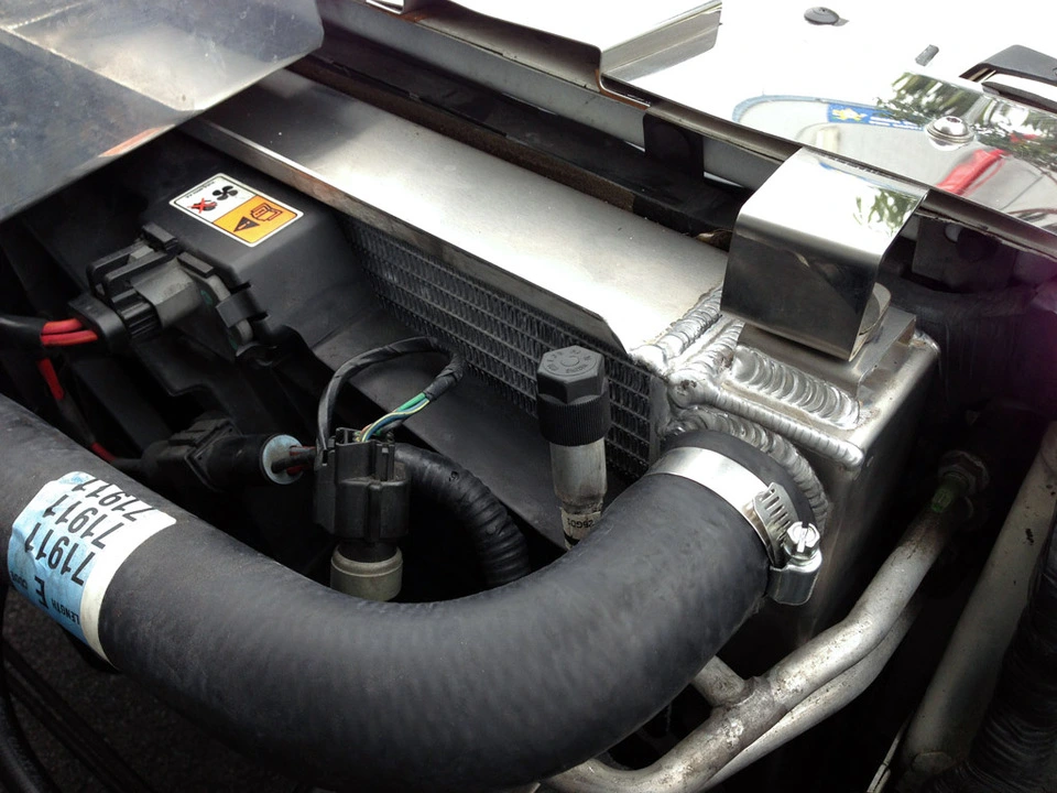

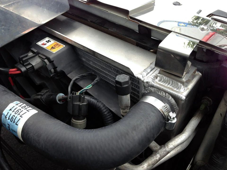

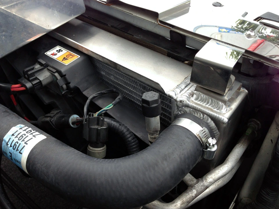

My old radiator on the left (I can't stand having the black plastic tanks on the sides) and my new aluminum radiator on the right.
The 3 row radiator looks massively great.

I know a bigger radiator might be overkill for my engine but it feels good to have peace-of-mind (having aluminum tanks). By the way, I'm planning on doing a 5.0 motor swap one day so I'm quite sure this radiator will be up to snuff with it :)

Southern California stop-and-go traffic is insane (especially on the 405)! I really feel good having a radiator that can last.
