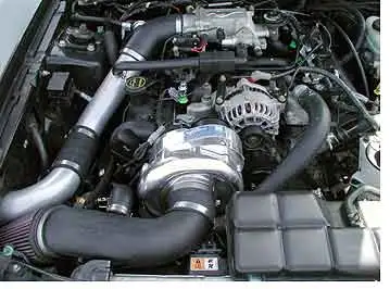

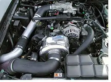

So, it looks like its an issue with the procharger setup. COuld it be pipe diameter? If the pipe is 2inch and blowing into a 3.5 inch meter then its not going to be filling that 3.5 inch meter properly and will have some very high winds blowing accross the meter making it think that its a full 3.5 inch volume of air going into the engine, when infact its not.
just guessing, but that would probably do it
Is your setup simular to this? I know its a bullitt, so thats slight different...but where is the MAF?
Its down in the fenderwell and the pipe is tiny. That sounds like it would confuse it. And i havent been to the track yet. Maybe in a month or two. I want to drive it for a while so im sure that it isnt going to blow up when i take it to the track, and the clutch and transmission are pretty new also so im gonna give them some break in miles. Its also been hitting the 20s lately so the cold track wouldnt have much bite. Ill probably wait till spring.
