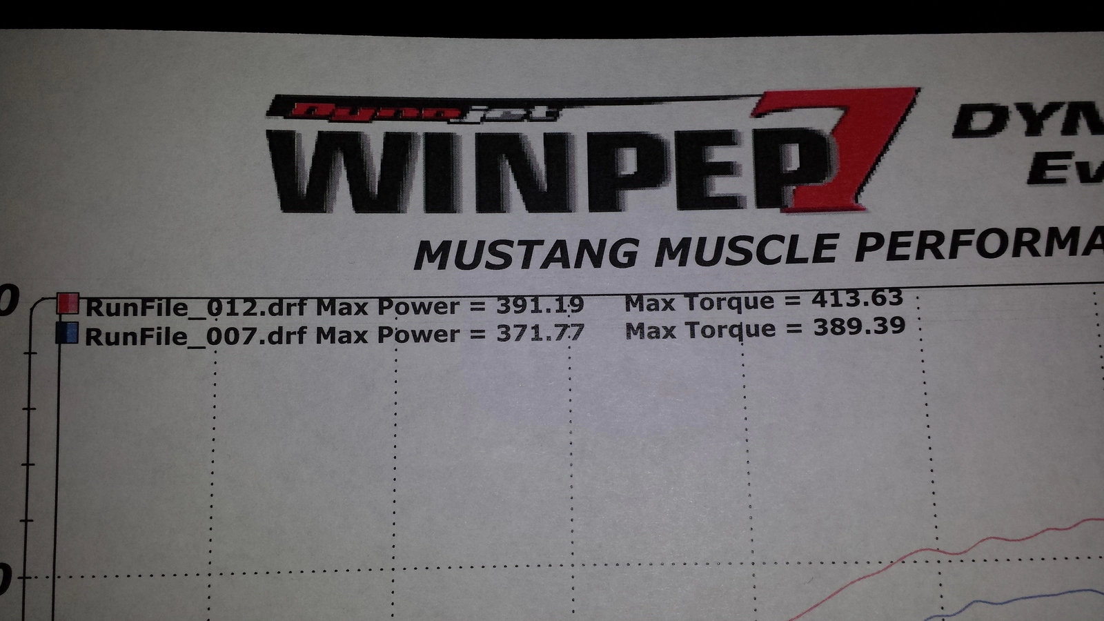

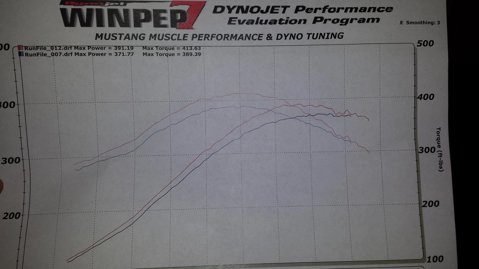

I put the ProCharger on back in 2011. It made 370 rwhp and 390 ft/lbs. That was with a P1sc Stage II tuner kit and a 3.6 inch pulley. I decided to do a new round of mods over the past year, adding Bassani Mid Length Headers, 78mm BBK Throttle Body and Plenum, a JMS Powermax Booster, and a 3.4 inch ProCharger pulley.
After going to the dyno last week and finding that my JMS Powermax Booster was failing, I left without any forward progress. I replaced the JMS the next day and the new one operated correctly. $200 net loss in dyno time.
Today's dyno results are 391 rwhp, 413 ft/lbs of torque, and the peak horse power moved from 5300 rpm to 4500 rpm. I don't have the boost level from the original setup but these new figures are at 12 psi of boost. :trip:
I'm kind of surprised I didn't make the 400 rwhp mark but none the less the car is healthy, running strong and the tune is on the safe side.
Aside from a catback, I am done with power mods on this car for a while. The catback is stock with weld in Flowmasters, so its not really performance I am looking for but a decent sound and nice looking tips.
Overall, I'm happy with what I got. I'm also happy to not have to lay on the cold concrete of the garage floor for a while. Time for beers...many, many beers.

Actually, I just looked at the graph again. It looks more like 5700 down to 5200 rpm but still, its pretty cool.

Very nice! It's a little harder to hit 400 than it seems, isn't it? Lots of people act like it's super easy to do on a stock 2-valve top end, but it actually takes some work to do it on a legitimate dyno (or trap speeds at the track).
With the way the torque line is kinda jagged up above 5000 rpm, I'd guess the AF ratio and/or spark timing could be worked on a bit more to get some more power out of it and get that peak back up a bit if you wanted every last horsepower out of it. BUT, I bet tuner has it pulling a little timing up top to keep it safe (which is a good idea at that power level), and that's why the peak dropped a little bit.
Either way, the peak is still high enough that the shift point is dictated by the stock bottom end and stock valvetrain (around 6000 rpm), and not the power curve.

Is it just me or do those number seem a little low? My car made 405rwhp at 5500 running out of fuel at about 10 psi
With 11 psi my car easily made 425rwhp and 444rwtq and my car is tuned very safe. This is also on a dynojet.

Different dynos, different setups, and different atmospheric conditions will change things. I've seen a newer GT500 make 740 rwhp on one dyno on one day, and then the next day on a different dyno but same weather and same correction make 680. My car made all of 360 rwhp the last time on the dyno, yet traps 117+ mph at full weight. Trap speed at the track, along with the corresponding density altitude and race weight, tell the real story.
What correction was put on your numbers? SAE, STD, or uncorrected?

Some additional info about the two runs listed at the bottom of the dyno graph. Red lines were run at 61.96 degrees F, with 6% humidity, 29.77 in Hg, SAE 0.96. The old run in blue was at 69.28 degrees F, with 6% humidity, 29.6 in-Hg, SAE 0.98. What does this mean for my numbers?

SAE and STD are just methods for correcting your actual, uncorrected numbers to a standard value. This is so that you can [somewhat] accurately compare different dyno pulls in different atmospheric conditions. This isn't always 100% accurate, though, as a car may actually gain more or less power for a given condition than the correction factor allows. My car, for example, is much more sensitive to temperature than the correction allows; therefore, it'll put down higher corrected numbers at lower temps than it would at higher temps.
If memory serves me correctly, SAE corrects to 29.25 inches of pressure, 77 degrees F, and 0 % humidity. STD corrects to 29.92 inches, 62 degrees, and 0 % humidity. Because most all cars will make more power at the higher pressure and lower temperature of the STD standard values, they are always higher. Normally around 3% IIRC.
Mattstang, that 0.96 SAE factor simply means your numbers were multiplied by .96 to correct to the SAE standard values. So your uncorrected numbers would have been 391/.96 and 413/.96, or 407 and 430. Your STD numbers would be about 391*1.03 and 413*1.03, or 403 and 425.
Superstang, that means your numbers in SAE would be about 425*.97 and 444*.97, or 412 and 431. So y'all's SAE numbers are 21 horsepower and 18 torques difference.
