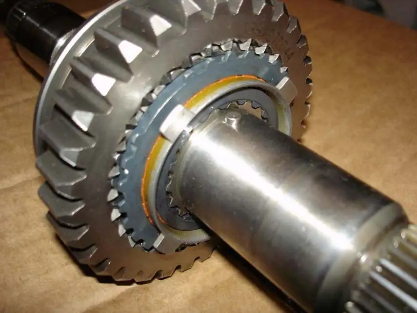

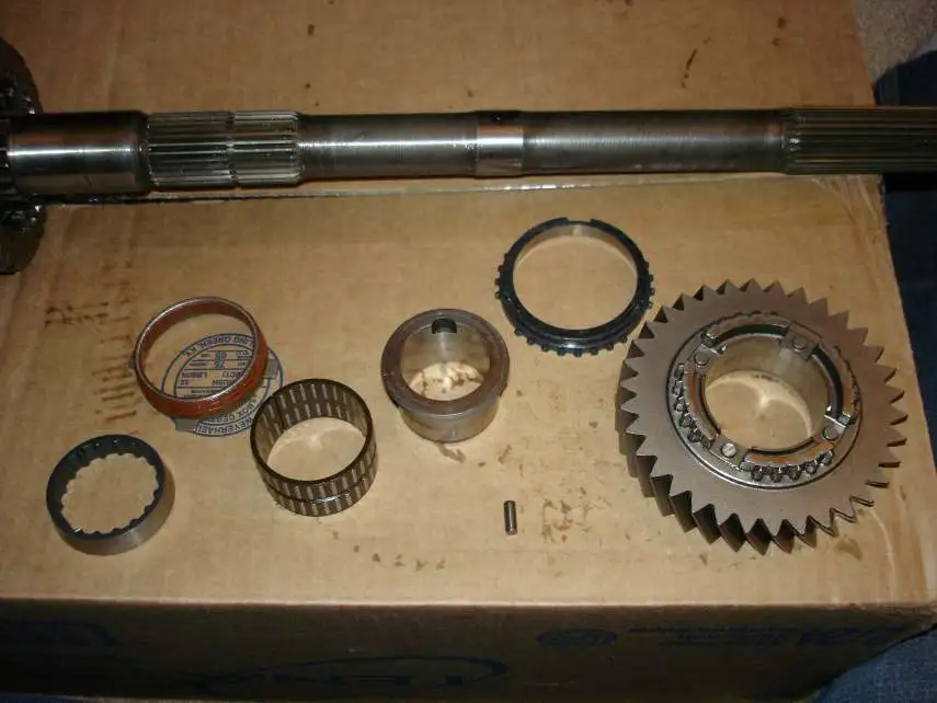

They are talking about this pin shown here in some pics during my last rebuild. The 1st gear parts are layed out. The pin is in the center. In the next photo you can see it installed.
