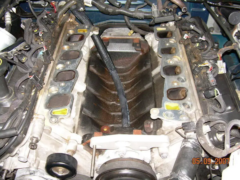

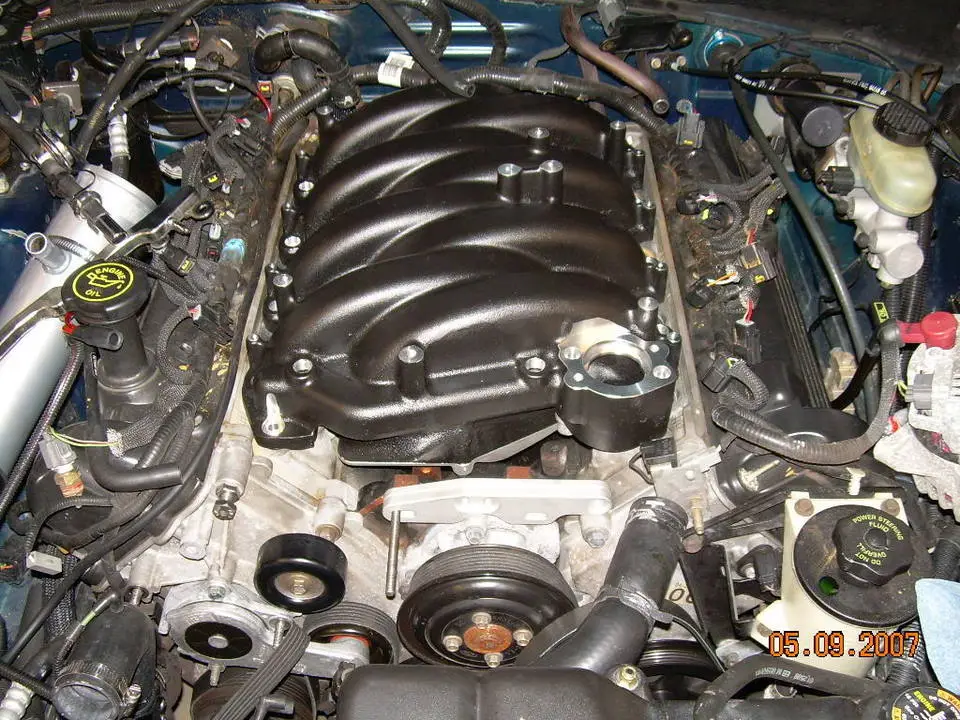

Got the Trickflow Track Heat intake

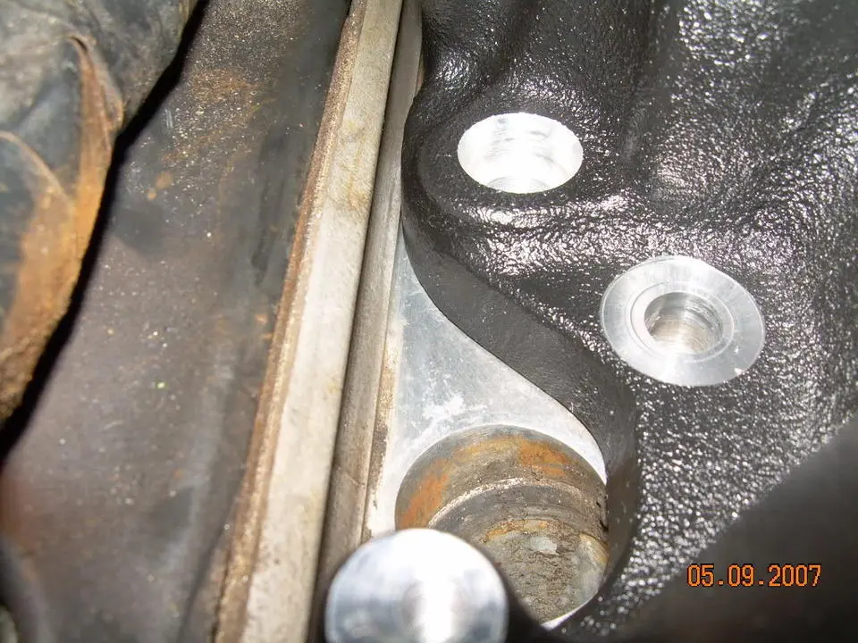

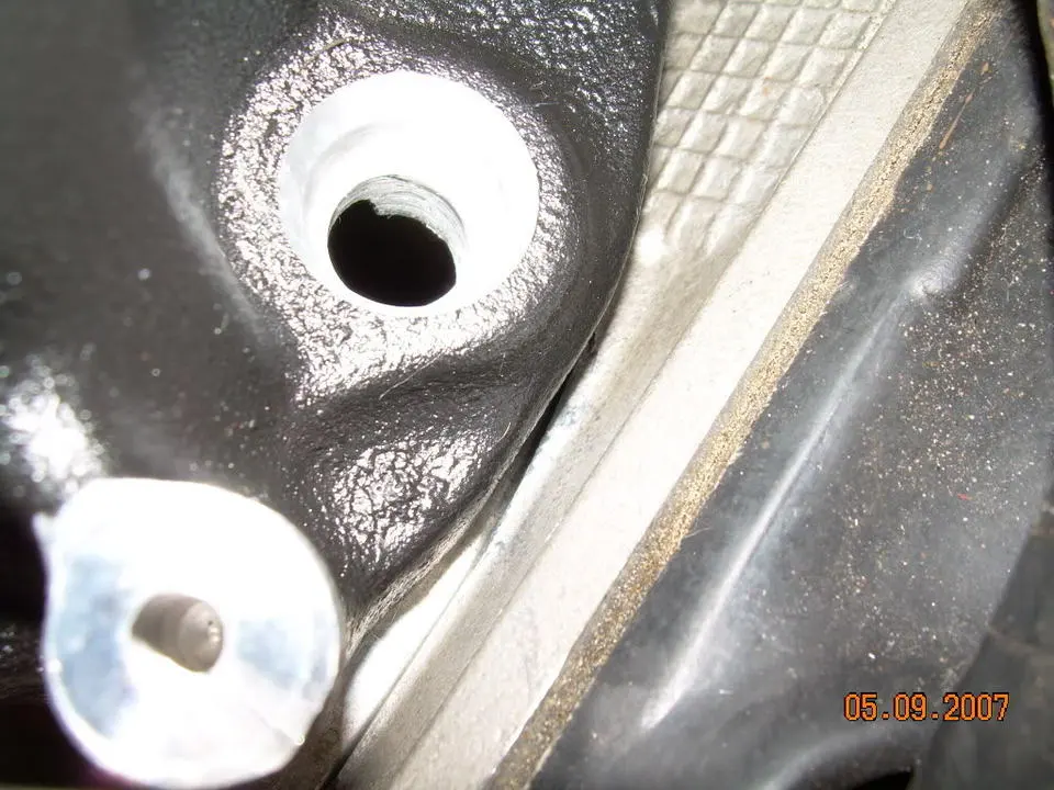

When I first "test fit" the intake to the heads to see if everything lined up, I had no gaskets(I just set the manifold on) and it didn't line up. It fits in so tight, it was touching the edge of the machined lip of the heads. Once I threw the gaskets on, they spaced it up high enough so they didn't touch and everything lined up, but it's tight.
