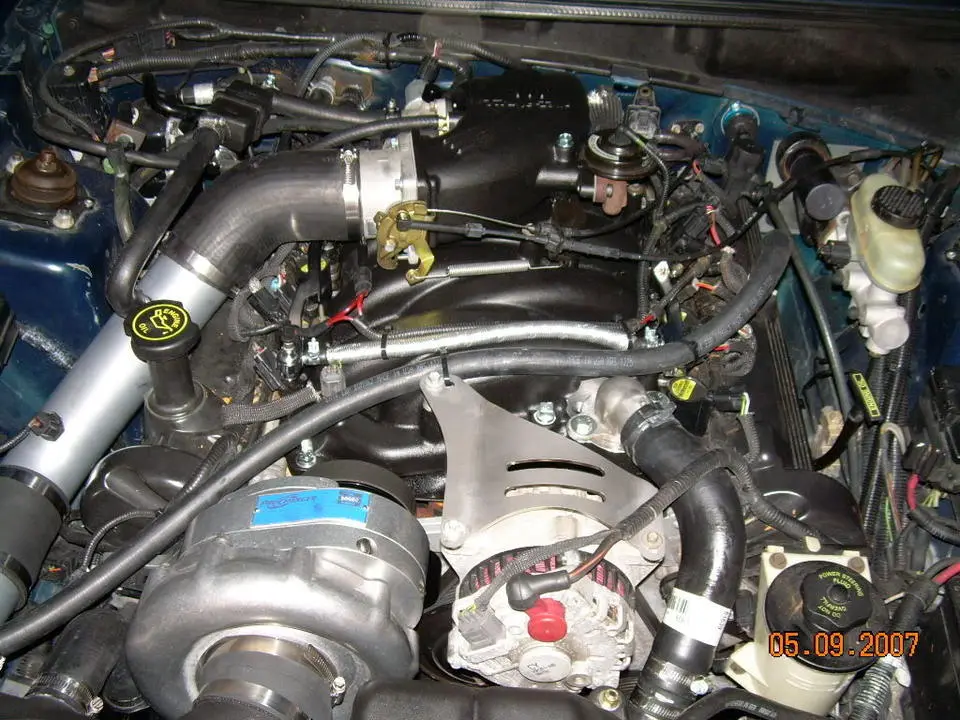

I've got some pics of the intake, if someone wants to host them for me. Windows Vista once again has failed me.... Got to go out and measure the new alt brackets to see if it will work with the Procharger....

Works with a Procharger! Got some coolant leak issues to take care of first, so I haven't driven it yet. I have a dyno appt tomorrow:
