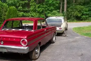

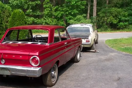

What year is the falcon?
'64 Falcon
I love cars like that. Don't kill the Mustang. We have done up some nice "parts cars" here, and they are all still on the road.
