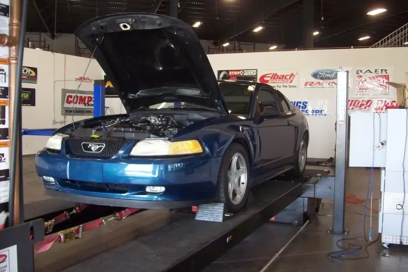

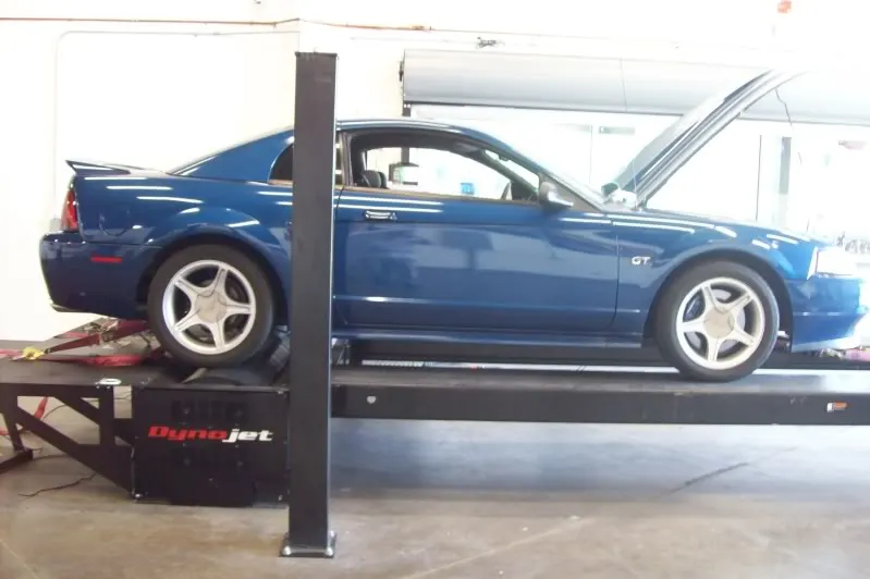

oh and its a dyno jet... when i get home ill post pics and the vids but for now, im at work and cant do so...if my car rlly makes that little of power this will make the worst bday ever :notnice:

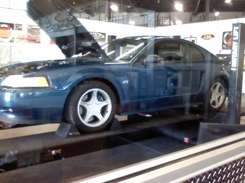

took a quick pic with my phone
