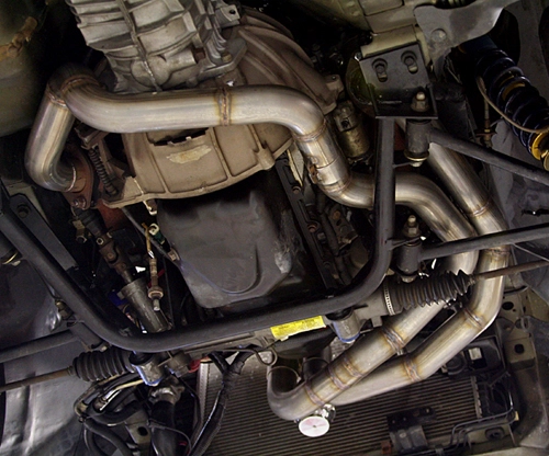

blubulit said:
i really was just thinking of some ideas, but i would rather put teh turbo up at the front of teh car, but dont know how i would make both exhaust manifolds connect to the exhaust flange on the turbo.
like this?

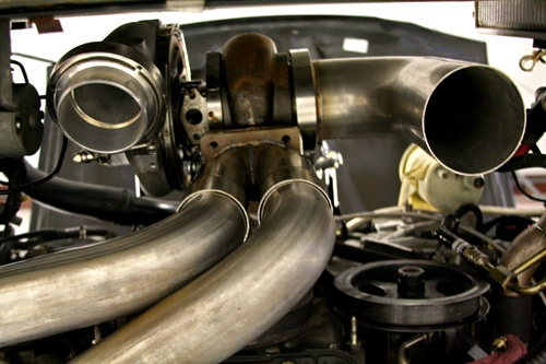

You know there are turbo headers to that point the exhaust towards the front of the car too
CobraRed_96_GT
May 20, 2006
1,421
39
UCSD/La Jolla
Feb 11, 2008
  • Feb 11, 2008
Another: most all require a tubular k-member tho:
