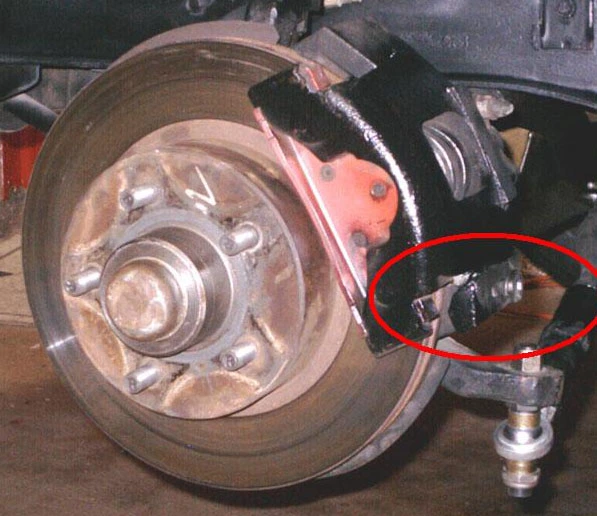

I have the granada swap that was done about 10 years ago from a kit I bought from California mustangs.
I went to have my rotor turned and replace the pads. First problem was that the piston was so far out that both pads wouldnt even fit in the caliper. So I removed the bleeder valve, forced the piston all the way back in and that freed enough space to put both brake pads in(Now the piston was so far down that the surface of the brake pad was below the cliper itself). Once both pads were in, I tried to slip them over the rotor. The gap inbetween the brake pads is about 1/8 inch smalled than my rotors. I ended up having to put my old pads back on in order to get it to fit over the rotor.
My question is that these are a floating caliper? Mine appear to not be floating as well. the floating section that hold the outboard pad doesnt seem to want to come out to give me that extra slack. I see a slightly wedged shape tab with a allen head screen on it which looks like it has something to do with how the outboard half of the caliper moves in and out. Is there something I can do to free this up or am I better off just getting new calipers too? My pistons are not seized and there are no leaks so I dont want to replace them unless I have too.
I attached a picture of the wedge shaped piece I was talking about.

A C-clamp will push the piston back in the caliper without releasing any of the fluid.
The whole caliper floats as one piece, not the individual parts.

both pads were correctly seated. In fact I had he piston pushed in so far that the inner pad was below the surface of the inside of the caliper thus taking the inner pad completly out of the equation. The caliper appears to not be as wide as it used too.. its a floating caliper so even though theres no piston on the outer pad, the whol caliper should move in. It doesnt appear to be moving back out all the way.
I havnt had time to look more into but Im gonna take another look and get a granada manual so I can see how that caliper works. there is some type of clip with a spring (circled in the picture attatched above) that has something to do with the way it floats.

Have a look at these instructions: Granada Disc brake swap
It describes the completely swap from the granada disc brake with much pictures and very good explanations. Also you will see on point 27 the key support spring with the the key support have only holding and floating function. The caliper cannot be widened, only the piston can be forced back to make enough room for the new pads.
You can check easily with 3 measures if the hole thing is fitting or not.
1. measure the space between the inside surface where the inner pad will sit and the surface on which the outer pad will sit
2. measure complete thickness of each pad
3. measure disc thickness
4. result from 1. minus the two pad thicknesses should be equal or larger than the disc thickness.
