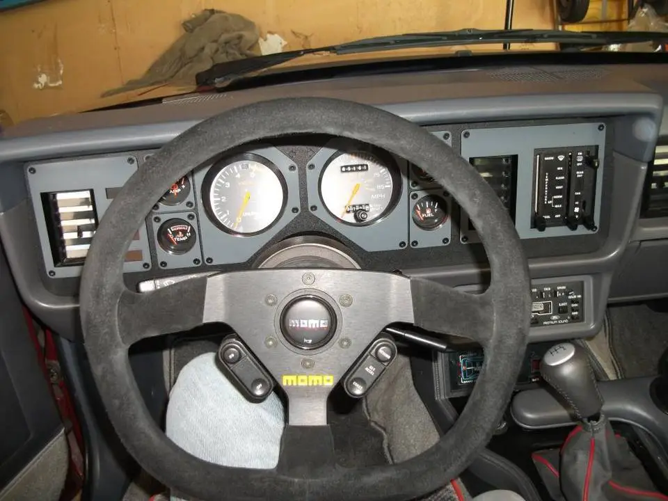

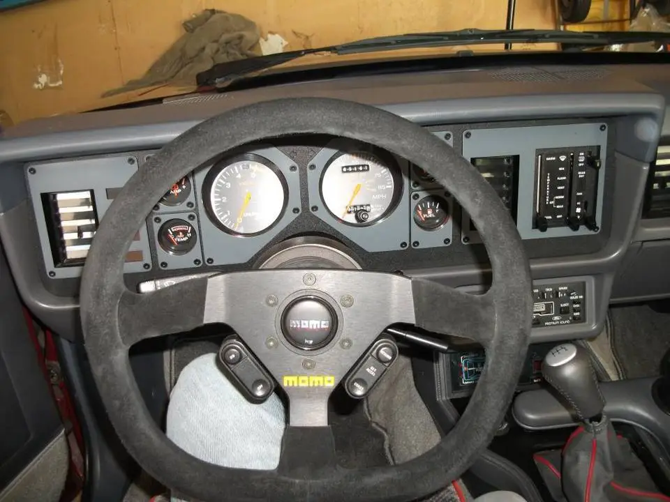

I couldn't find the mount for the cruise switches either,ended up fabricating my own.Just install the plate above the standard Momo hub adapter.Start out with a cardboard template then transfer it to 16/18 ga. steel plate.

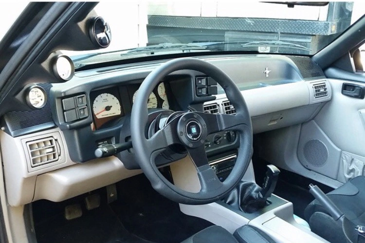

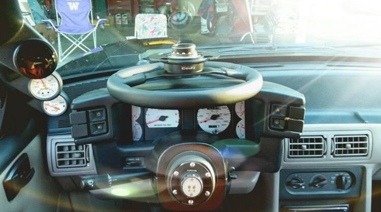

Every car I've ever modified has had the OEM steering wheel hit the rim of the trash can on it's way out in favor of an aftermarket replacement. This thread was my motivator to go out and see how my wheel was gonna fit, and I too would have a gap between the factory column cover and the Grant trim ring. (And I don't even have a tilt column).
This would be a concern for me if I wasn't gonna have to make a replacement column cover out of steel anyway. (The Fairmont cover had a shifter handle in it, and w/ the dash, the whole thing is too damn long anyway)
I'd say the gap is exaggerated in the case of a Fox column that has factory tilt so that there would be ample room for that to happen.
Maybe you could get some of that fuzzy hairspray stuff that bald guys use to fill in the gap?
That's all I got.
That just gave me a funny feeling in my pants! Once again a great idea for my project! Thanks for the pic. Awesome and btw the 85/86 dash imo is the best looking of the fox bodies. Especially if those circles are filled with aftermarket gauges. More aggressive than the generic later models.

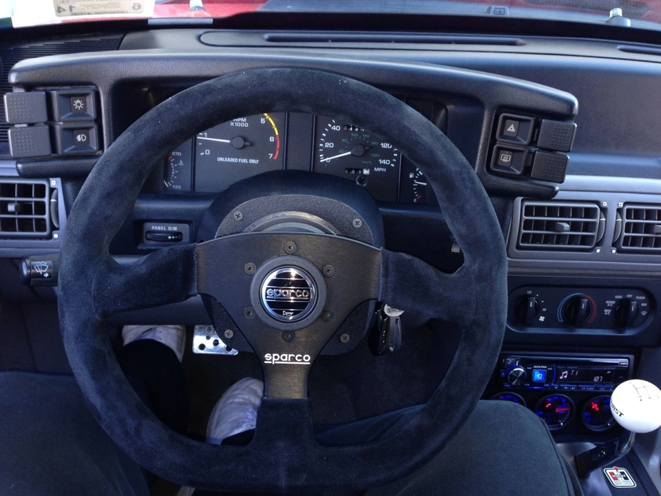

If your car is post 89 and you add a grant steering wheel, you can use the stock column cover 1990-1993 minus the airbag clockspring. You would have to use the small tilt wheel collar from 1987-1989. Fits perfectly with no gap. You have to mod it, cut tabs and JB weld it to 1990-1993 stock column cover and paint JB Weld black. It can be done, not legal due to removal of airbag and not recommended. But can be done.
