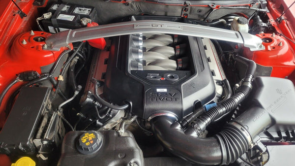

The Parts Farm has turnkey offerings like this one:
