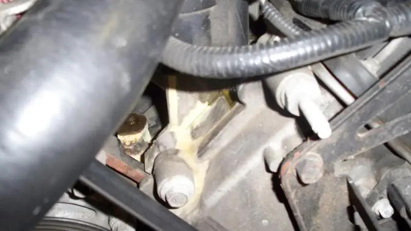

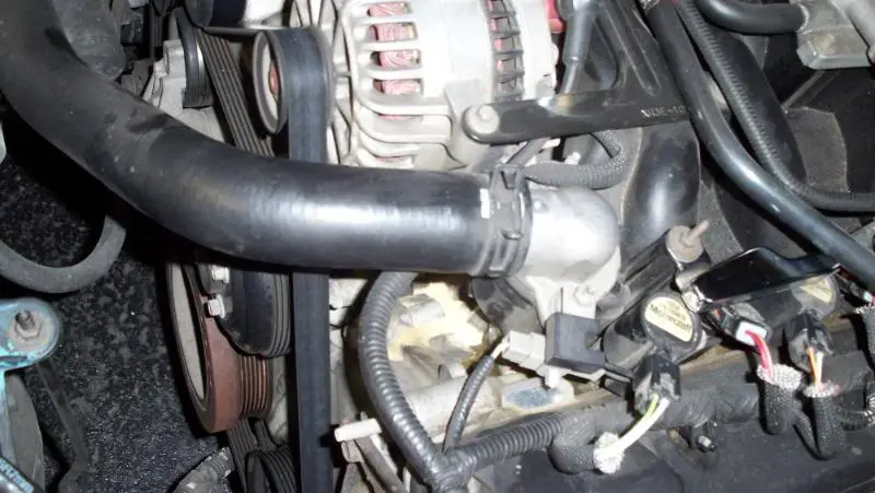

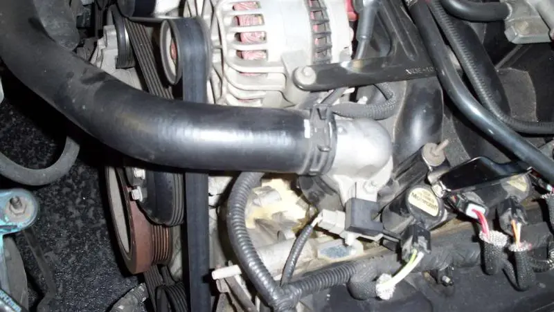

Well, I think Im the newest member of the no-so-fun-to-be-in club of faulty intake manifolds. I have attached a few pics.

I dont see any cracks in the intake itself, should I be able to see it without a complete teardown?

When mine cracked, I could not see the crack from the outside. After removing it, I could see a small crack running where the thermostat goes. So you may or may not see the crack from the outside. If it's leaking coolant, it's cracked. Gotta love Ford!
i just swapped mine. be careful when you are taking the thermostat housing off, mine got rusted cuz of the water that was leaking and broke. i had to drill em out and install a heli coil for both bolts.

Before you replace the intake manifold, if you don't see where the coolant is leaking from a crack around the thermostat housing then remove the two bolts holding the thermostat housing down and inspect the gasket. If the thermostat gasket is torn or the housing isn't seated right when it's bolted on it could result in a leak in that area.
