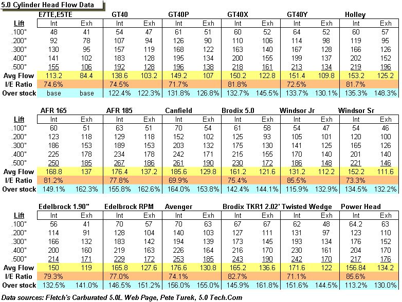

not sure about the specs but here's the flow:
Yes, the P is slightly better with smaller 58cc chambers, relocated spark plug and a better flowing exhaust port. But they do require a P specific header, or BBK or MAC LT's to clear the different plug angle.
Don't bother testing the springs, even new they're too weak for the F cam. Trick Flow makes a nice direct fit spring kit for $120 or so from Summit. Personally, I'd consider the TFS Stage 1 cam over the F cam as well.
You can expect anywhere from 260-300 RWHP 300-330 RWTQ, depending on the shape of the engine, cam specs, and whether the heads are worked or not.
My 170K, oil burning, carbed- P headed 302 made 283/308 at the wheels...
