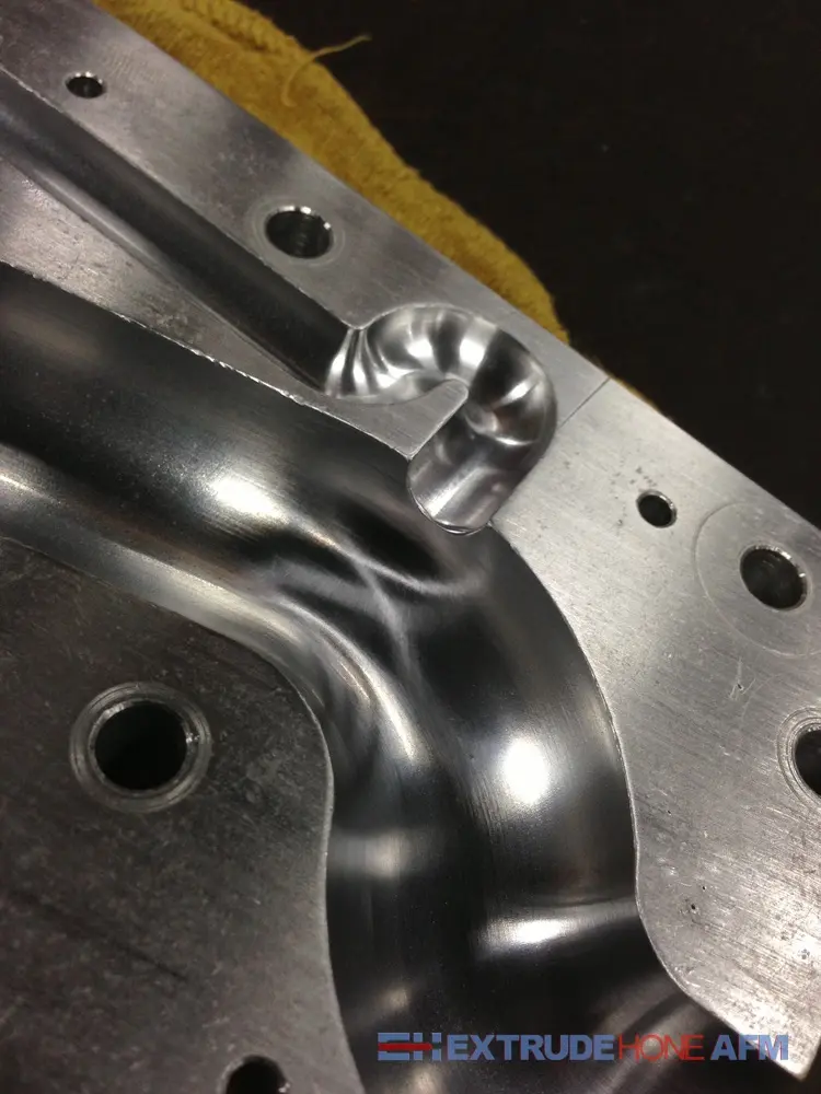

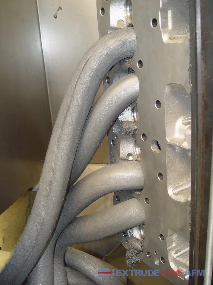

If you wanna get [really] crazy :rock:
The next time you pull the heads (for whatever reason), find a place to take your entire inlet tract and heads to get them extrude honed:

I had extrude honed twisted wedge heads. Even getting the heads bare brand new and technically for free (i had to pay the extrude hone bill for someone that abandoned them at my buddies shop, at the time it was $750), they still were pretty expensive, by the time i bought all the hardware and paid for the valve job. Would i pay to have it done? Not totally sure. The theory at the time was that straightens and smooths out the path without opening it up too far and killing velocity.
Does it work? I'm not totally sure.
What they will do is work well on a 302 and a 347.
If i had a 302 and X heads, i'd have them valve jobbed and all the work that goes along with it (like springs, bowl work) and run them. They will be close to as good as box stock 170 Tw's.
To be clear, i also owned X and Y heads.
Now if you get into a 347, it could be an issue. There are good CNC programs for TW's, not many i've seen for X's.
I'm also all for port matching intakes to heads while they are at the machine shop.
BTW, back in the day they used to extrude hone cobra intakes before there were 50 better ones out there. It would hang with the best out there on smaller displacement engines, but i don't think it can hold a candle to an RPMII.
For me, that's way too much!
Very interesting though!
