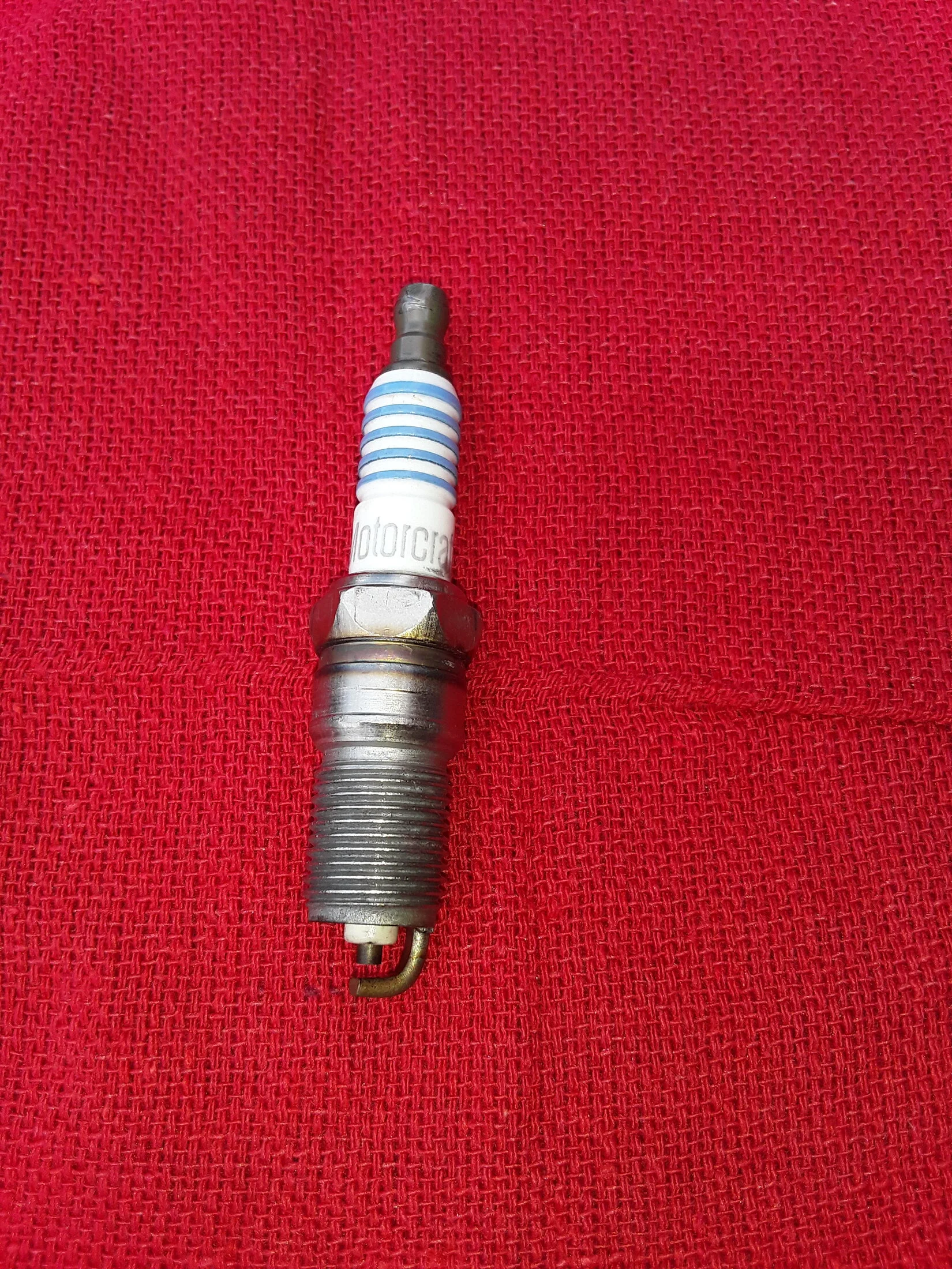

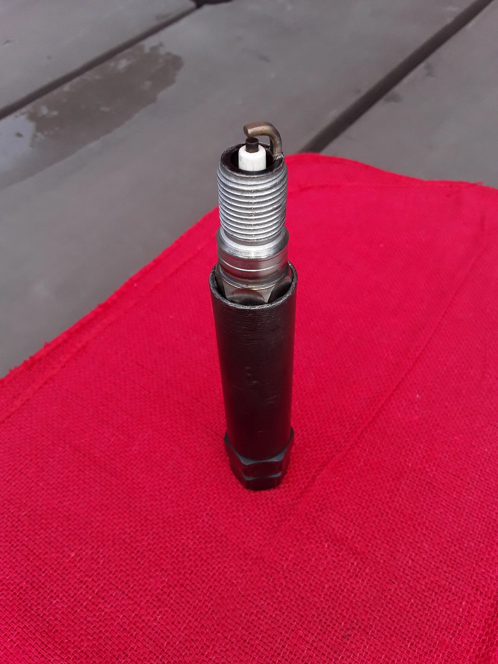

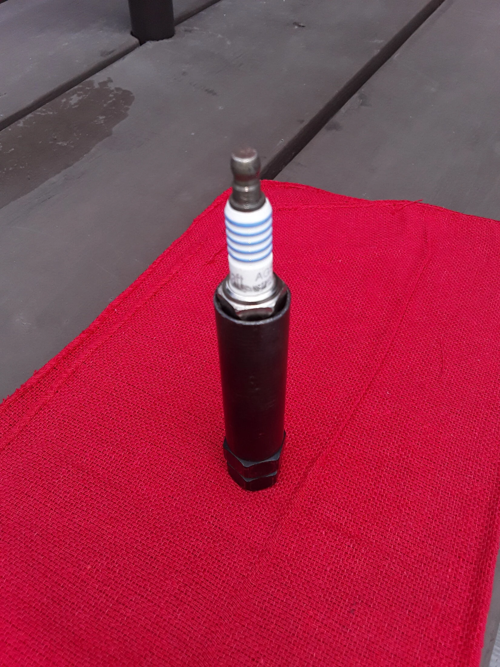

Post up some pics of the tips of the old plugs ....The tip edges of the center electrode tells alot....
Reactions: 93gtmustang
The plugs are pretty new. Installed this past April.
Stock Ignition, 9.0:1 compression, Ford Racing 24 lb. injectors, Hypereutectic pistons (I think they are dish domed ? It's the old M-6007-XB3M Ford Racing Crate Motor) Aluminum Radiator, Electric Fan, 195 thermostat.
