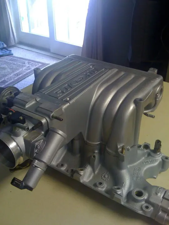

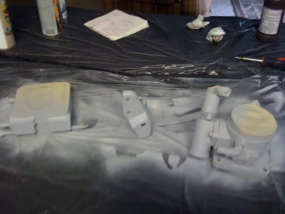

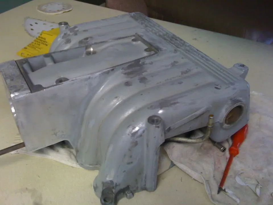

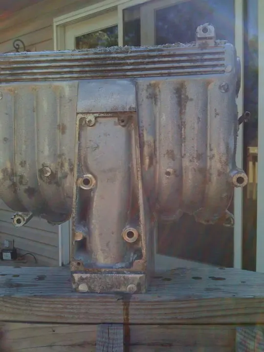

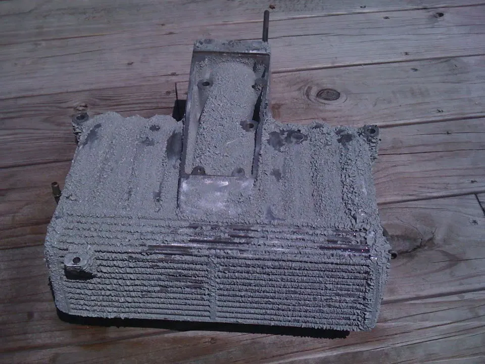

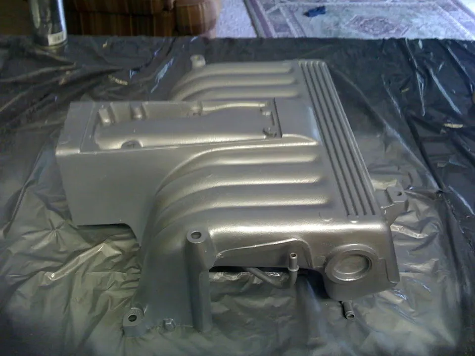

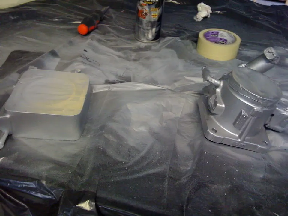

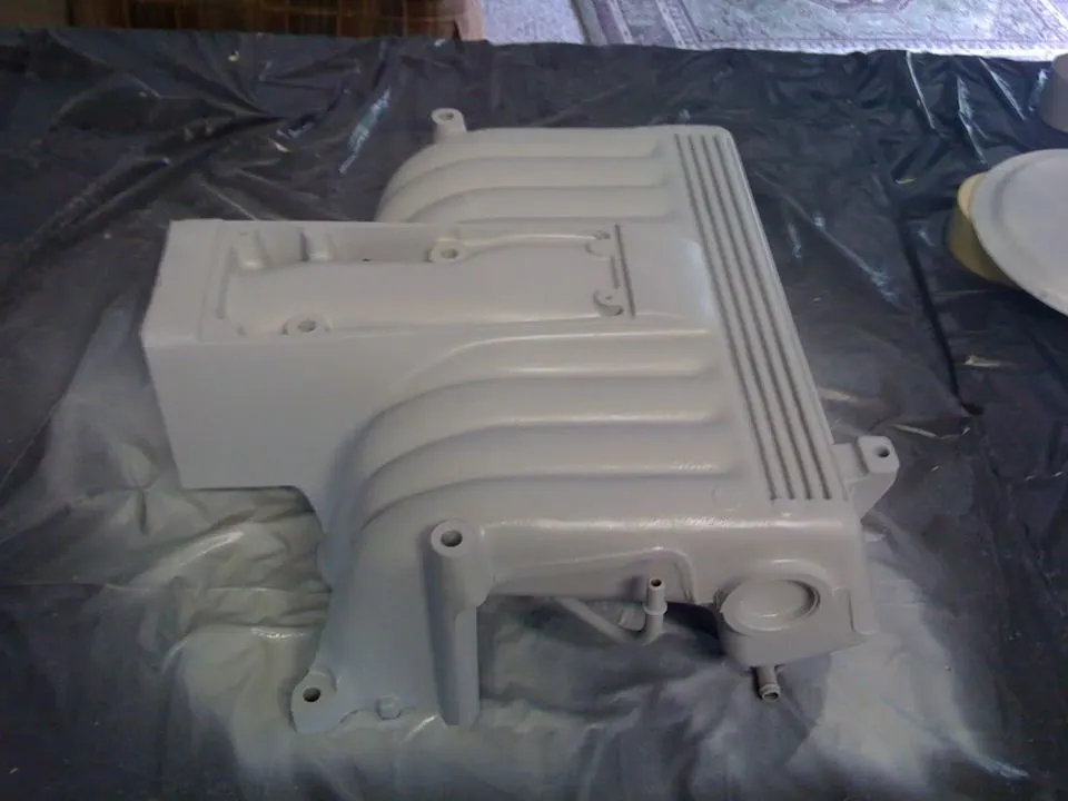

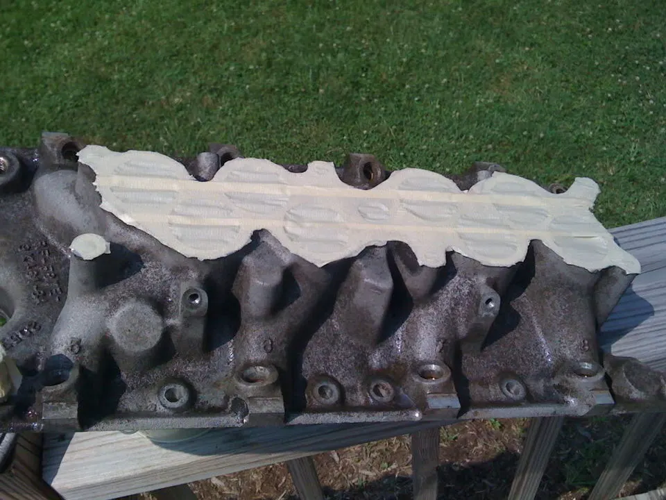

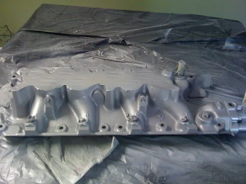

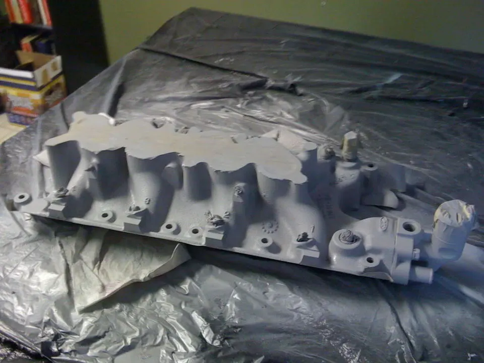

so i bought the whole gt40 set up a few weeks back to put on the 91, theyre in great shape and should work perfectly i just wasnt happy with the looks and i figure if im gonna take the time to put it all on it might as well look good, so this weekend i decided to redo the intake, and these are the results, let me know what you think.
BEFORE
Paint Stripper is good stuff
After Stripping
Primer
Lower intake required a lot of degreaser
more priming
throttle body and spacer got the same treatment
Finished Product
Not bad for $75

Is that just an engine paint? Looks pretty good I think
tannerc91gt
This last 25% is foreign territory at this point
4,392
2,967
Indiana
Jun 28, 2009
  • Jun 28, 2009
its dupli-color cast coat aluminum hi-temp paint, i thought it came out really well for what it started out as

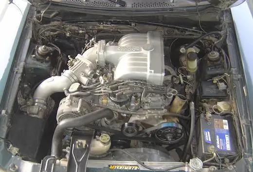

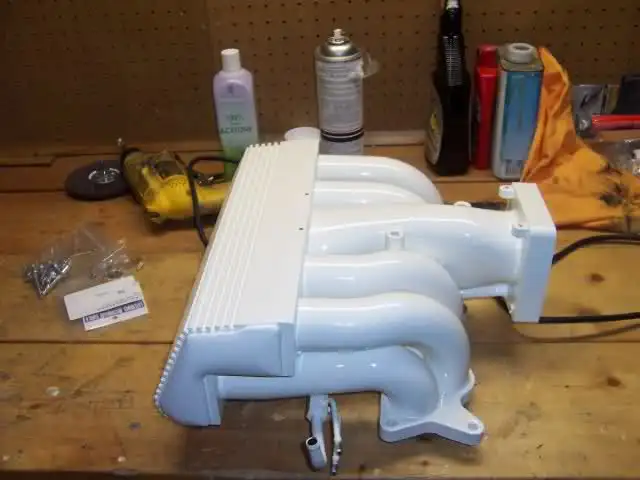

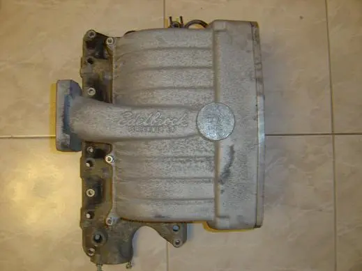

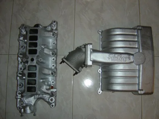

1000% improvement. I also used heat-resistant aluminium paint on my Edelbrock:
Before
After
Installed
Definitely worth the effort.

I just got a gt40 intake for free today
Ima take it to my buddys and get it all cleaned up in his solvent tank then go and find out what color I want to use, do you just use masking take to cover all the stuff you don't want painted?

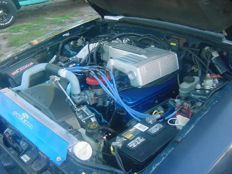

Lookin' Good!
I did mine last year. If you haven't put it together yet you may want to grind that bracket mount off of the side of the upper. It meakes it look much cleaner. I also ground the seams off of mine too. This picture is kinda crappy (1.3 mega pixel) but it gives you an idea.

To id89gt:
Yes just use masking tape and a razorblade, it works just as well as painters tape
