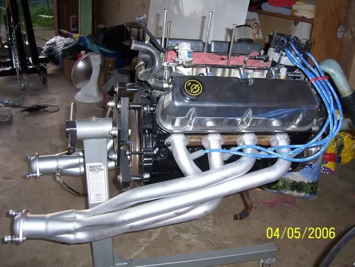

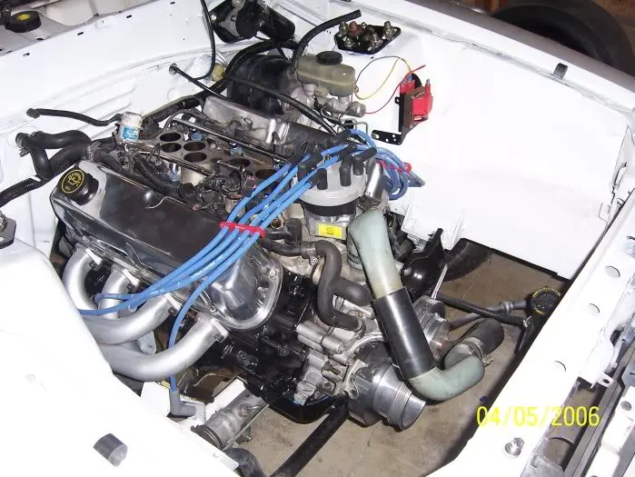

I have gt40p's also with mac long tube headers and no problems with plug clarence, and i have the ford racing blue wires from summit! Heres a pic of them:
BTW what all did the gt40p's come in and years? peace
john:p
