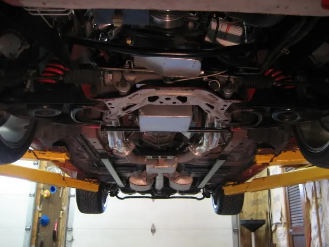

I used BBK oxygen sensor harness extension wires (BBK-1676) with my MAC long tube headers.

depending on what your current set-up is...no change will be required to run long tubes & mid pipe if its OEM. I run Mac longtubes, Mac Prochamber and it all bolts up to my stock mufflers/tailpipes. Just bolt it up and it all fits. Long as you stick with one manafacturer your good. If you have a hacked up system its a different story.
