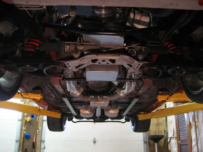

Andy,
What is that in the middle of the exhaust tubes? Looks like a box in place where we usually see the x-pipe.
