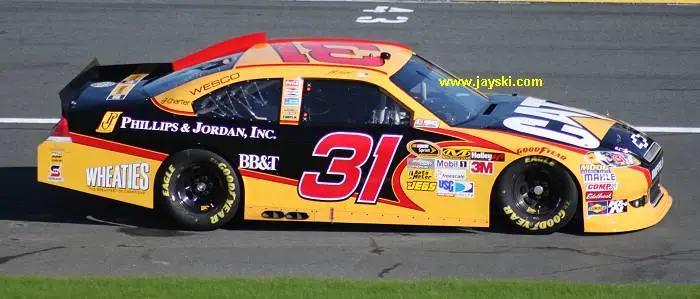

There is a reason why Nascar side skirts are so low. You don't want air under the car.

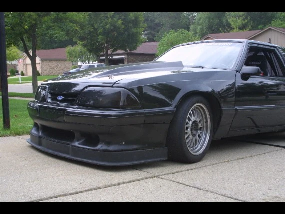

Fox Mustang with an air dam...
There are a lot of ways to add an air dam. It is not uncommon for a road race car.

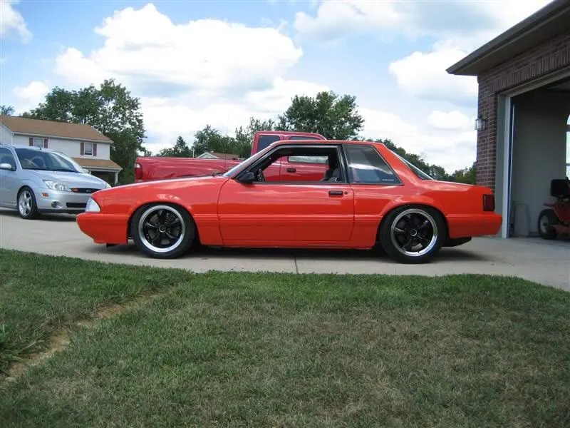

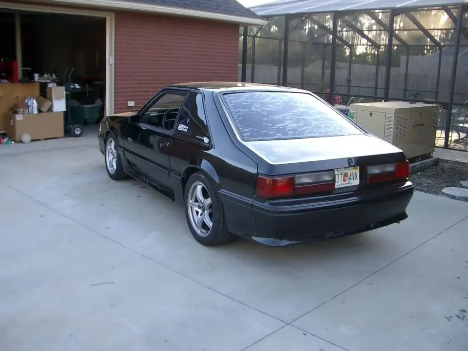

How can you say lowered mustangs are rice
Never said that all lowered mustangs are rice. My personal taste is wings don't go on notches. Street cars that are slammed to the ground that compromise function over form are rice IMO. Fox Body mustangs are inherently not aerodynamic. Adding panels, wings, etc. won't change that to a great extent.
