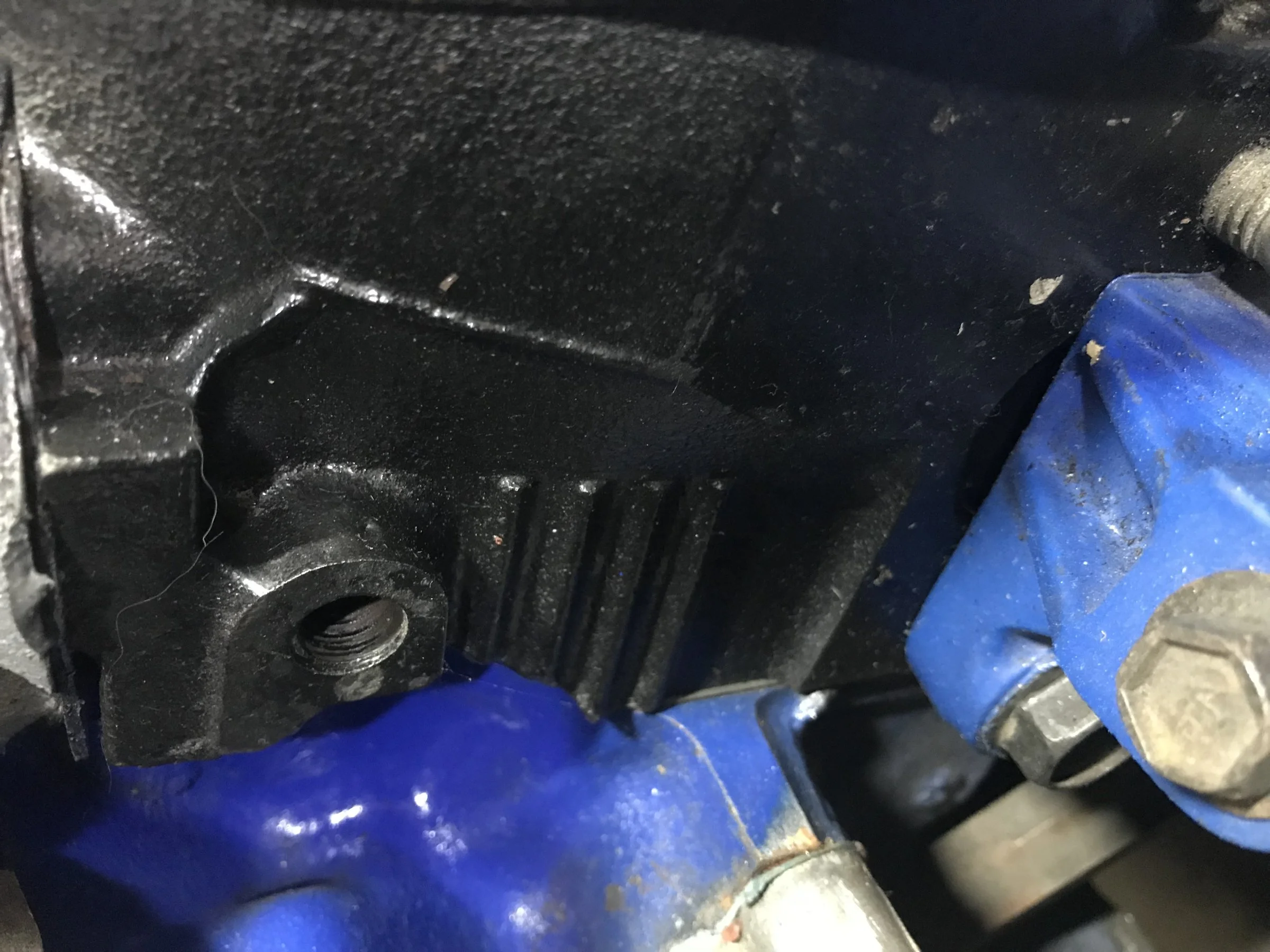

Please tell me I’m NOT the only 68 Coup that missed the Memo on GT40P Heads and headers? What makes this worse is I have the T-5 with clutch cable right in the way of my Sanderson FF3GTS GT40P block huggers that deadend right on top into my clutch cable. I know. Go Hyd. Well I just installed the quadrant and new extra length cable. Fits and works nice. $$$
I’d like to add for someone else out there that the STOCK 90 EFI Headers fit passenger side. I had to grind the flange on the Steering Box side to make it fit. Drove it for a good while like that. As a matter of fact the 90 H pipe fit right in using H pipe hangers at the tranny. Very nice. It did hang a bit low but nothing that created any problems. May have scrapped on 1 speed bump.

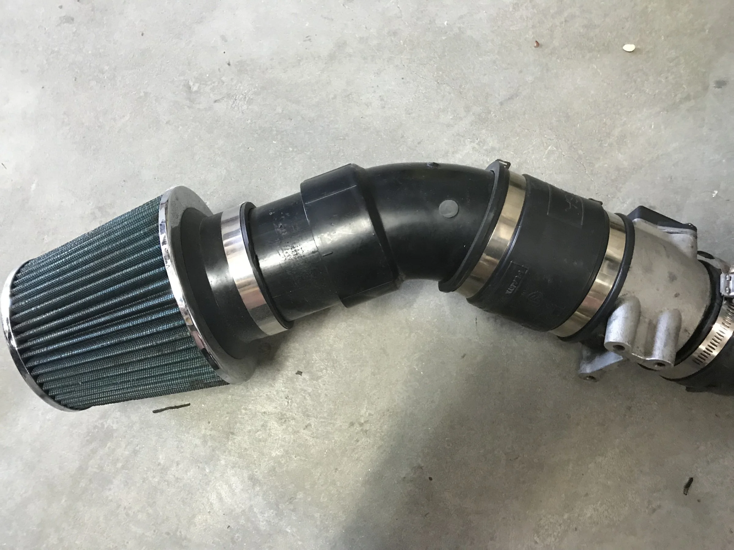

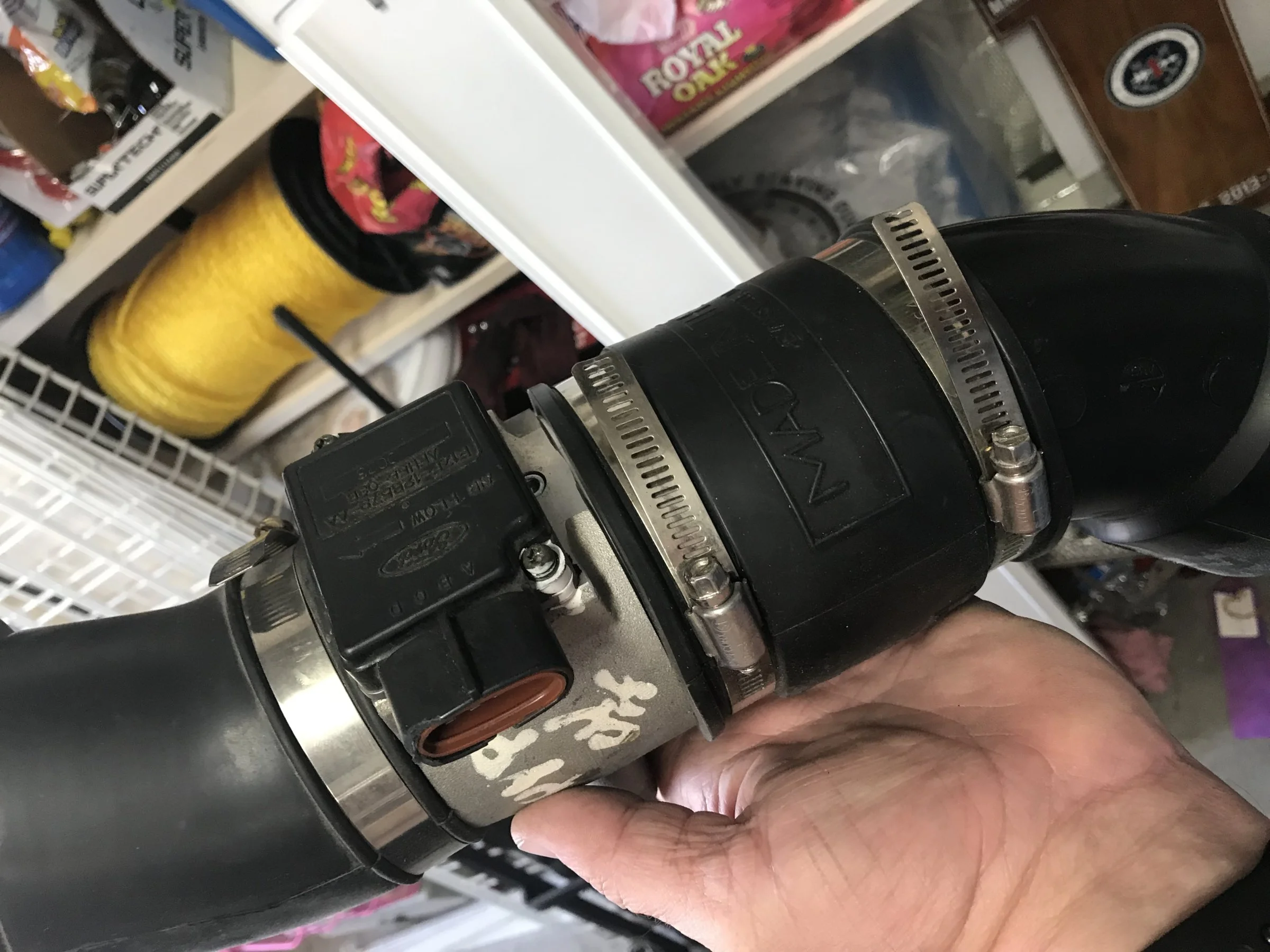

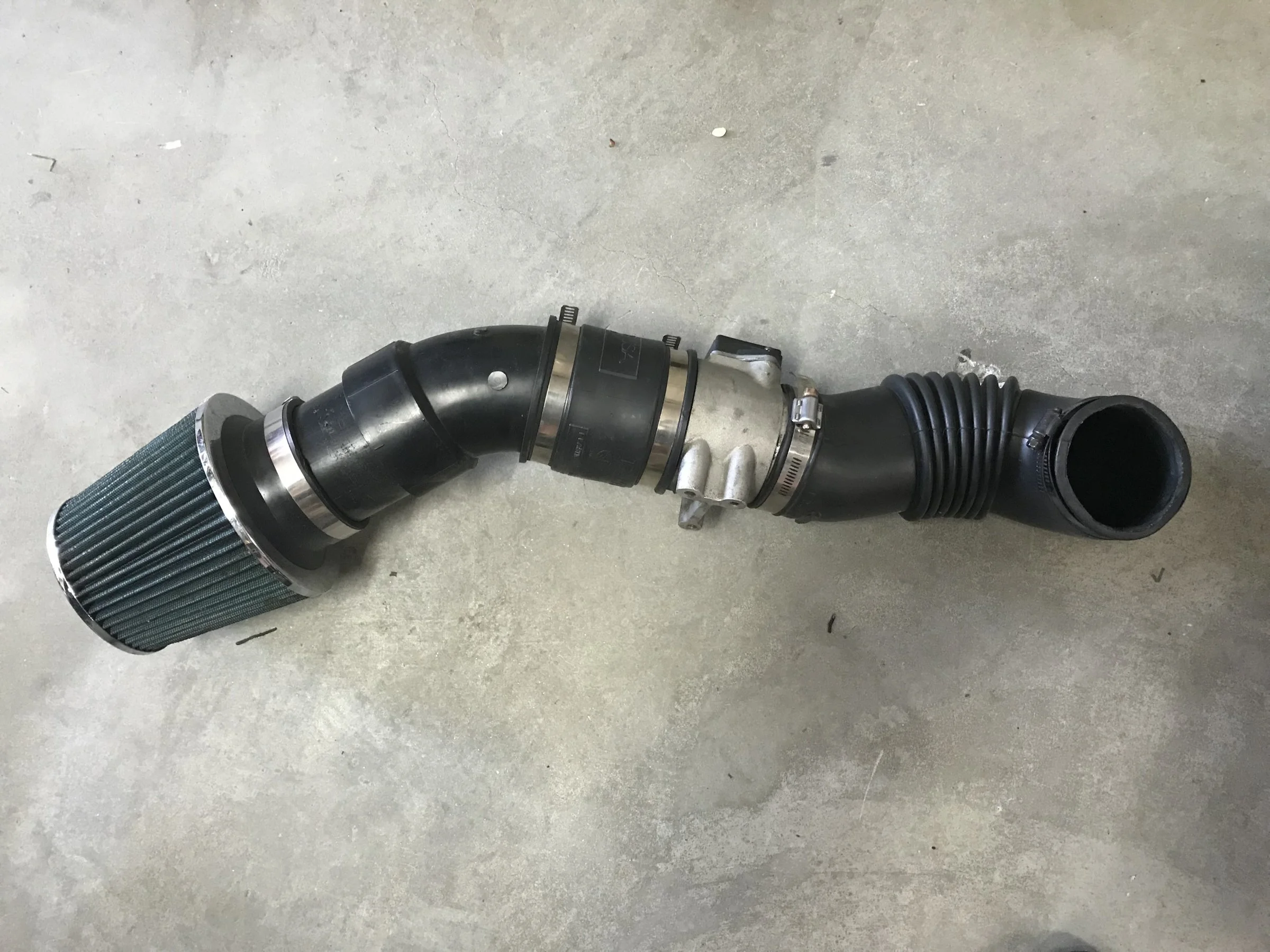

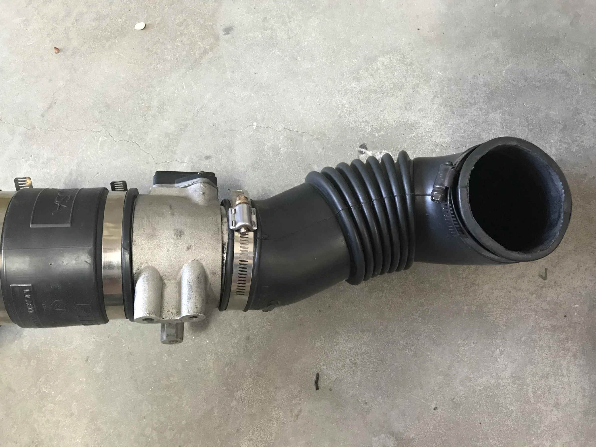

As requested. Full shot of air intake out of car.
Stock 1990 90deg snorkel into Explorer MAF
Ok. Here I get ragged on and maybe why you asked to see my air intake. Good, ok Home Depot is Stang friendly with Chiter supplies!! I took my parts to HD and fit it all up. Got a 45deg and it all clamps up real nice. Good, tight and flexible. I did not use any glue! No need as I have the clamps. So much for keeping it stock.

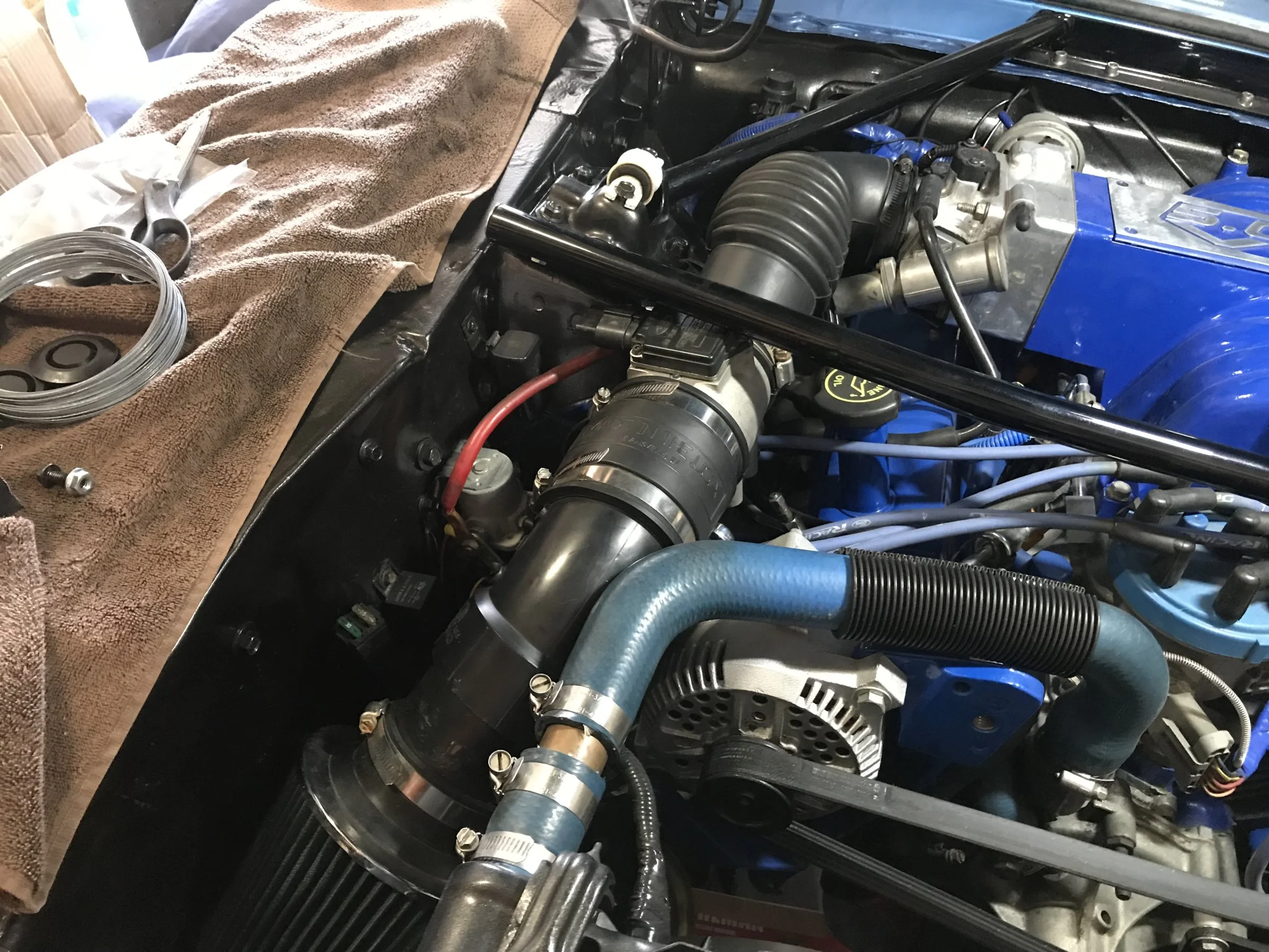

Close up of MAF
She fits ok.
She clears everything with I feel enough flex for engine movement. Engine bay is dirty but we’ll get her detailed when I get that header in. I have many more Picts. Just let me know what yah want.

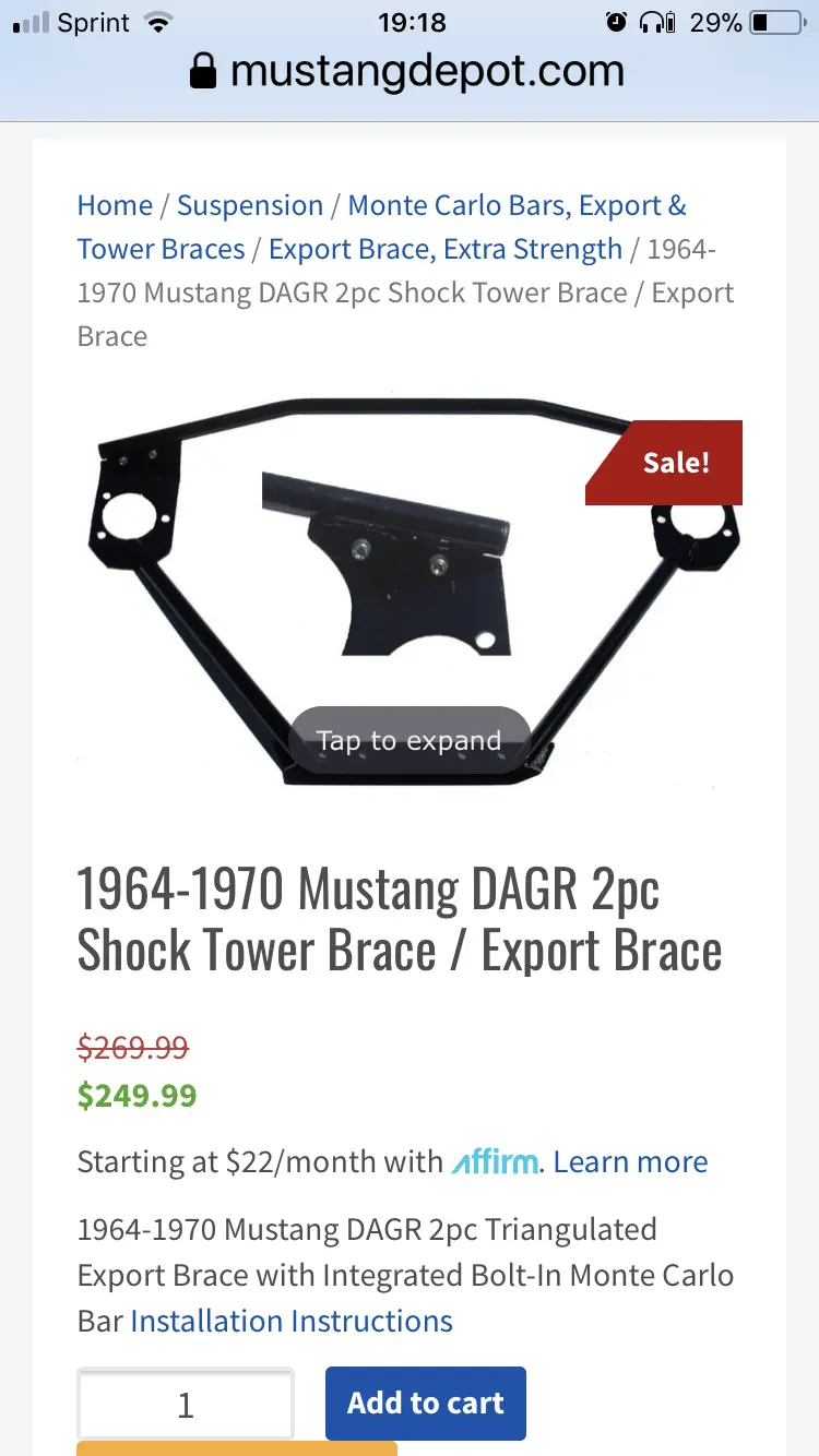

Where did you get the shock tower brace? Did you make it or was it available from somewhere?

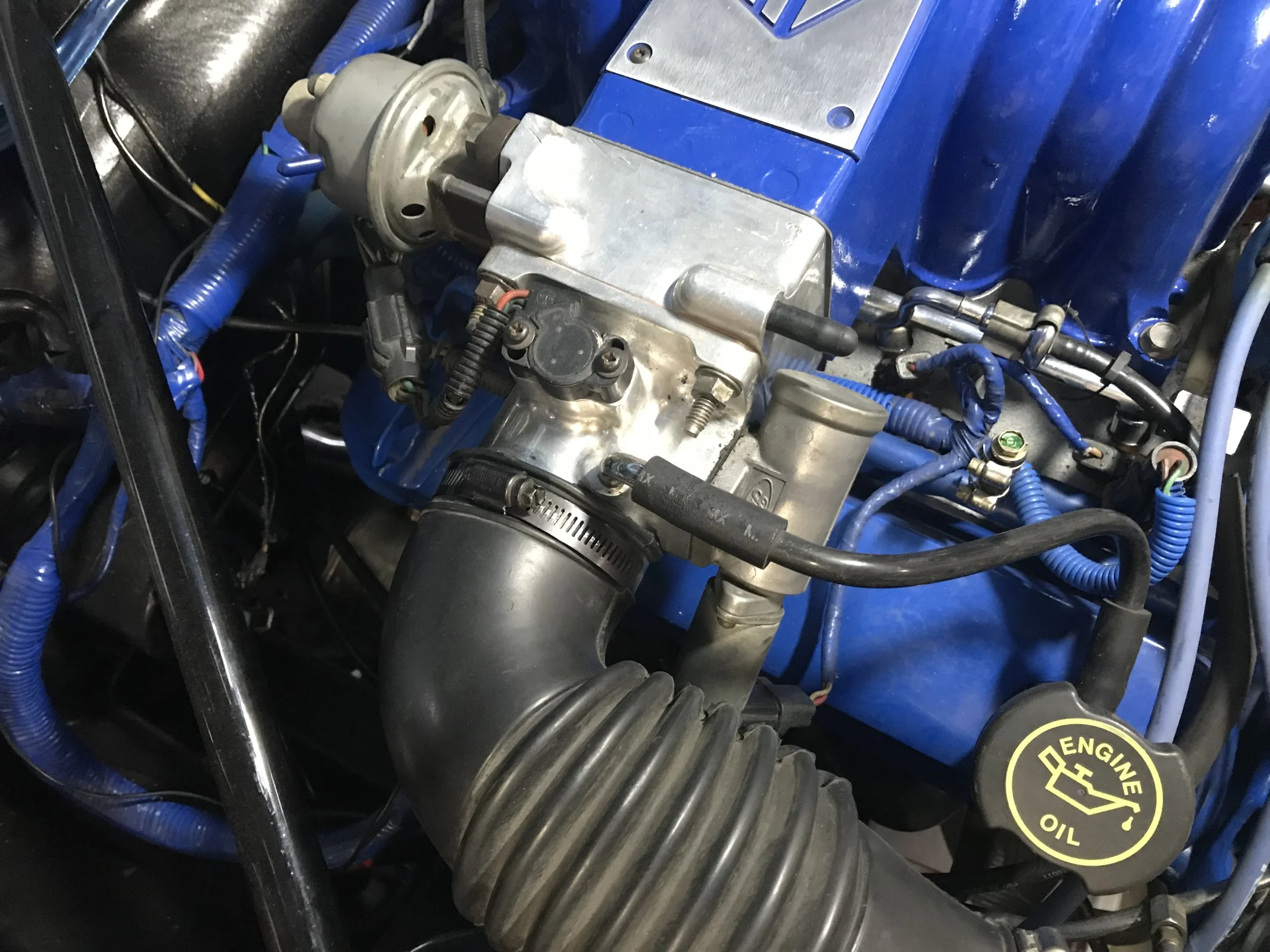

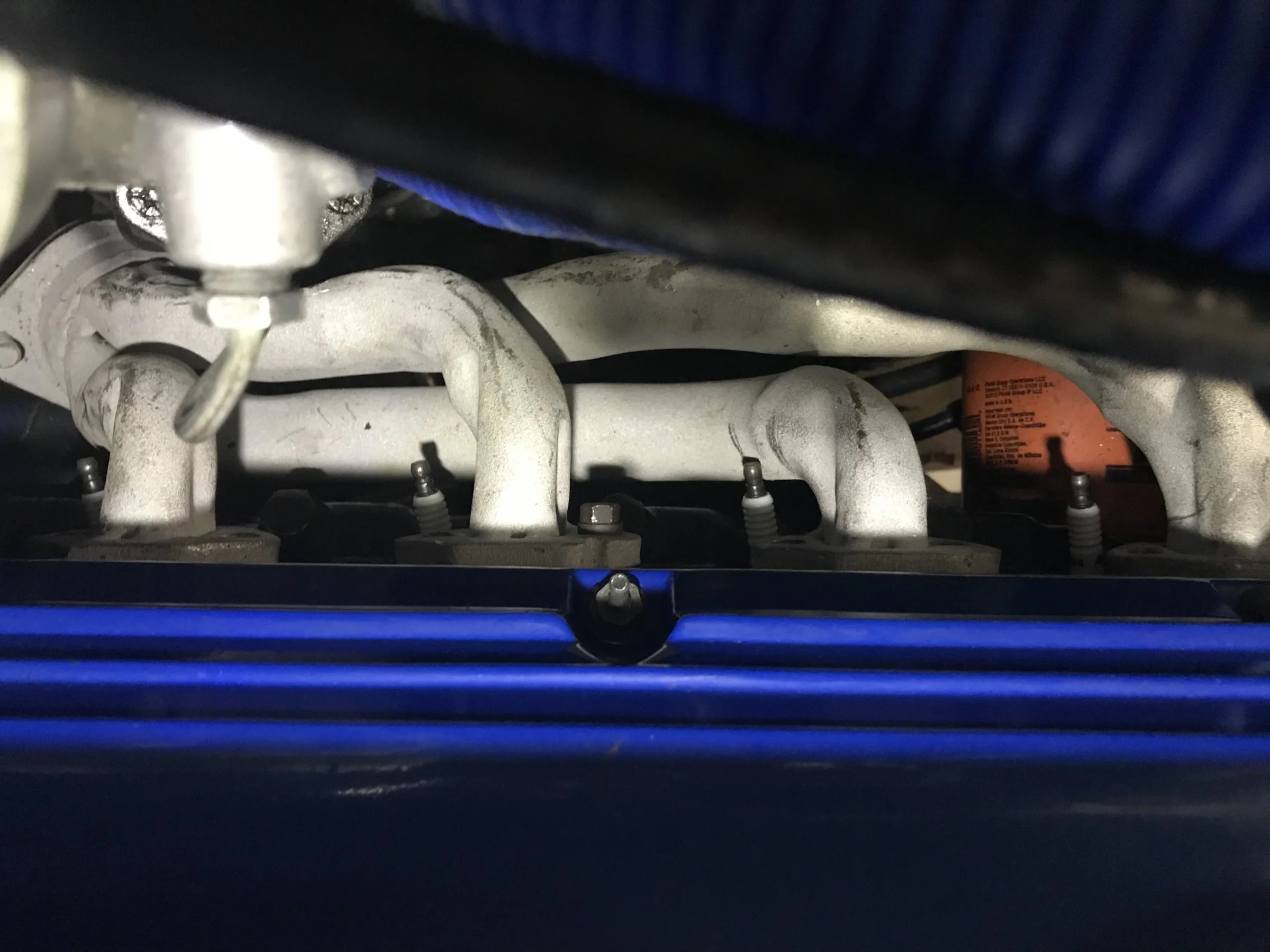

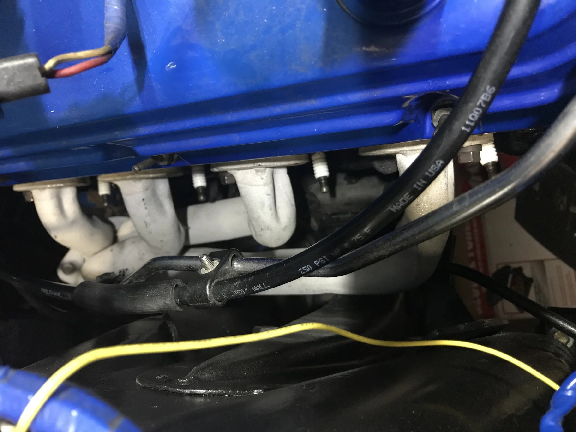

Lol. I love how Rudy’s busting my balls all the time. Lol. That didn’t sound good but hey. Lol. So I never thought of using the stock headers as the are the chocking point for this air pump. Every thought I had was get ride of them and flow this bad boy!! Well here’s some Picts. I believe I can at least get her fired up as my H pipe bolts right up to the headers and to my MAC mufflers. That is while I await the FP LT. Hmmm. What say you guys??
The Shock tower export brave is from Mustang Depot. Get some!!
I love it so far but I’ve not driven with it on. How’s that for Part #s info etc?? Lol. Even on sale!! Lol.

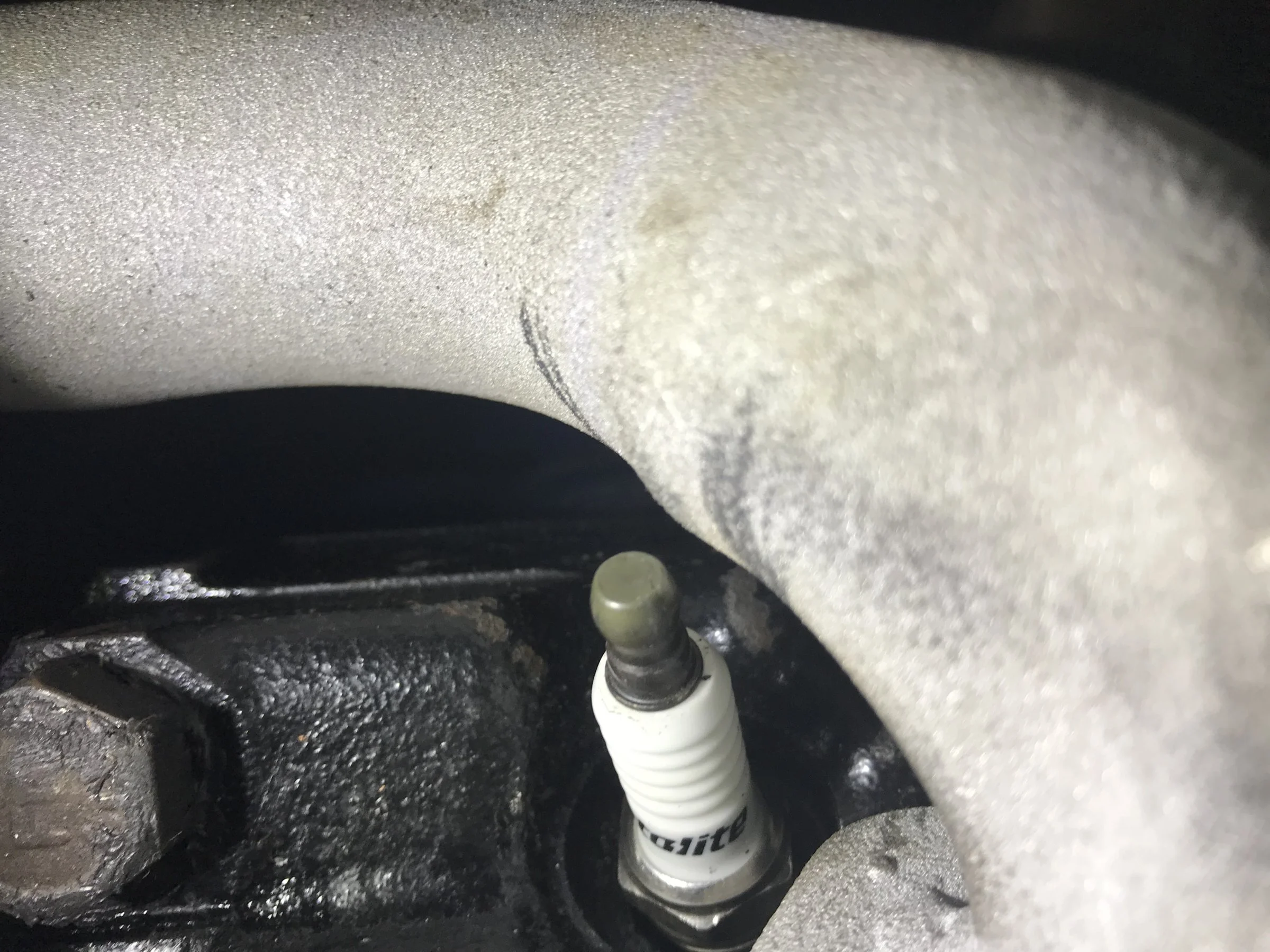

Proof we’re dealing with P heads. Lol

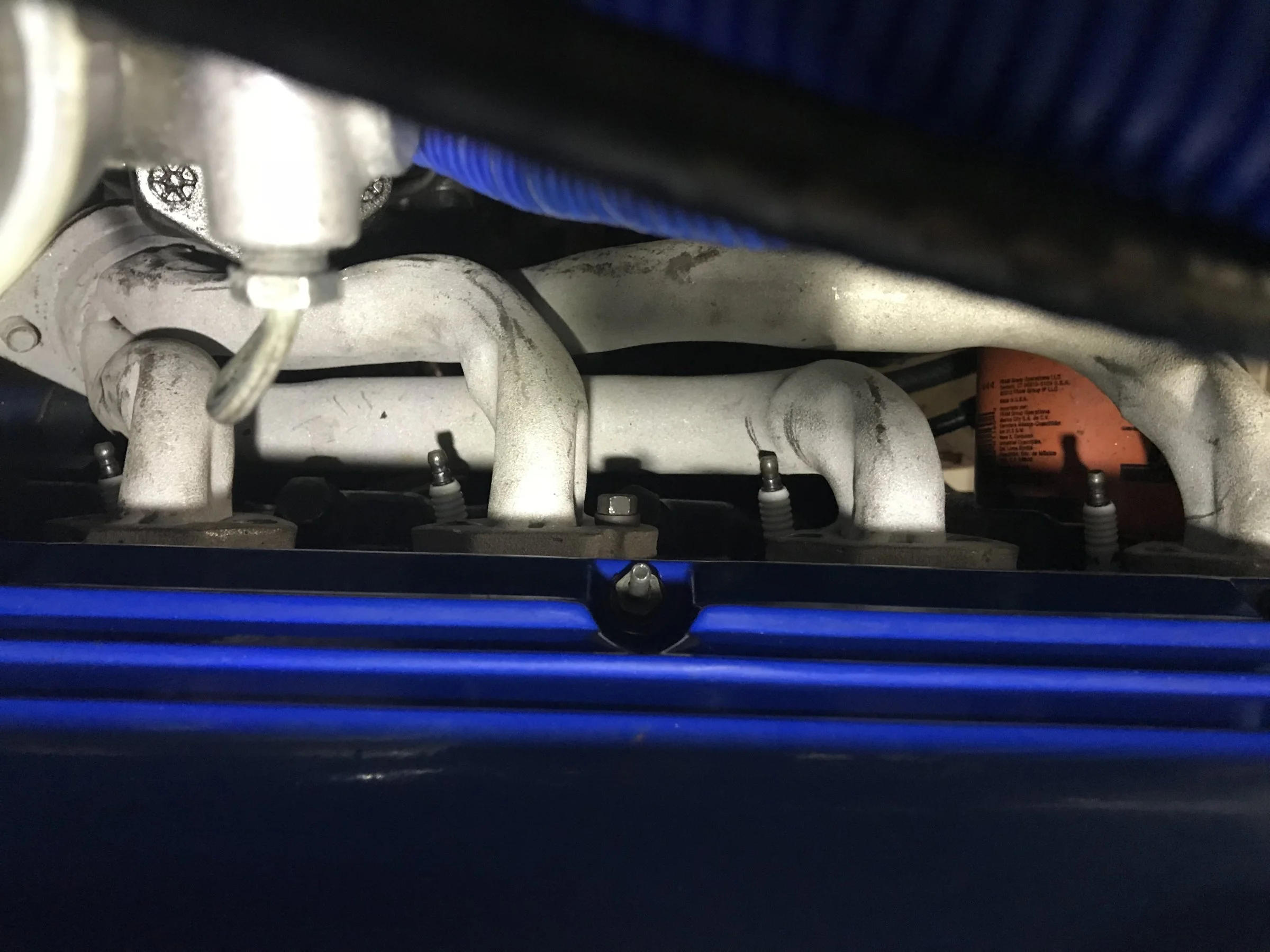

Passenger side stock header. Everything clears real nice!! Of course lots of room with those stock pea shooters.
Passenger side boots on.

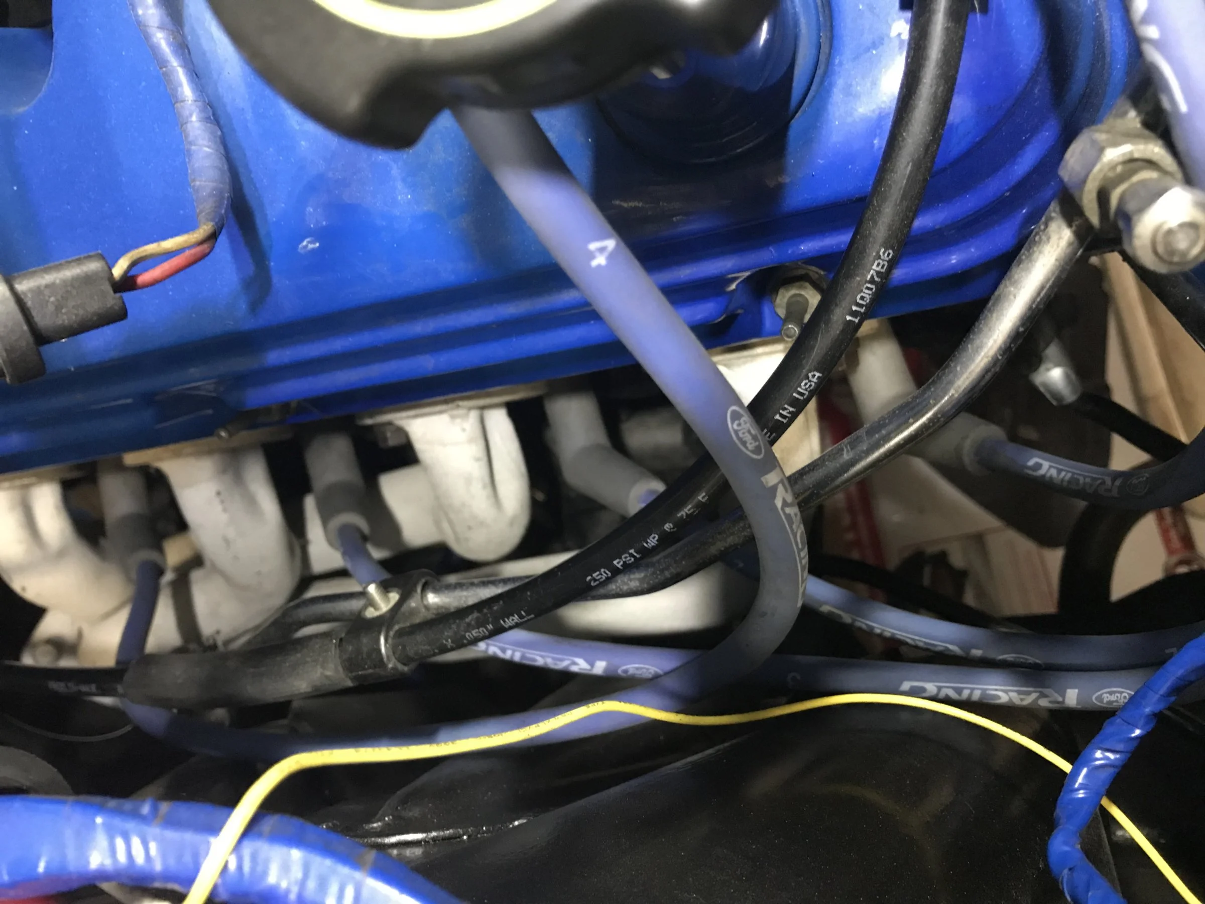

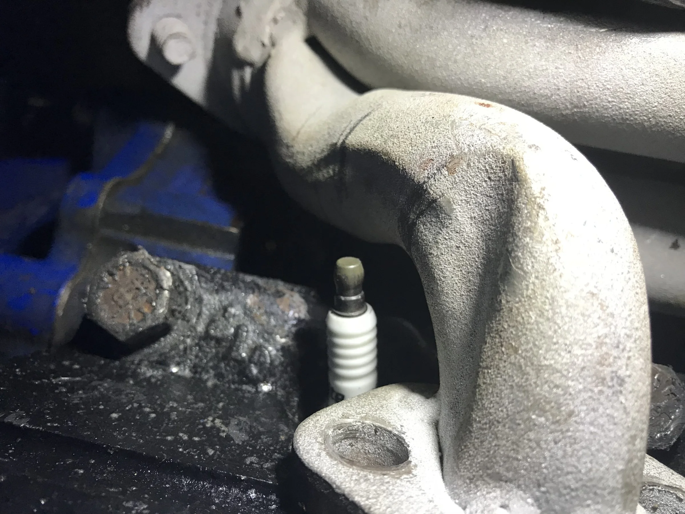

Drivers side or shall I say Problem side!! Lol.

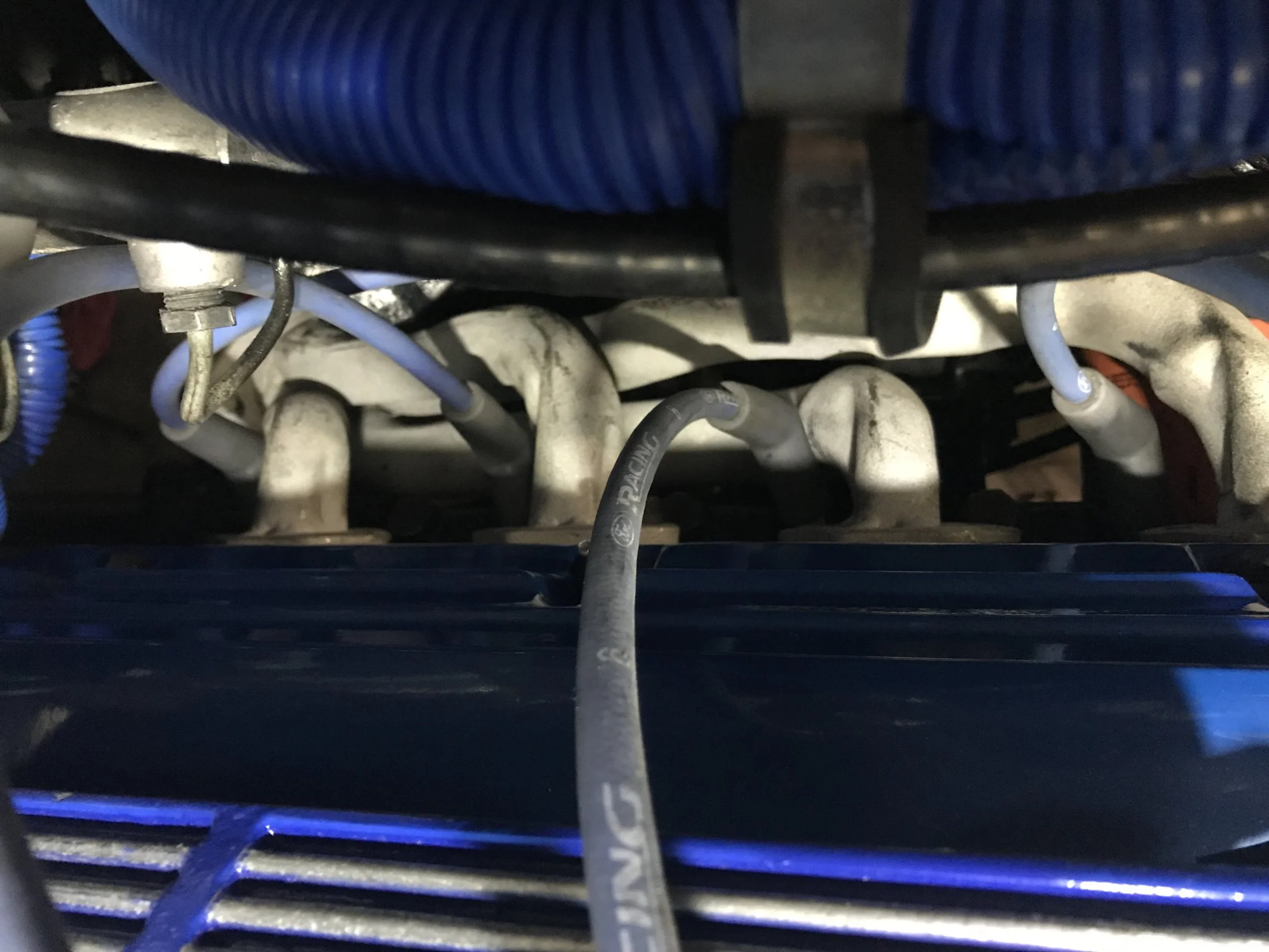

#6 Cyl. Plug wire is all over it!! It’s worth a beating??
Boots on Drivers side. 6&8 Cyl very close. 8 better then 6 with a good smacking she’ll come around.

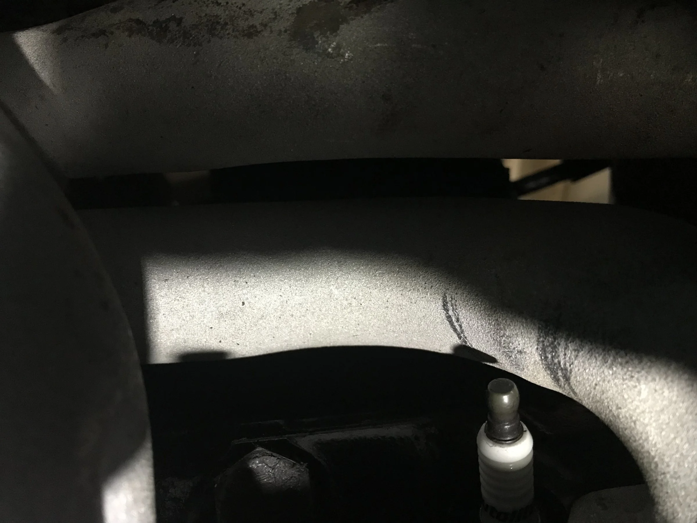

#8 Cyl.
What say you fellas?

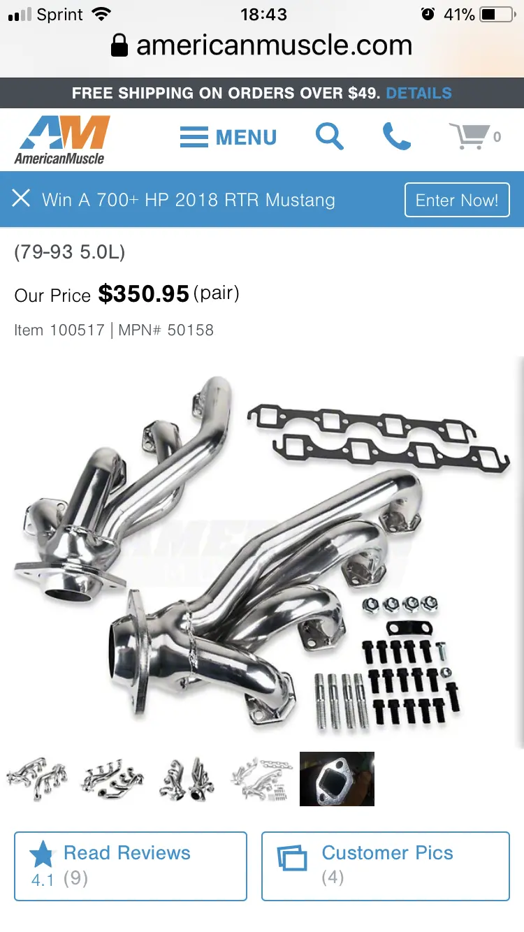

Ok, I searched through the folder and found the info on the mac shorty headers for p's not the LT but I'm pretty sure they were also mac and I'm thinking they were from ebay. At the time I could not find LT's for p's. You want the part number for the shorty's? I doubt they are available anymore.
So I just had a thought, which is dangerous I know. What if instead of using the P heads you used a set of 80s heads... which ones were those? E7TE heads I think? You could have Thumper port them out and they would out flow the P heads and fit your spark plugs. Although if you want to use the P heads it looks like you might have found a set of headers that work and at 350 for the pair, you are WAY cheaper than a head port.
