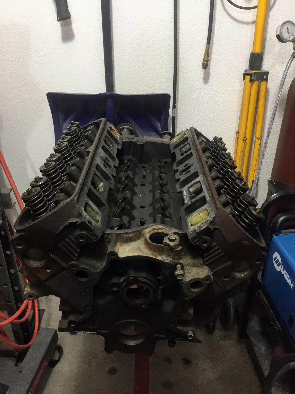

Finally got a pic of it. Doesn't tell me much other than it doesn't look like it's been sitting in the weather... Motor stand comes with it as well! Going to go lay eyes on it tomorrow.
Reactions: 96pushrod
Pull the heads and look at the cylinder bores. I see the crank is gone. Are the pistons out of it too? If so, No way the heads haven’t been off already. Look at the head mating surface and make sure there hasn’t been excessive milling. Also, if he’ll let you, pull some valve springs and check for worn valve guides.
Reactions: jrp27540
Crank and pistons are in a box. Yes, I agree heads have been off. Thanks for the tips!
Well I ended up getting it. Block and heads appeared to be in great shape. He had it covered well. He decided to go with a 351 instead so didn't need it. All the cylinder walls still had visible cross hatching and no noticeable ring ridge by feel. Didn't see any cracks or dings on surface mating surfaces. He also didn't end up having the internals/rotating assembly or lifters...but I was OK with that... The only issue I could find was a broken intake bolt in the head. Motor stand is in great shape to ;)
