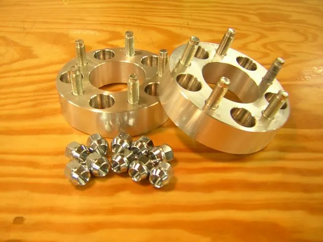

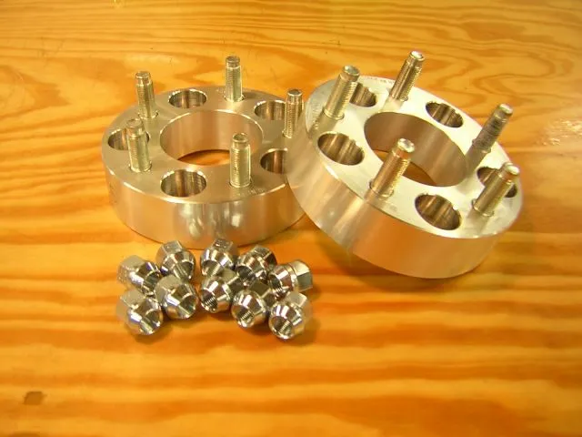

There, however, are some wheel spacers that come with studs and lugnuts of their own so all you have to do is bolt them on your stock studs and then bolt the wheel over those. The downside is that those spaces are usually relatively thick so unless you're running some kind of heavy staggered setup, or spacers in the rear as well, your front wheels might stick out more which looks rather goofy.
here's an example:
