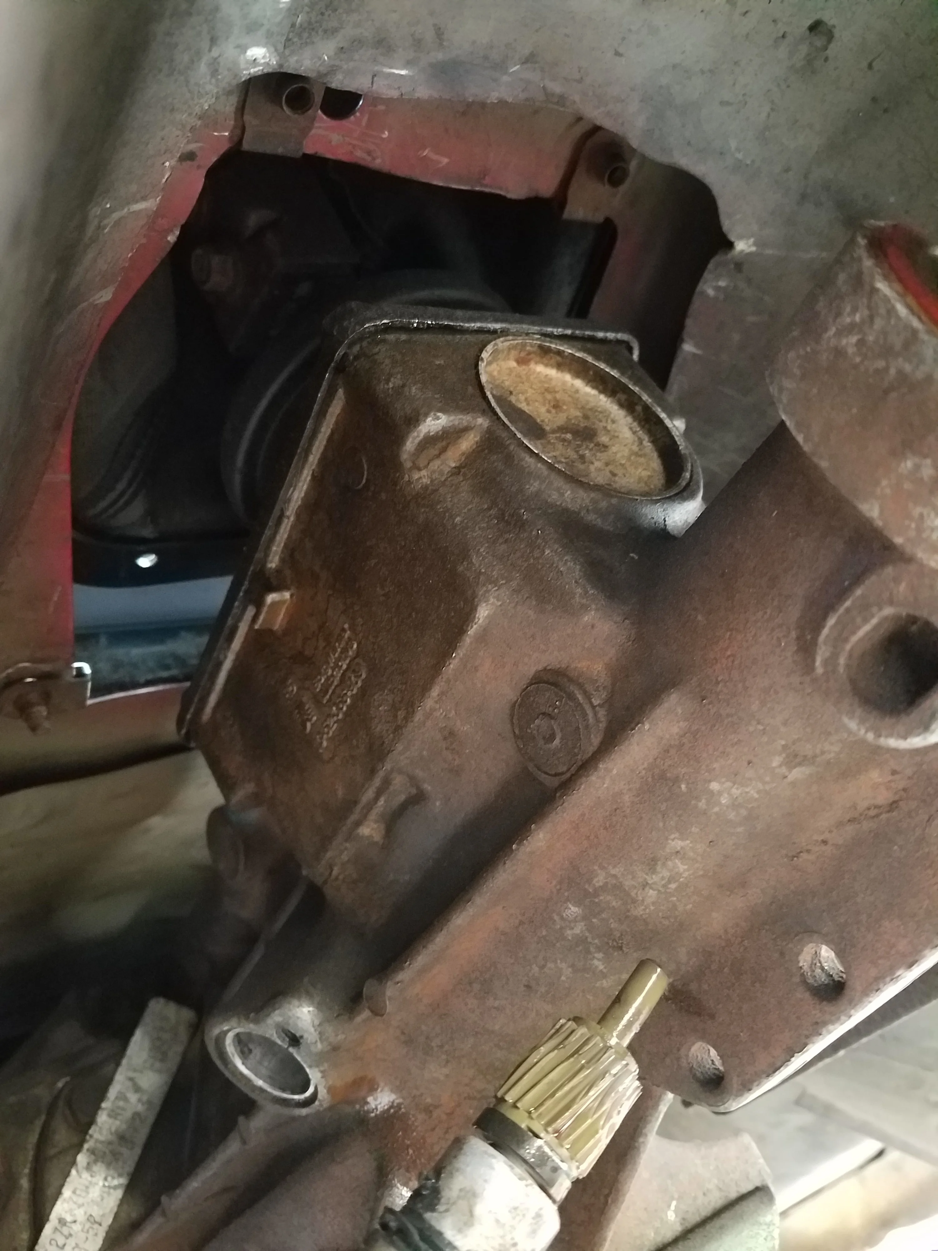

Got the A/C fixed. The knob had cracked and wasn't actually turning the temperature control cable. Swapped the knob with the blower and works great! Installed the correct 21 tooth speedo gear and now have a working speedometer. Picture is of the old one which appears to be out of an auto trans?

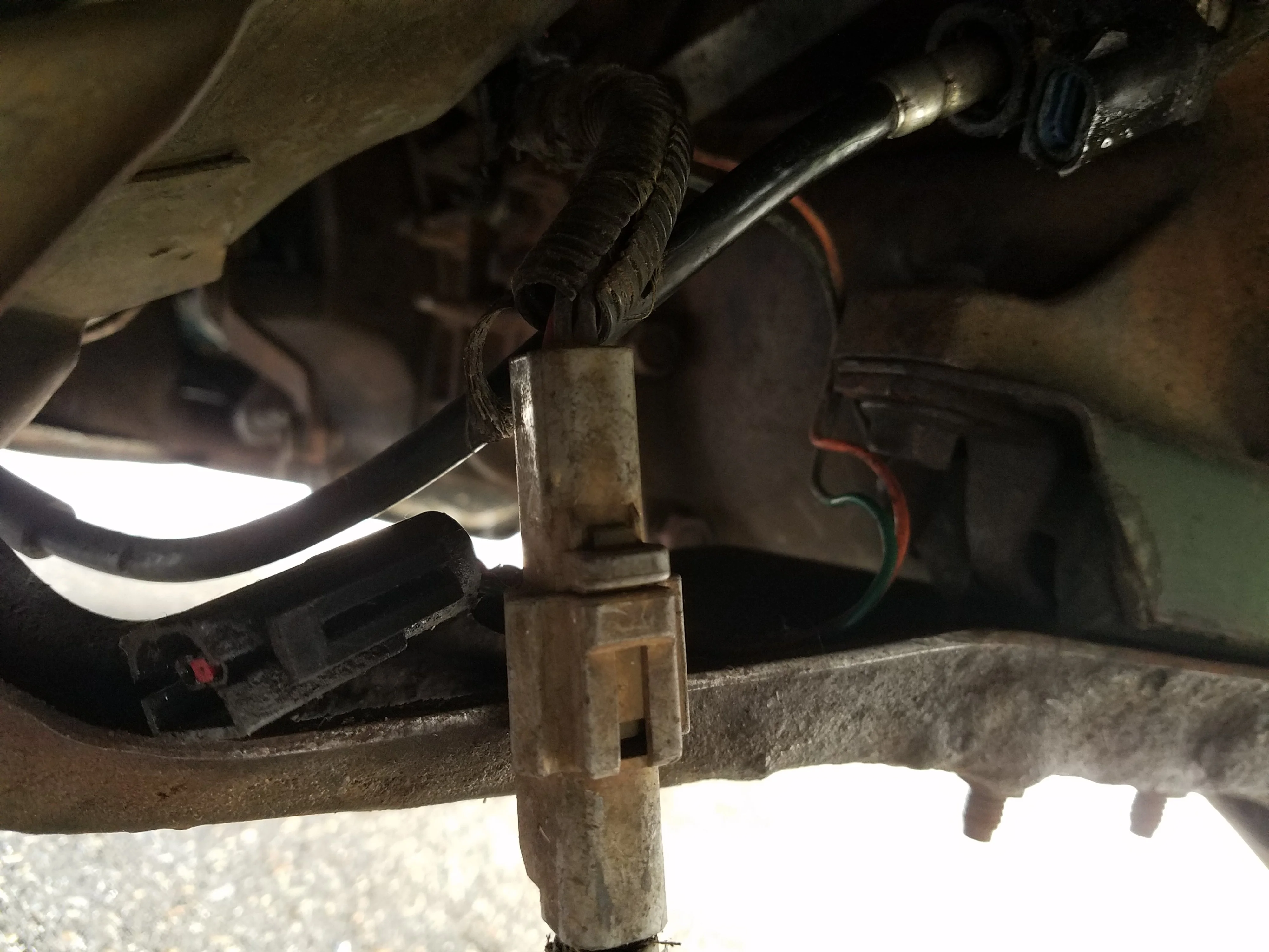

While under I noticed there is an extra plug attached to the vehicle speed sensor harness, anyone know what that is for? See picture below.

I bought an AGR 15:1 rack but it has yet to come in. Also, inner shift boot has been replaced which helped alot with rd noise. The clutch boot on the 2.3l is actually a boot, 5.0 is the metal cover. Still no idea what that plug by the speedo sensor is?

The plug by your speedo sensor is for the cruise control. I saw the wiring connection for it laying on the transmission cross member in one of your other pictures.

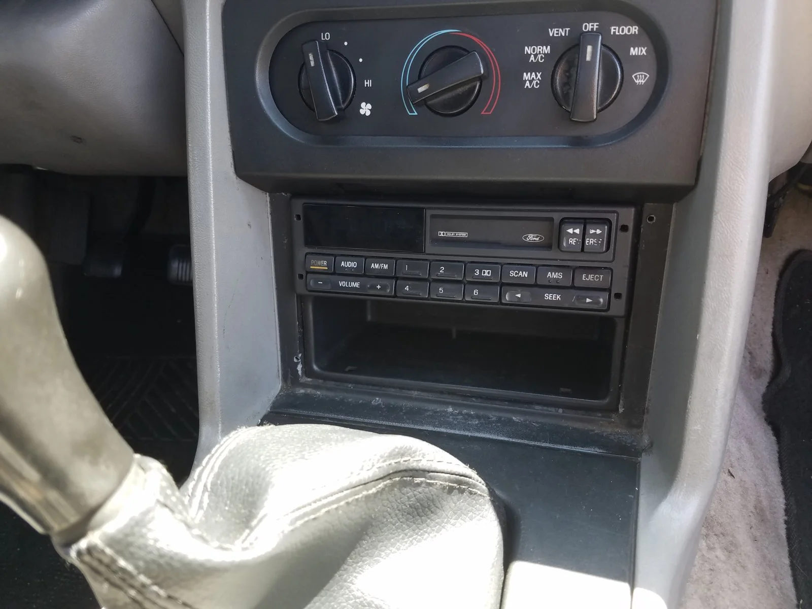

Got a factory radio from the junk yard and installed it. Took a while to figure out where the plugs to by pass the premium audio amp were but eventually got it.

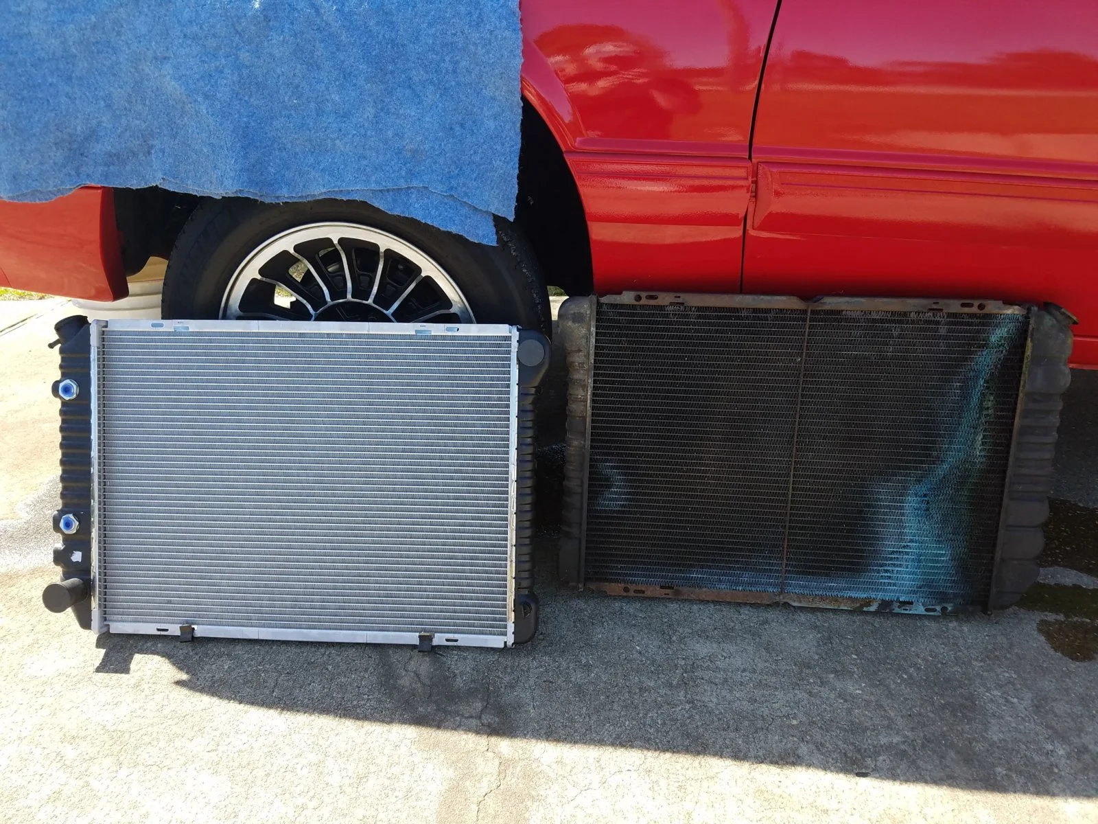

New radiator installed as the old one had sprung a bad leak.

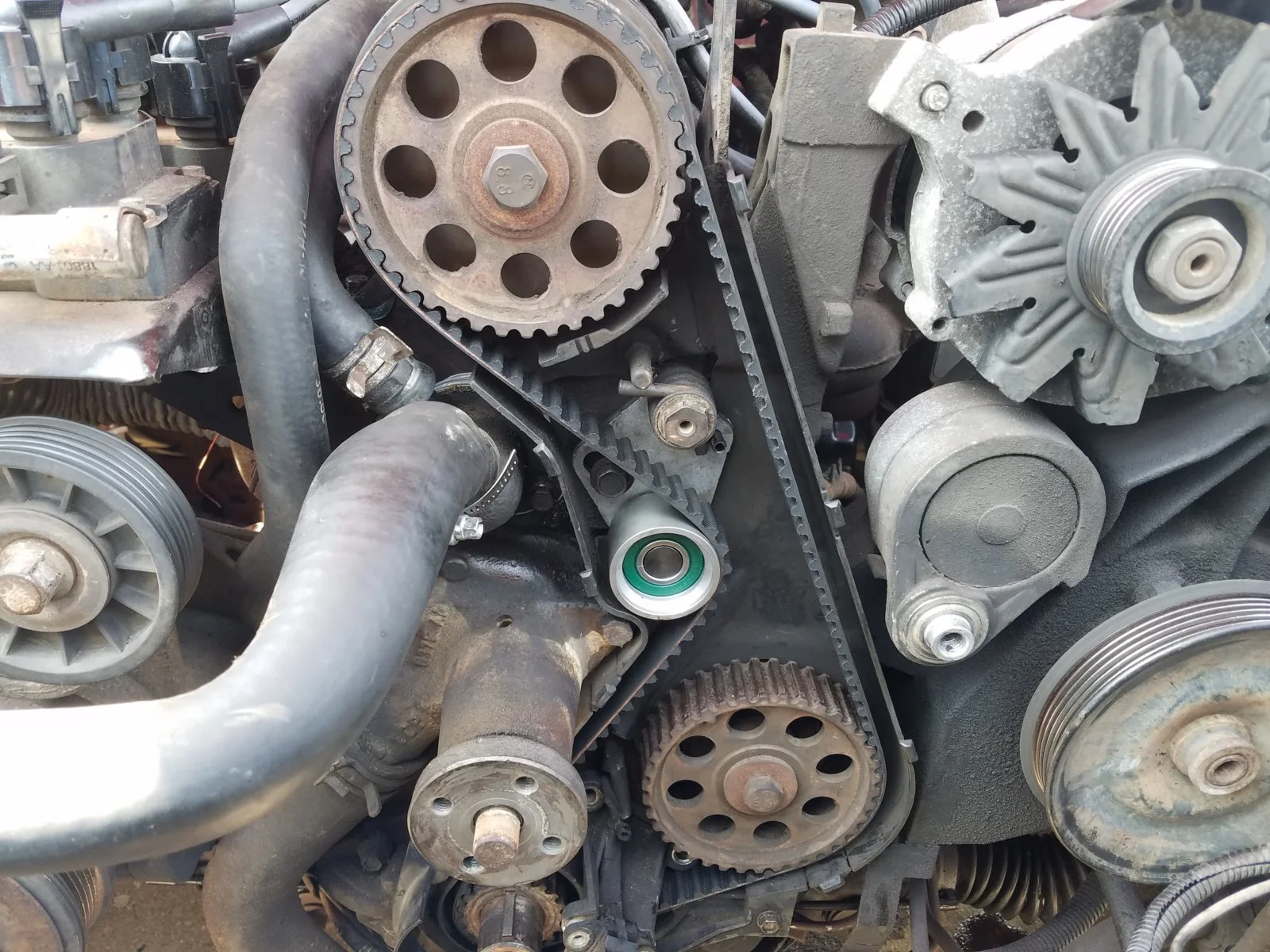

Timing belt installed too as I was worried it had jumped a tooth. It hadnt, but still glad I did it. On this engine the harmonic balancer was pressed on and I needed a puller just fyi because I've seen some that slide off.

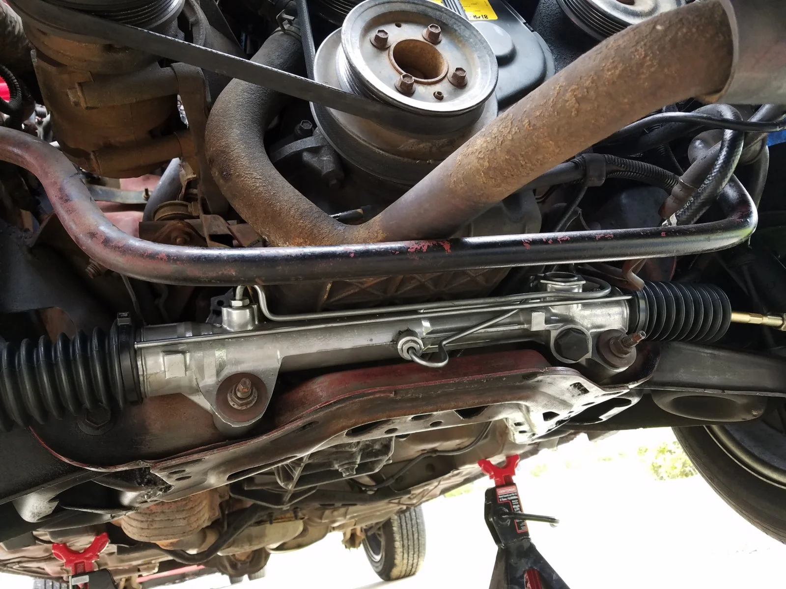

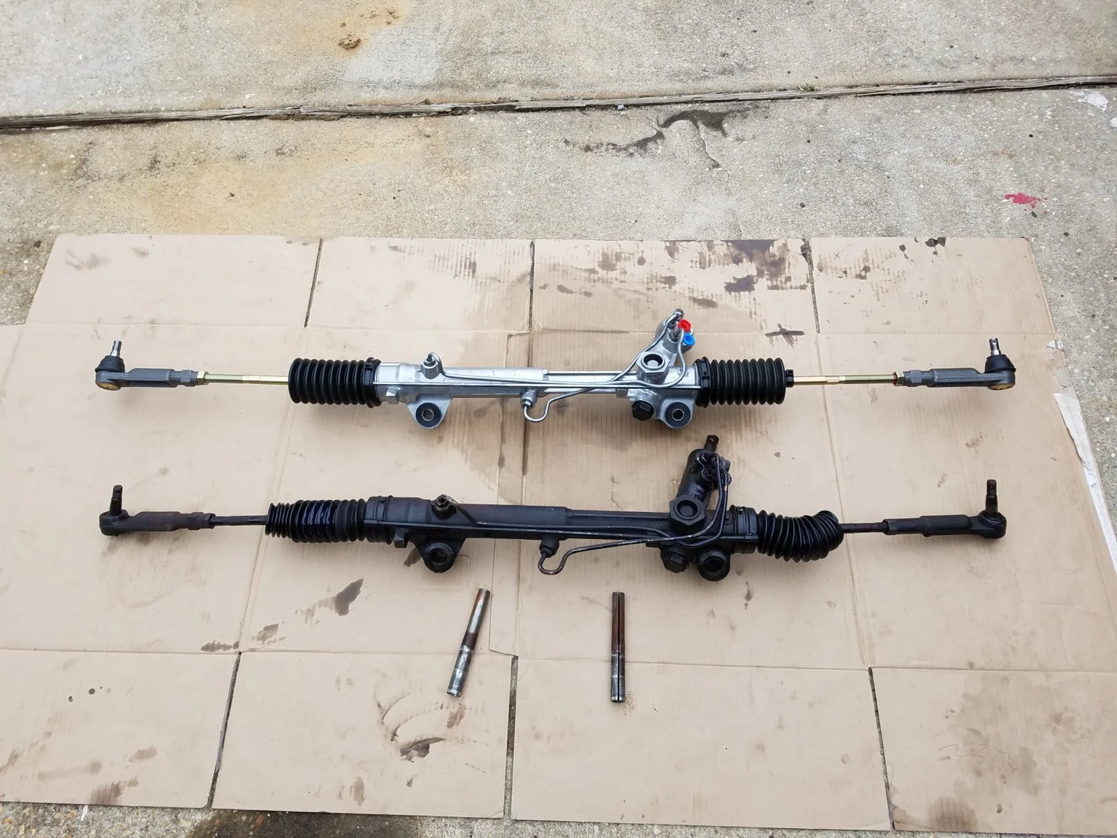

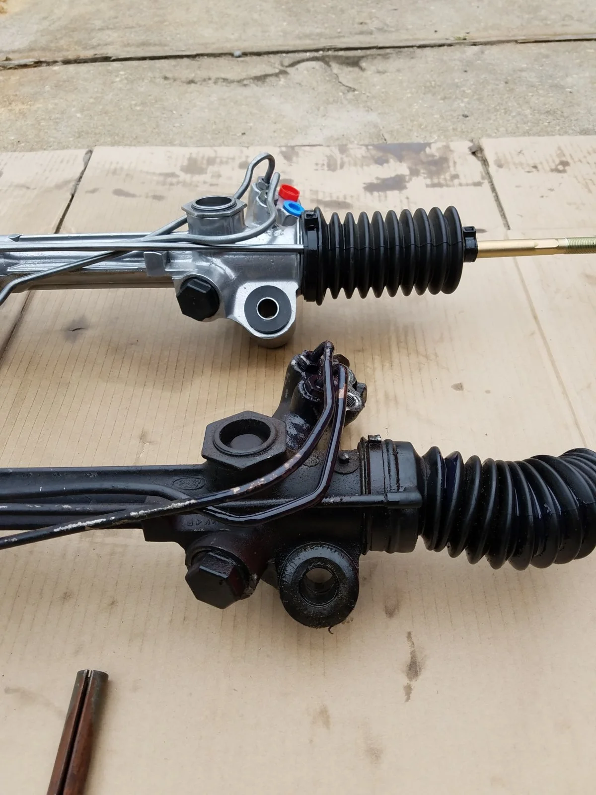

Finally more good news. Got the AGR rack installed. First impressions, packaged really well but one pressure line was slightly bent from shipping, easy fix. Came with nylon rings for the fittings. Got new MOOG outer tierod ends too. The bushings that came with didn't fit the compression sleeves or bolts so I removed them and used only the sleeves.
Fit like a dream and drives amazing. 2.5 turns lock to lock and extremely responsive. Force to turn is lighter than stock but very firm and quick. Love it! Great upgrade.
