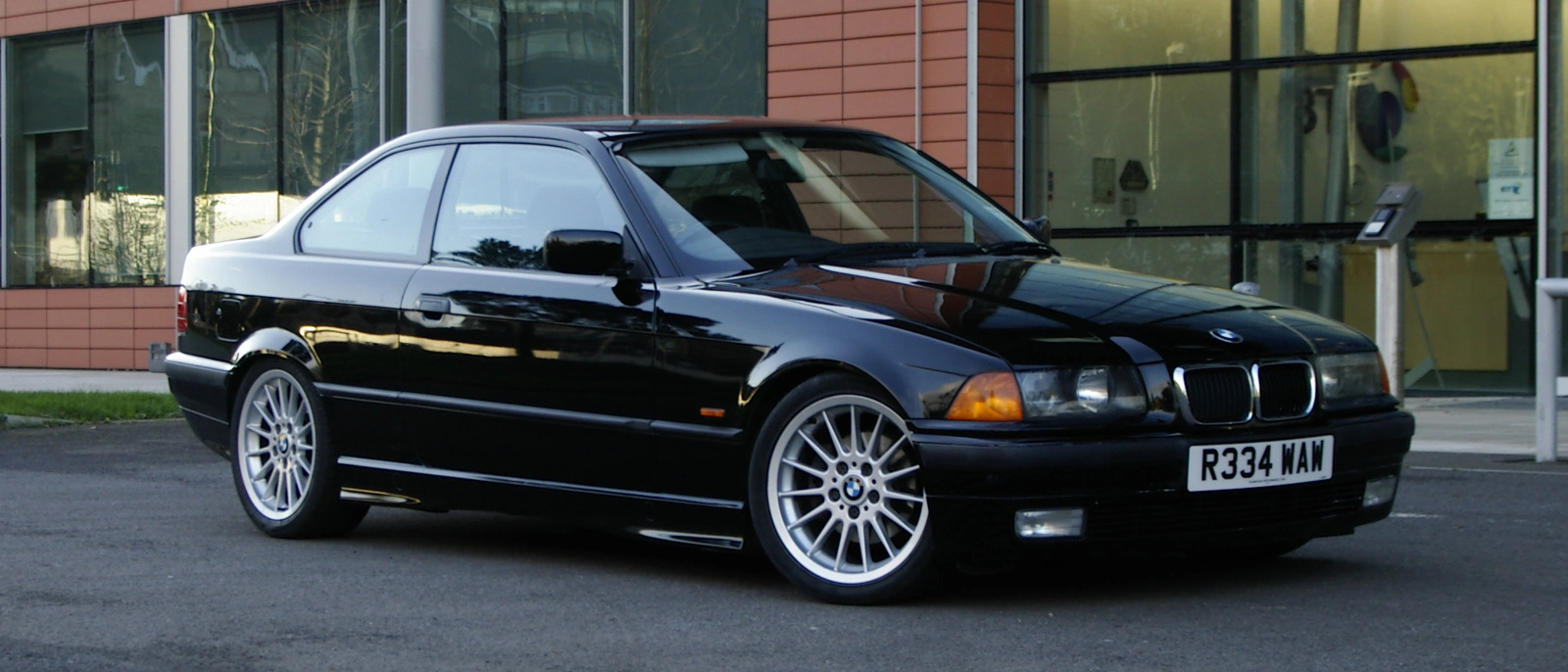

Ok, so I'm building a 5.0 for an e36 swap project. I bought a mountaineer engine that supposedly had 76k on it. Opened it up and it didn't look great. Combustion chambers had ALOT of carbon in them. I ended up coming across a new sportsman B50 block for a decent price. So I bought it and thats what ill be using. I'm now piecing my build components together.
