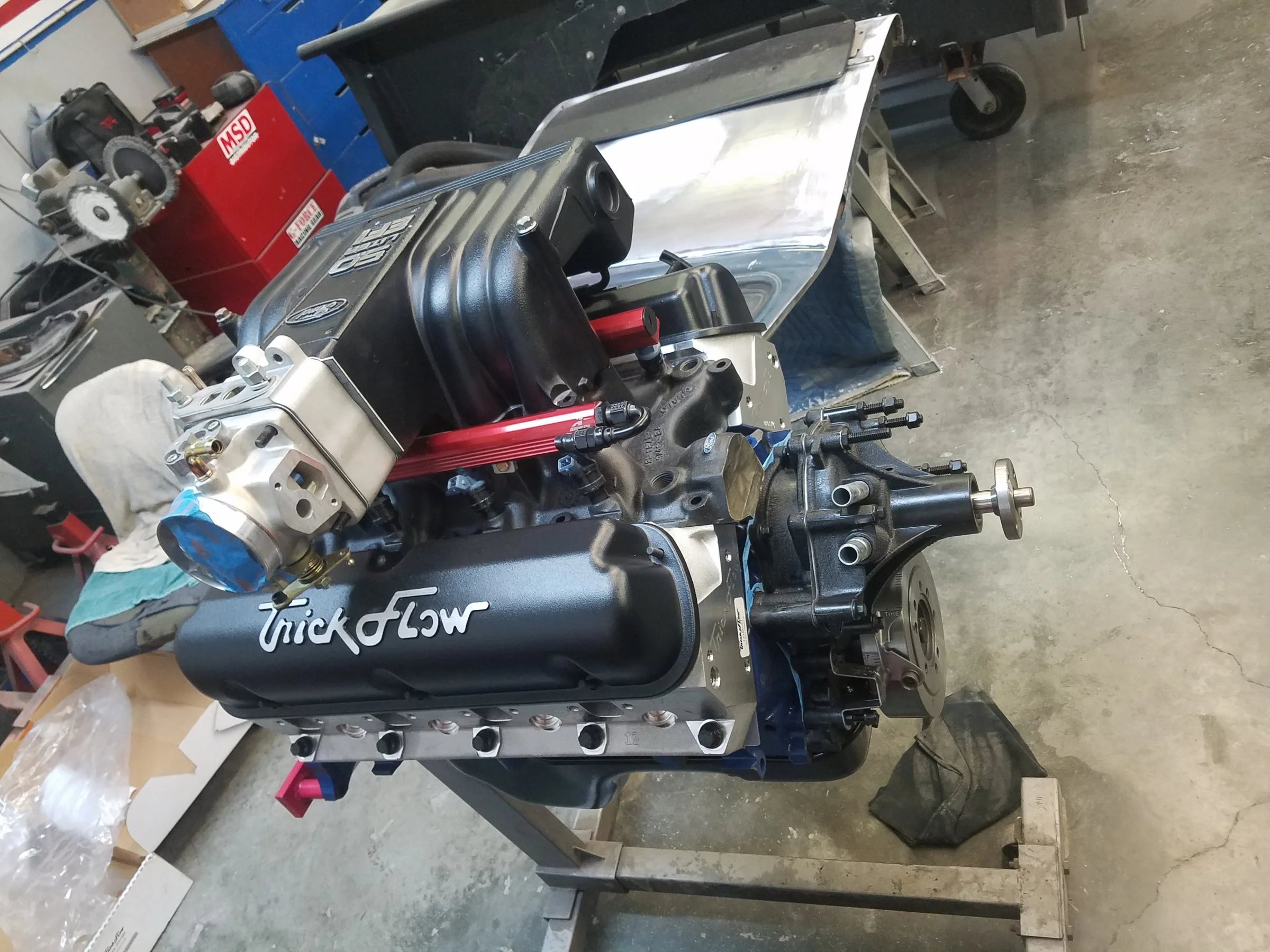

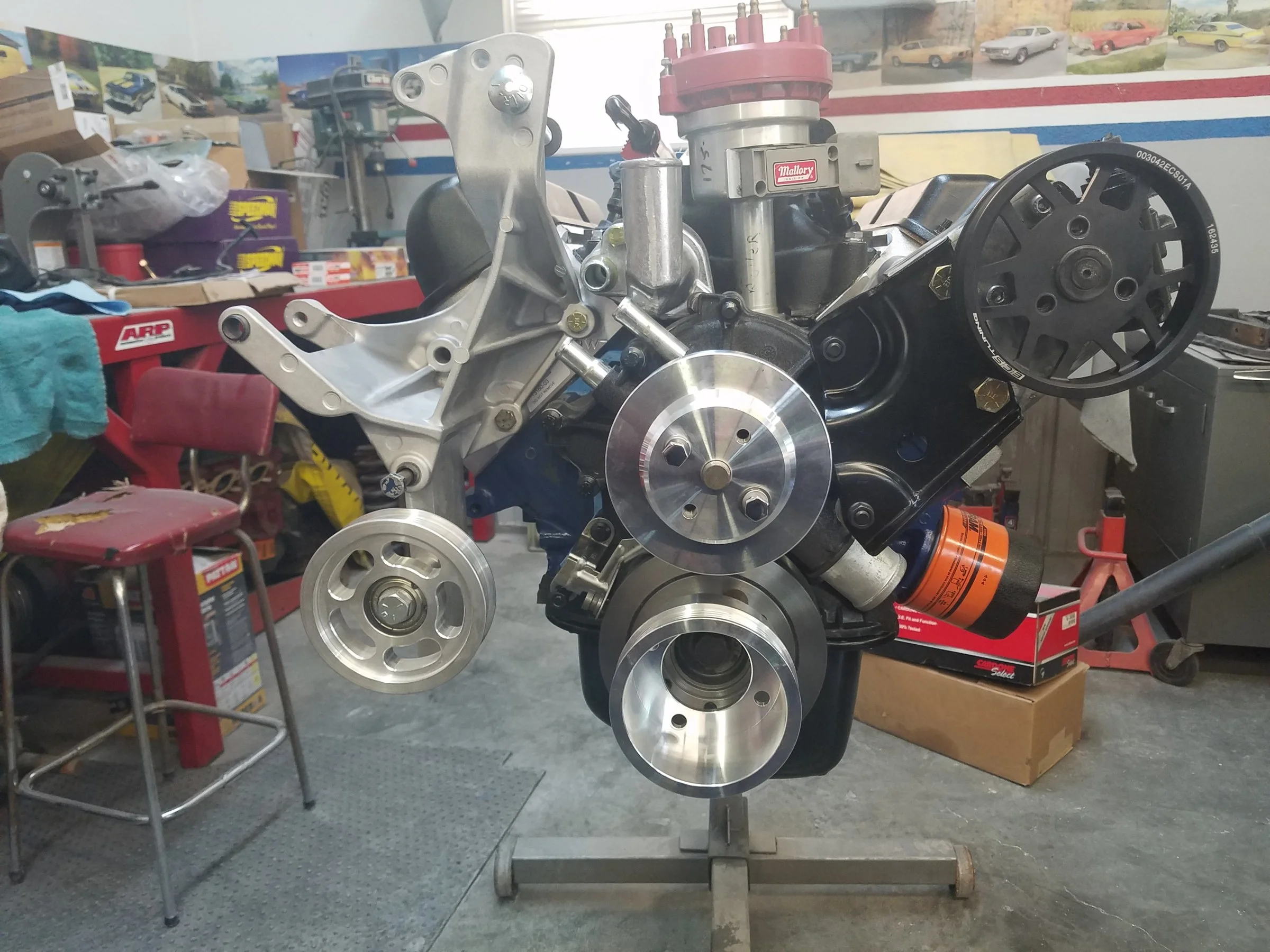

May 13, 2017
#25
  • May 13, 2017
  • #25
Reactions: a91what, RaggedGT, Davedacarpainter and 1 other person

The engine looks great!
If you don't mind me asking, how much did you pay for the B50 block? Those things are impossible to find nowadays and usually have been subjected to lots of power.
I paid $800. Still brand new, never ran with stock bore. Also had the bottom end studed already. I'm honestly not sure what the going rate is for them now, but I feel like I did ok on it. And thanks a lot of work has gone into building from a bare block.
