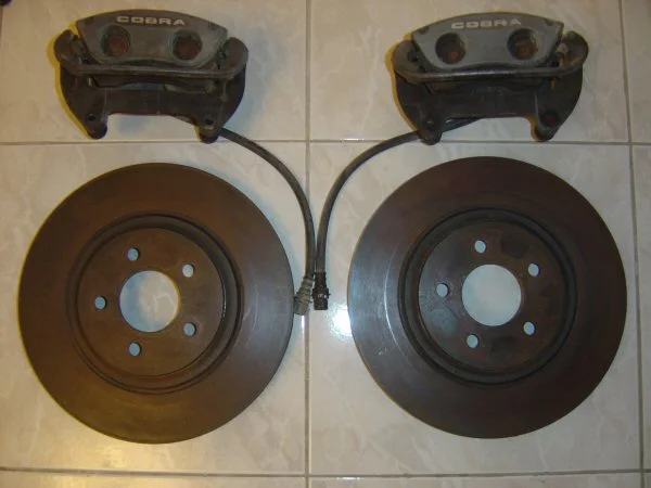

I'm in the same boat and I sourced my front brake kit from a '98 Cobra for just $163. The pads were like new and the rotors only had flash rust that I easily cleaned off.
From what I've read, you can keep the stock GT master cylinder and proportioning valve so that's what I'll be doing.

Well, I've had the Cobra 13" front brake conversion done on my Stang and I can say it's absolutely fantastic. The pedal is firmer, more responsive, and it feels like the Stang can stop on a dime. It certainly inspires more confidence than when it had the stock brakes. This is one mod I'd highly recommend on any SN95 V6 or GT.
I used the rotors, calipers, brackets, hoses, and pads from a '98 Cobra as shown in the pic below:
I also weighed the components and compared them to the stock GT items:
Stock front brake calipers, brackets, lines, & pads: 25lb
'94-'98 Cobra PBR front brake calipers, brackets, lines, & pads: 16lb
Stock 10.8" front brake rotors: 22lb
'94-'98 Cobra 13" front brake rotors: 33lb
Overall there's a tiny 2lb weight gain. If you decide to do a '99-'04 GT PBR front brake caliper conversion instead, there's a 9lb weight saving but the stopping power won't be quite as good.
