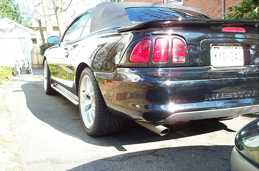

wms004 said:
265/35 front and 285/35 rear would be perfect. 295/35 out back has rubbing issues when you are lowered especially with bfg's. Just know that 285/35 will effect your speedo slightly
-wade
that is exactly what i have and i think they are just right.
lowered 2"
18x9 fr500s
