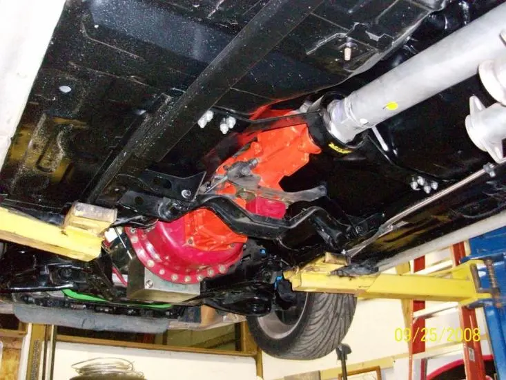

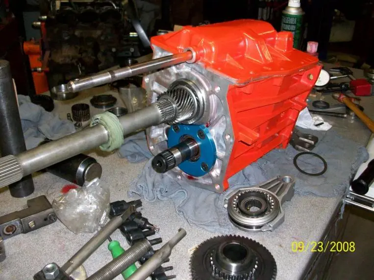

Yes, Astroperformance is the best place to get rebuild kits for the T-5, and if you have the cheese, go with the A-5 kit. Tony@Astroperformance is very good to deal with and hes a straight shooter, got the parts for mine from them and very satisfied.
