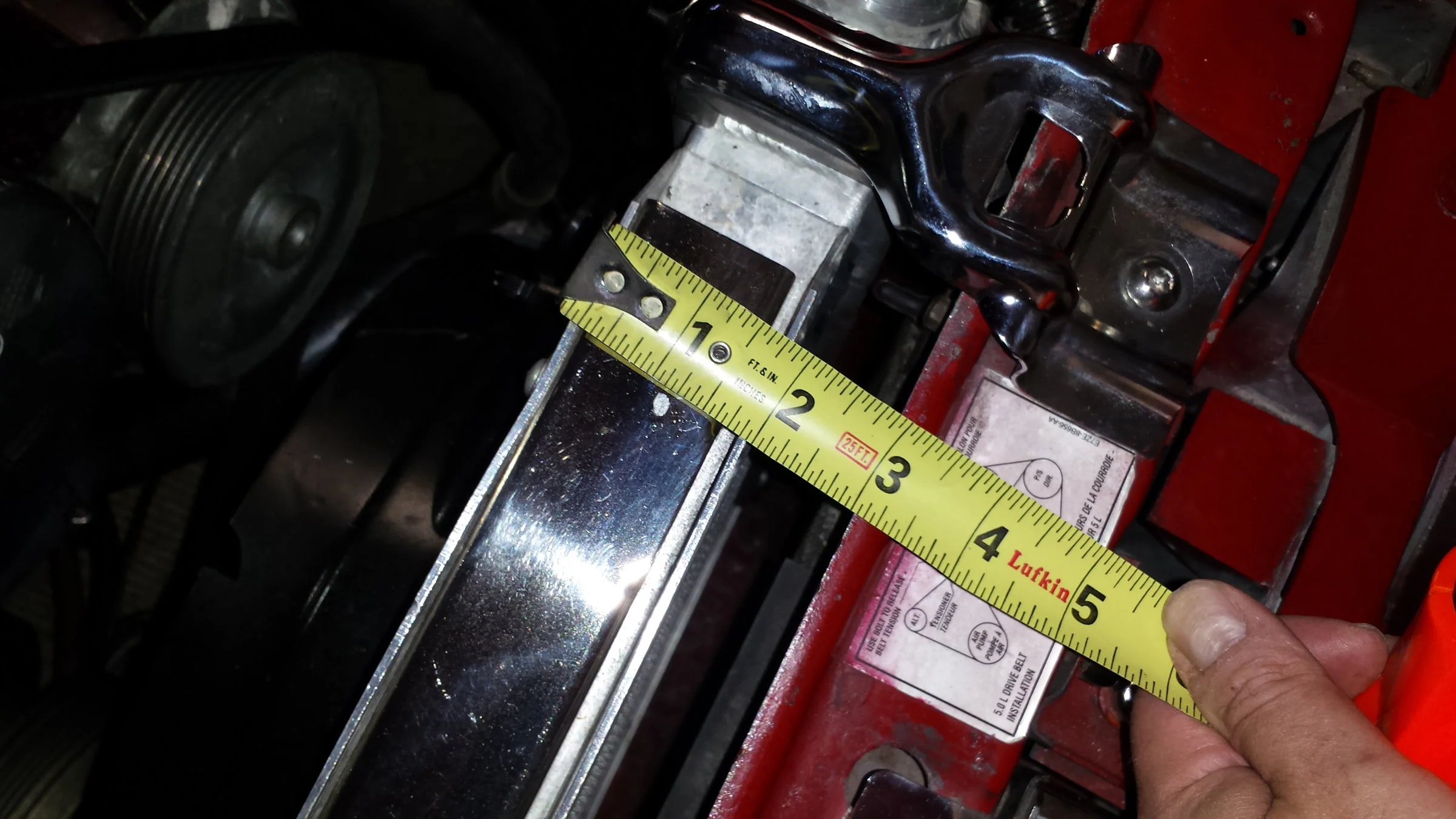

  • Dont want to start throwing parts at it- radiator is less than 2:" wide- may not be large enough with power adder

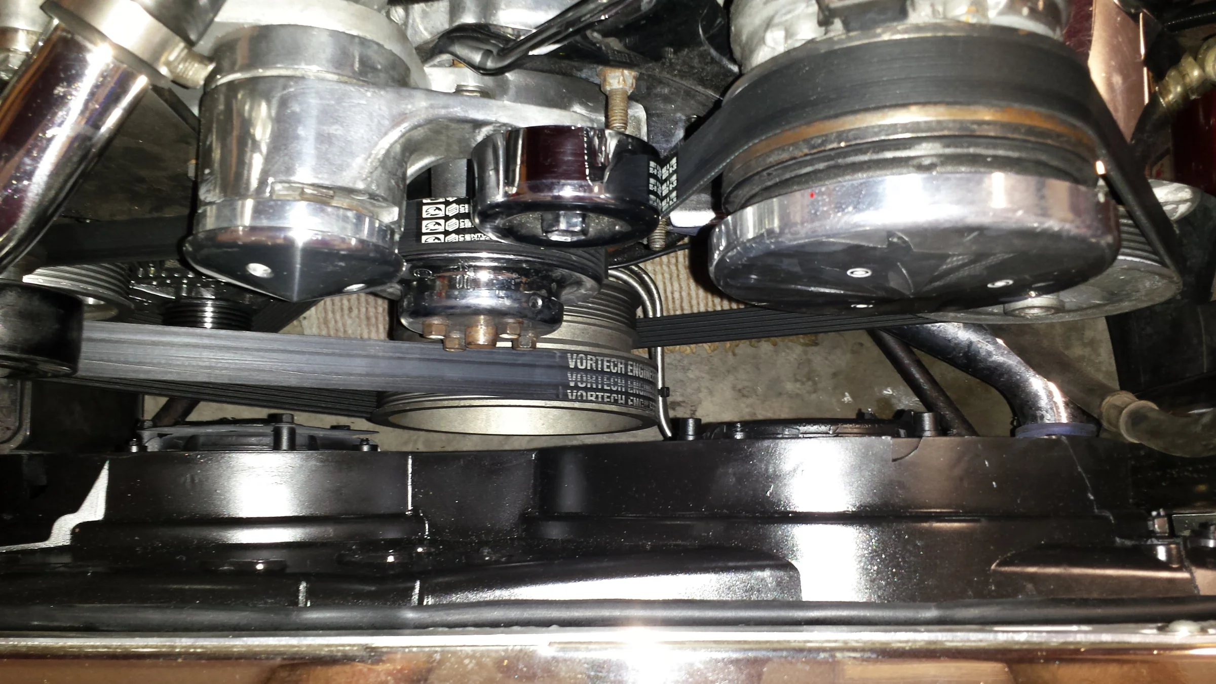

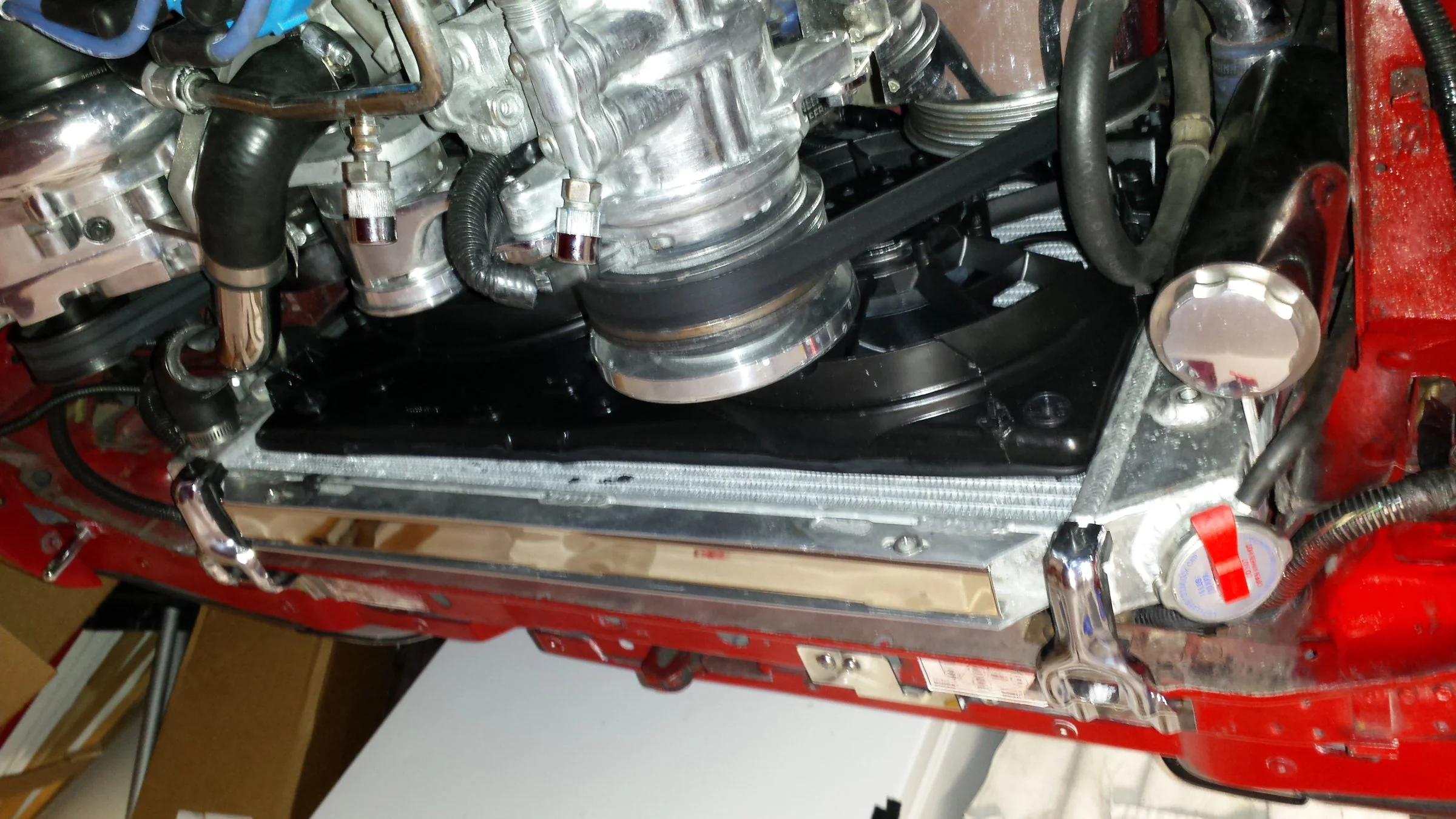

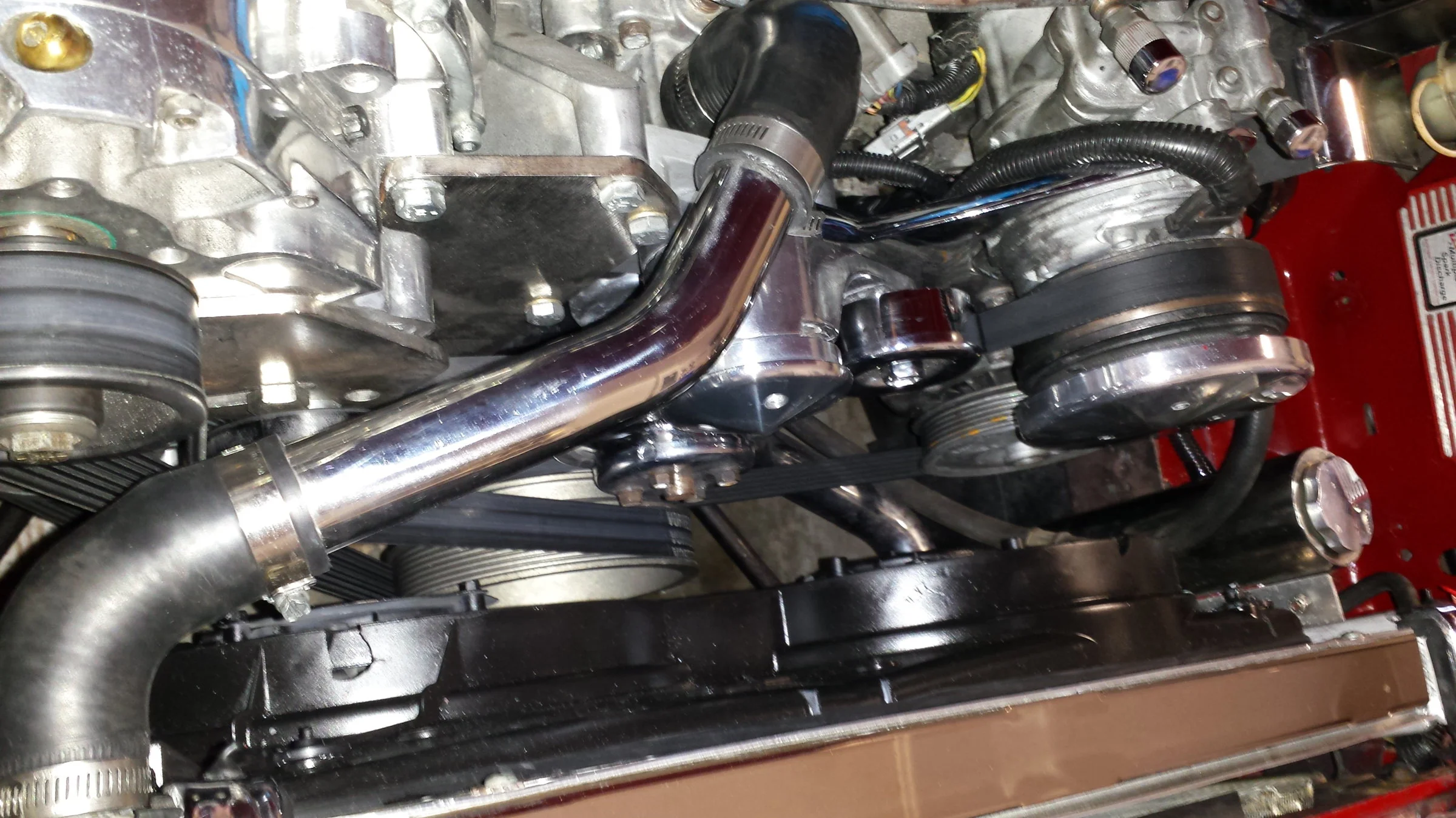

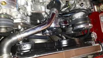

Pics of install and fan replacd

Your 2" radiator should be plenty I would think. My current simple/cheap SVE rad is 2" and works fine. It's matted up to a Flex-a-lite Black magic extreme 185. The Damn fan kit was nearly $400 bucks but moves 3300 CFM and my vert keeps the stock temp guage in the middle or even lower most of the time.

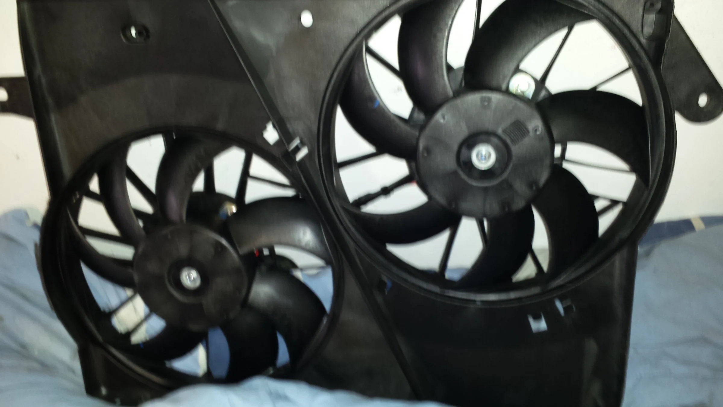

so after dicking around with the fan today, it jut didnt seem to be pulling enough air.. take it out- lay it side by side the dodge fan and turn on each one - the Dodge 300 fan blows this fan away. The Cougar/Contour is a 2 spd fan but I wired 12v straight to the fan, not the resister so it was on high.
Long story short, after a few hours of removing the Cougar/Contour fan, transferring the connectors, rewiing the Dodge 300 fan, reinstalling the Dodge 300 fan, burping the system, I started it up. car idled 10 degrees cooler 170. Took it for a drive, car is 180 and got as high as 195 when I got on it.
Seems for whatever reason the Cougar/Contour fan was not moving enough air, leading to the car running hot. Two days of getting back to square one but at least no blown HG or serious problem.
