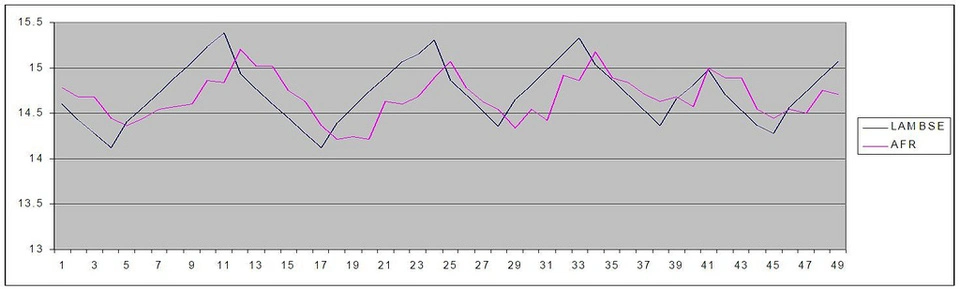

Here's a snippet of a datalog from today at steady cruise and a graph. Please ignore the blank parameters in the log, we are working on some new datalogging features for BE. :)
This is off an Innovate LC1 sensor in my car. The sensor has about 4,000 miles on it since calibration.
14.72632653 AVERAGE LAMBSE
14.68015694 AVERAGE AFR
Source Datalog: http://www.72mach1.com/research/AFRvsLAMBSE.xls
Hope this helps,
Wes

Brett, I'd try to verify with a second wideband just to be sure - sensors tend to get lazy and drift as they age before they go out. I keep a couple on hand for that very reason.
Also, did you get that graph from #s out of Innovate software or out of your twEECer datalog?
Wes
