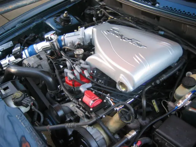

I just did this last week...you will probably need a fuel pump, 24 lb inj, maf, 70 mm b(no absolute nessec), intake adapter elbow....3/8 spacer, and you will have to modify or delete your egr because the tube will not reach. you need the spacer because the egr will hit the valve covers if the upper intake is not raised.
:nice:
