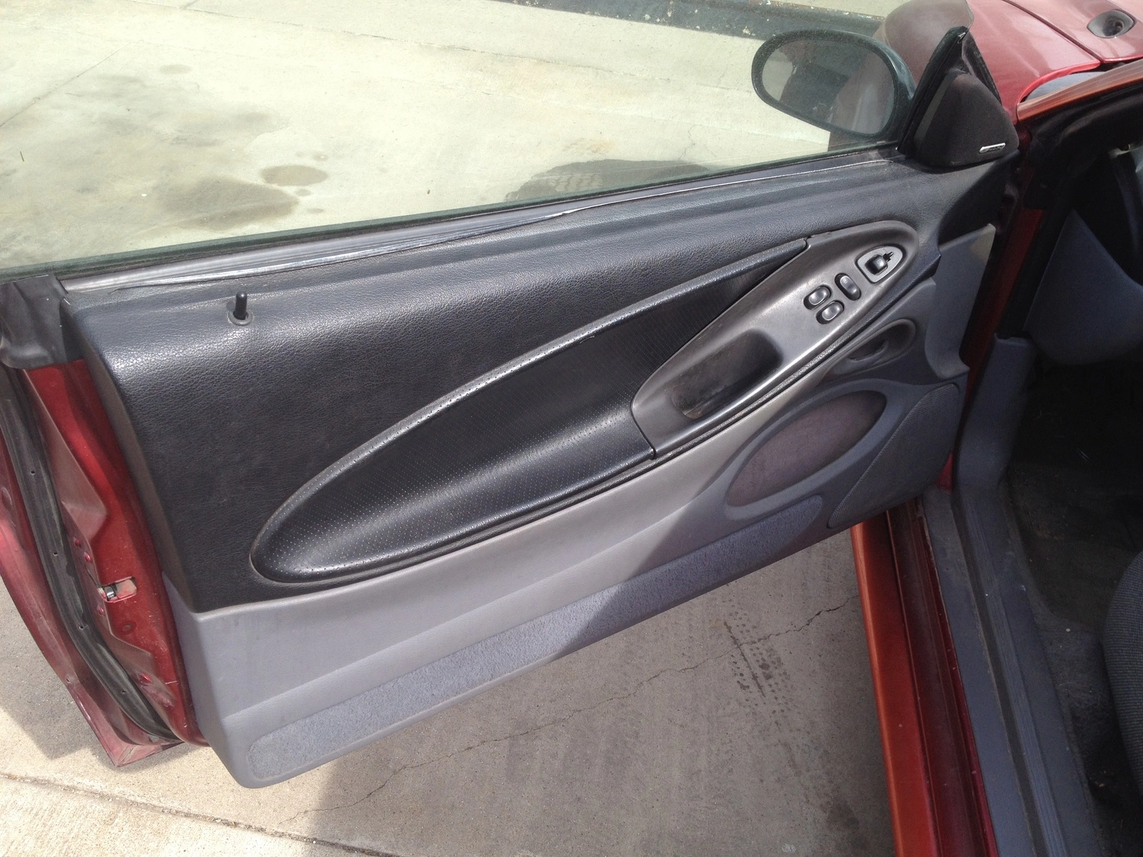

You can see the door panel has begun to peel and what you can't see is that only two hooks holding the door panel are still intact, the lower portion of the door panel flaps.

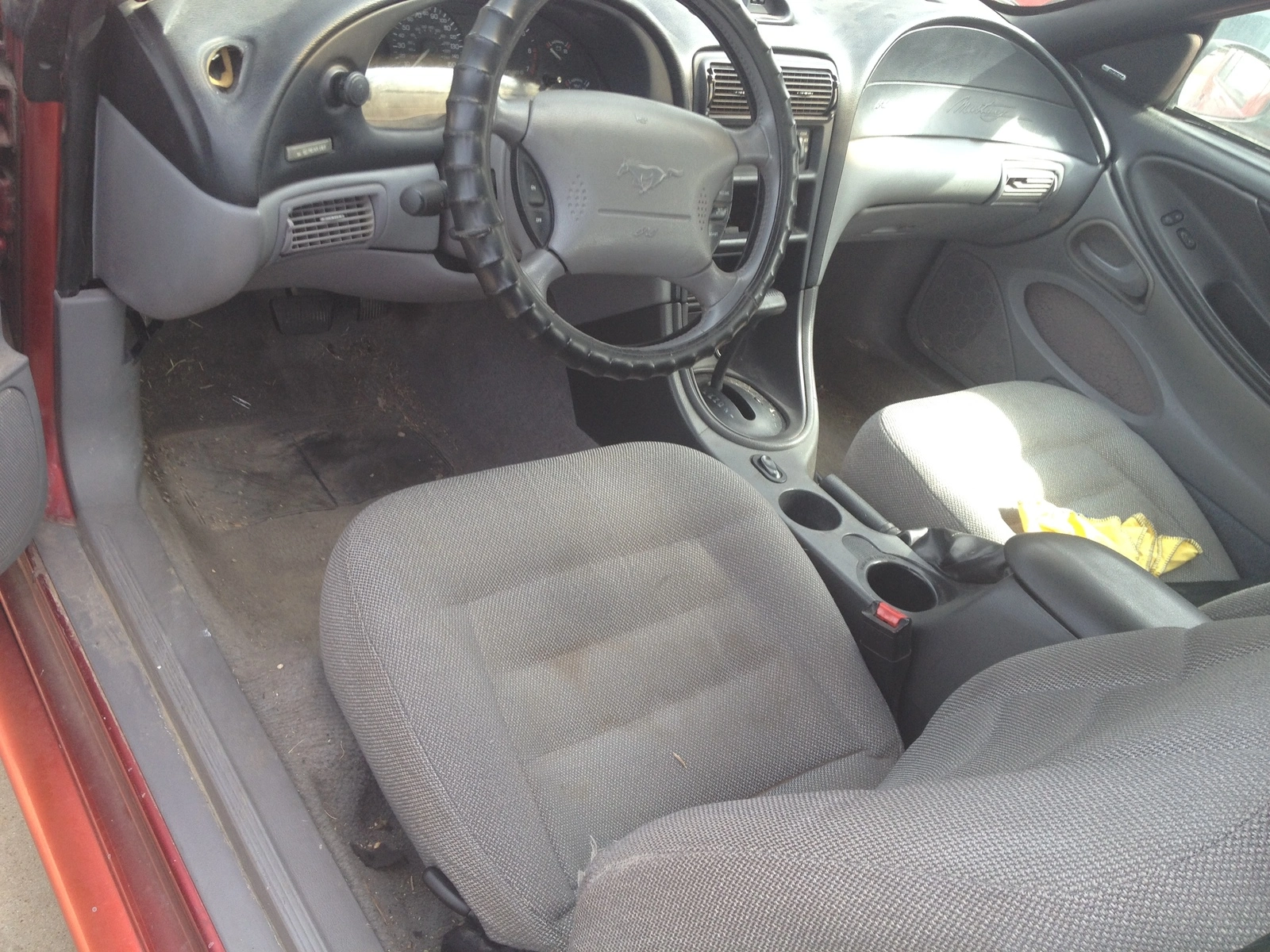

This shows the missing trim, messed up passenger vent, holes in the driver seat, worn carpet, and the mixmatched color scheme since I wanted cup holders. Not to mention, again, that the door panels, stereo bezel, passenger air bag cover, and shifter bezel all rattle; along with something in the rear deck that sounds awful. Another added benefi of the interior swap is the ability to replace and properly secure everything with replacement screws from the yard.

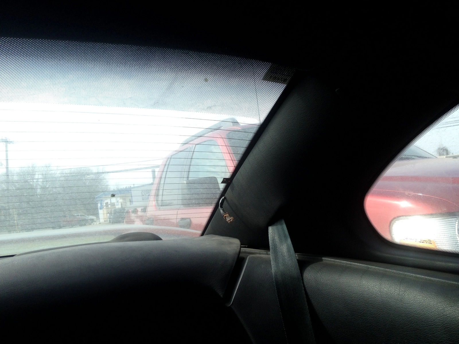

Does anyone know how I can go about reattaching my rear defrost though? It still works, just...ripped off somehow?

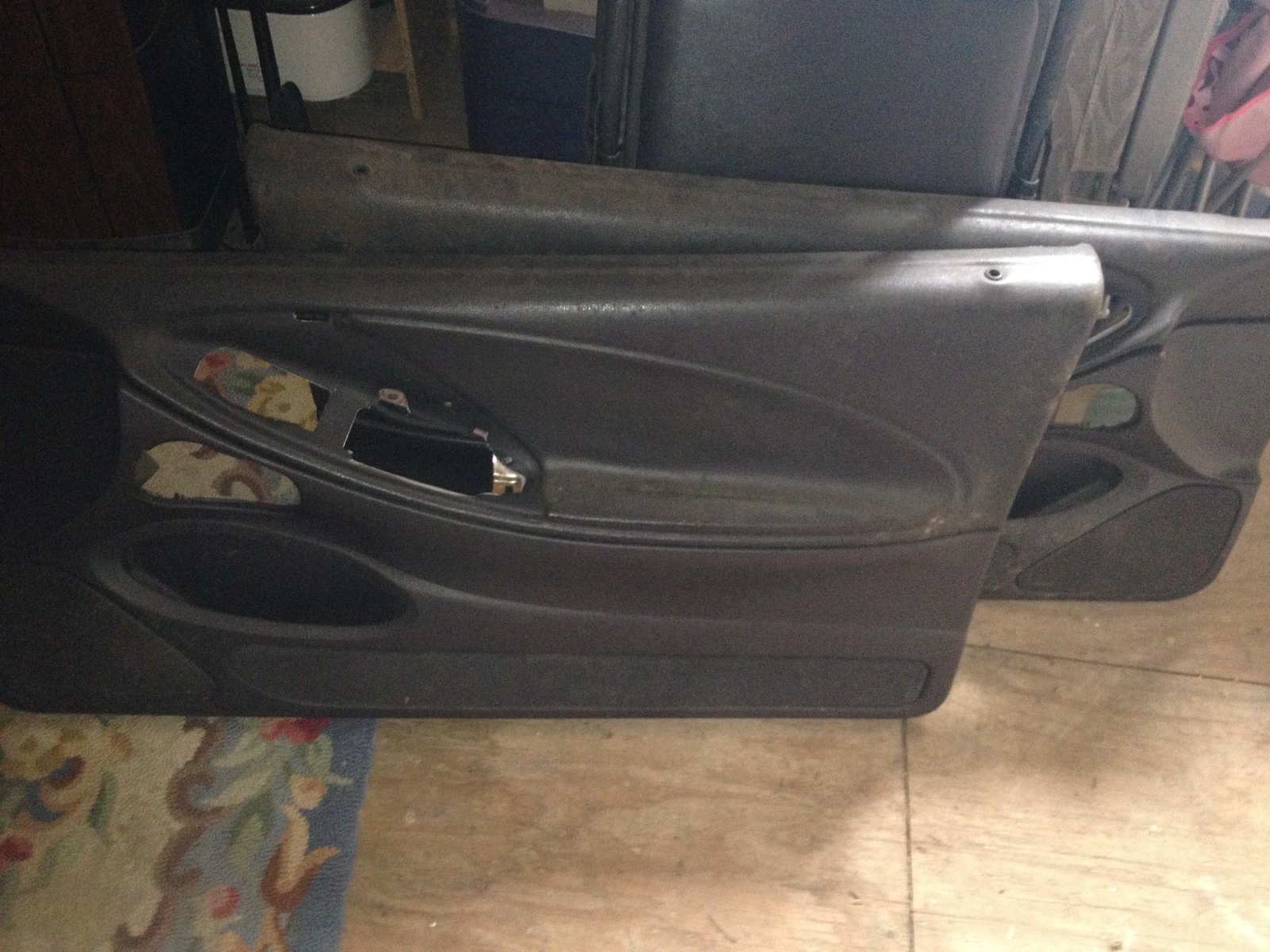

Door panels! One door panel has a partially broken hook that I need to fix and both door panels are lifting a little bit where the arm rest is so I'll need to find some adhesive to secure it down. The foam inserts on the back side are new and hopefully cut down on some road noise.

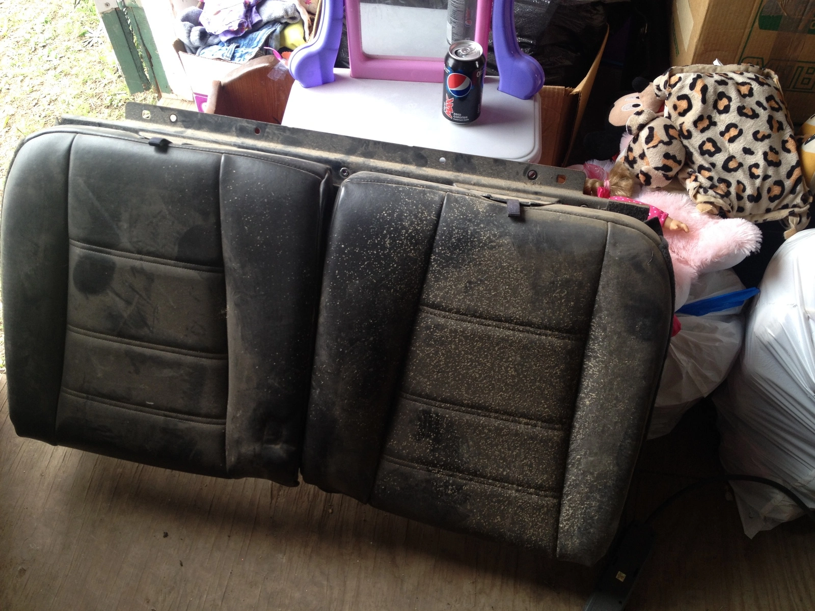

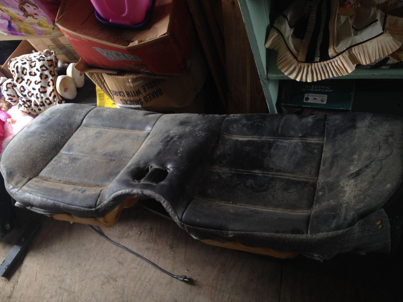

I found these black leather rear seats! Excellent condition, just very dirty. I'm also getting the passenger leather seat in good condition, and the driver seat. However the driver seat is cut up in a lot of places so I haven't decided on the route to repair that seat yet. Should I recover the seat with a new skin? New foam padding? I might do a seat cover for a little while, but either way, it's an upgrade from my tweed seats. Another added bonus would be the replacement of the seat motor which is going out in my car.

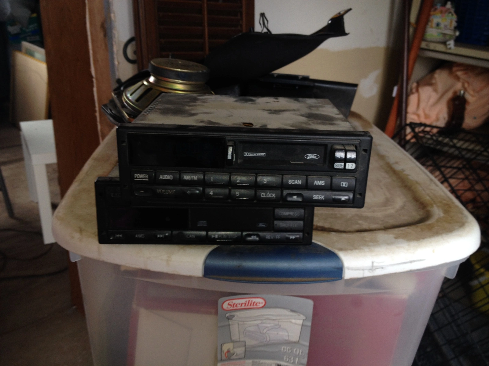

I also was fortunate enough to find the dual deck original factory stereo intact. I had pulled my aftermarket headunit and put it into my daily driver integra so the car has been radioless. Eventually I plan to do a full stereo system with new speakers, wires, double din headunit, and tweeters but that's a project for another day.
